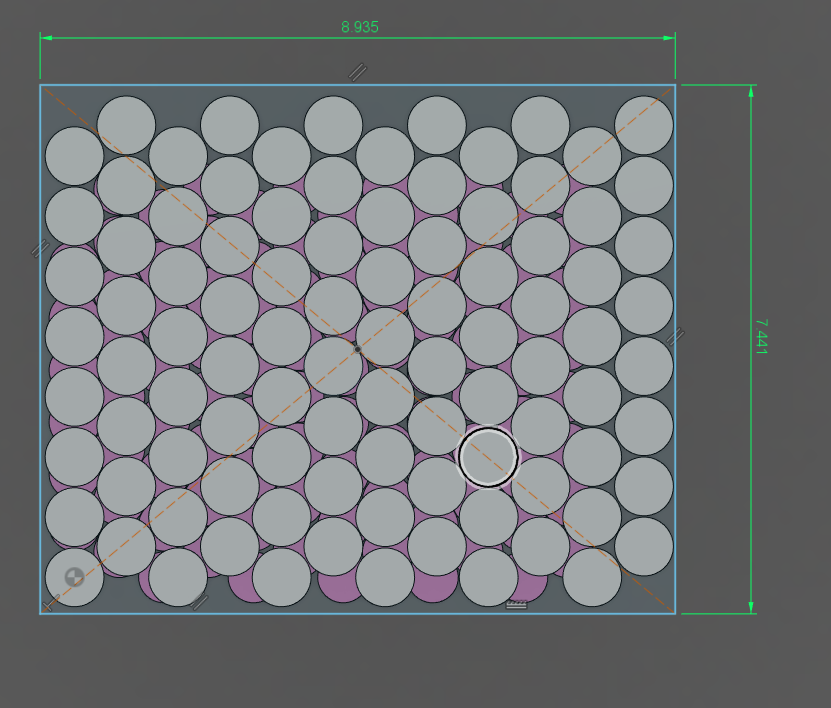

You know, i didnt even think about 3d printed design…I mean, it’s a box! -has to be one of the easier things to print. I’m leaning towards 12s7p 21700, so maybe the peli 1200 wouldnt work with that - i think it would work with 12s6p, but not 7p…plus a 3d printed box would be cooler as i could have neat little flourishes on the side. Is there a design you’ll be using, or are you designing it yourself?
I’m pretty sure it would. One second.

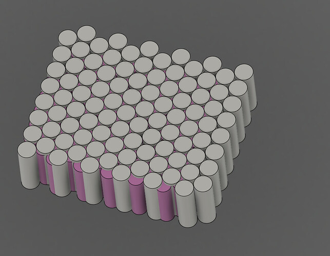

I’m working on/finishing the design as we speak haha I ran out of filament but I will be printing mine soon. This is for a 12s8p of either 18650 or 21700
sounds cool! would love to see it when its done. what filament are you using?
This is a 12s8p. Pink is 30q, white is p42a.
For filament I’m planning to do the lid and base out of PLA+ and the walls out of Nylon. The print area is so large you need to use something that sticks well otherwise warping is imminent

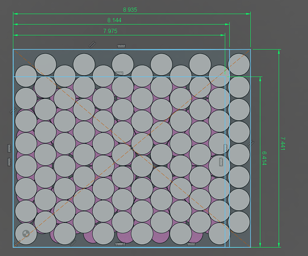

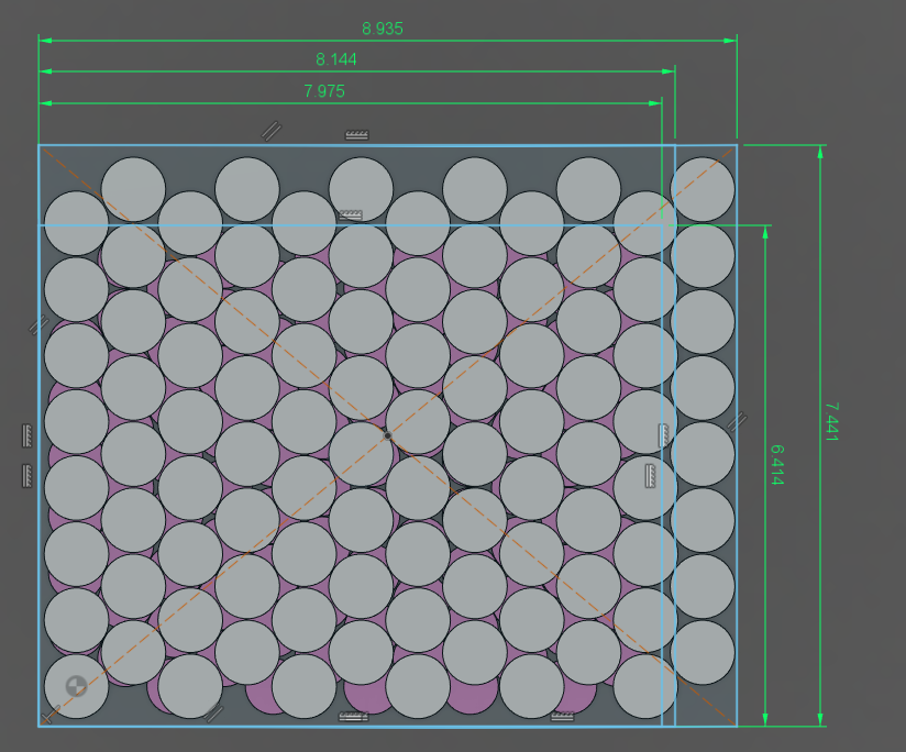

Here you can see 7p outlined and the 18650 8p outlined

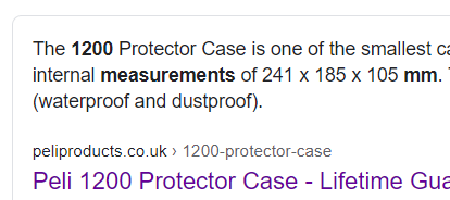

Just looked at the Peli 1200 dimensions, looks like 21700 wouldn’t work though with 7 or 8p
Peli 1200 = 9.48 x 7.28 x 4.13 (in inches)
(image )
One of the axis is too small. I guess this just means it’ll have to be 30q. Not a bad thing
thanks for the diagram though, v useful … just realised you mocked this up yurself! Extra thanks!
