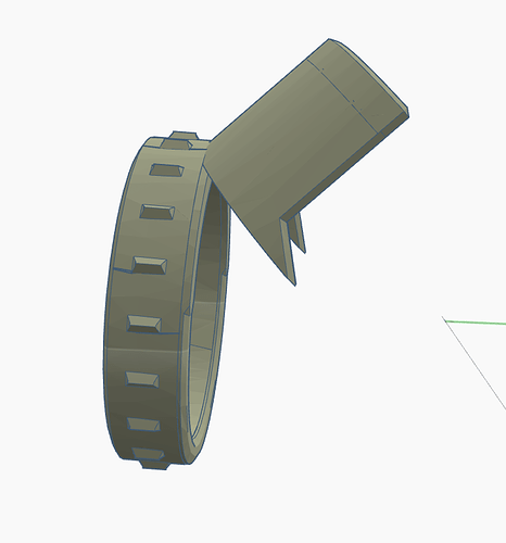

Guys, i need ideas on how to solve this.
I’m printing this flashlight cover to not blind others but i want to slice it up so i can flip up the cover to have the full beam again. No idea how to build a hinge on that. The diameter of the ring is 46mm so it would have to be quite small so it’s no that bulky overall.
stock:
this would be a full tilt back
if a 180 is not possible maybe just a bit
