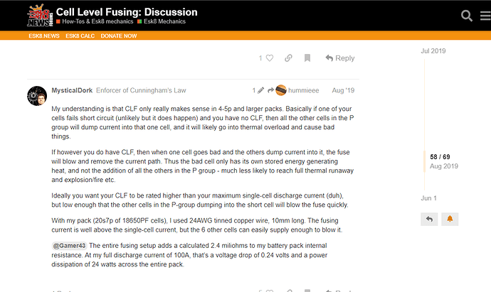

regarding P section this is not white paper it was just some discussion about CLF
so this question:: “is more cells in P vs less cells in P higher risk for TR” remains open and any feedback welcome

i was considering situation when a single cell is failing/short regardless the cause
and trying to figure out would it be safer to have 3 times 12s2p vs 12s6p pack
without implementing other measure such as CLF for example
12s2p vs 12s6p is just example this could apply to 5 times 12s2p vs 12s10p
i may exaggerate but you should get my point :slight_smile:
We need to define the situation in a lot more detail. Cells won’t fail on their own with a hard enough short circuit to draw enough current to force other cells into runaway IMO.
Forcing a cell into runaway by penetrating the cell with a nail creates an “artificial” short circuit that provides a continuing short circuit to help drain the other cells quickly. This would indeed help other cells go into runaway. Not always do so, just make it easier.
Having more cells in parallel allows for better heat transfer to other cells over the interconnect material but also means that any short-circuit current and cell heating gets divided too. I don’t think we can generalize and say that a bigger p-group aways = increased risk of additional cells going into runaway. Especially when we won’t have this forced short-circuit situation (nail penetration).
Any conclusions we might reach would have to be for the particular situation that we used for testing this. Having said this, here’s a paper that supports the more cell = bad idea…for artificially short-circuited cells, that is: https://www.osti.gov/servlets/purl/1235277
IMO, you’re going to have to do some testing to get the answers you want for the particular setup you’re interested in…CAREFUL testing. :slightly_smiling_face:
