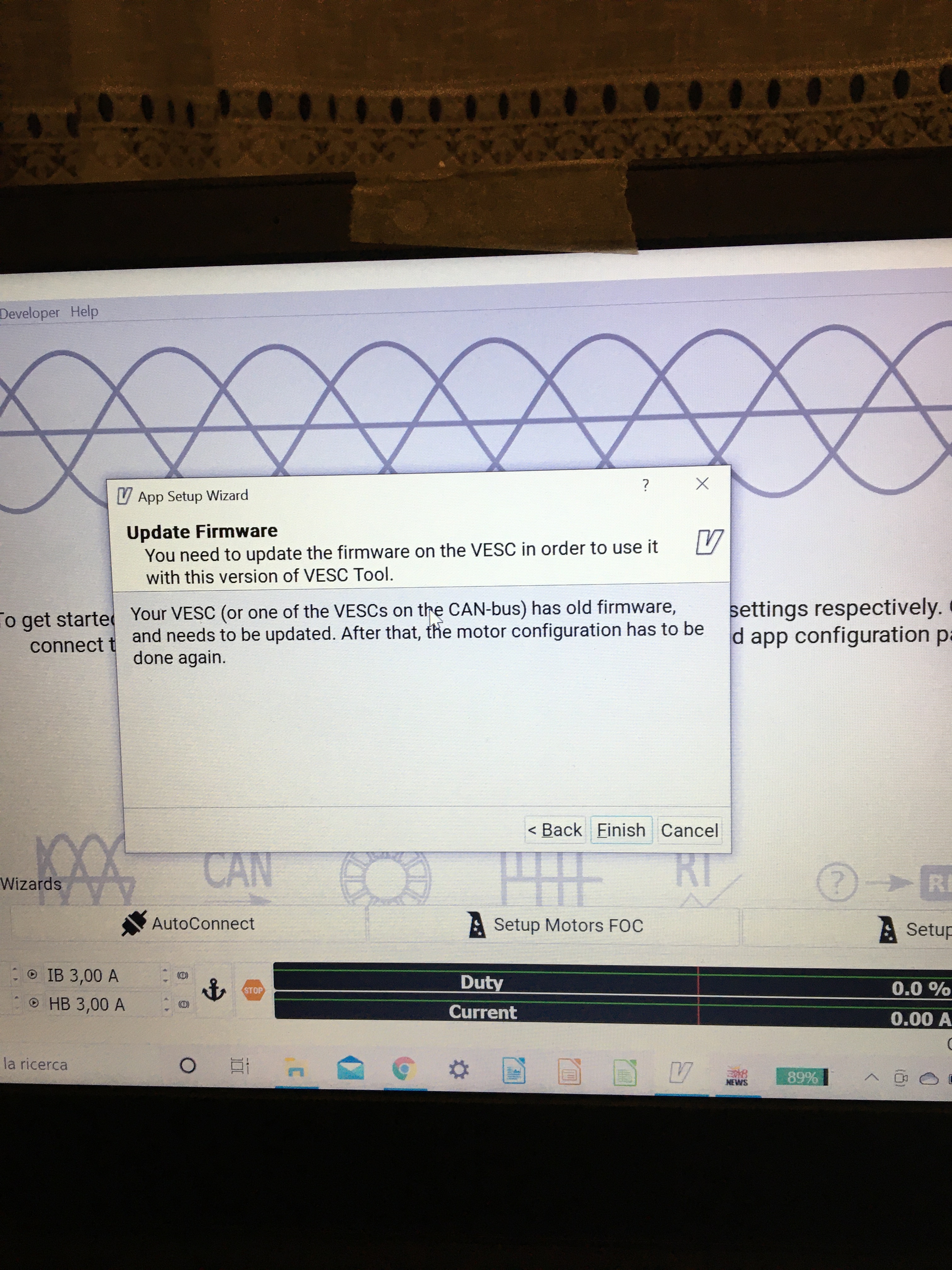

I just set up my escs with the Vesc tool, everything works but I have a bunch of questions:
-I updated the firmware on both Escs but when I went on the “Setup Input” this flagged on my screen (see picture), so I closed it, re-opened it and that advice didn’t appear any more… is this normal?

This is fixed by simply standing on it. On the bench with little or no load, this is how it behaves.
Update the firmware on all VESCs. (not just the master)
Yup. Missed this. And do it separately, not through CAN.

@b264 I swear I updated the firmware on both escs singularly more than once before that flag
Do you recall what your vesc settings were?
This has happened to me many times. FW is proper on both, but the tool still gets confused. Closing and re-opening the tool fixes the confusion.
I also found that leaving Bluetooth and your (uart, if you have it) remote unplugged during setup gets rid of that error for some reason; I lost my mind after trying to re-upload firmware like 5 times through can and individually. Maybe my situation was just an edge case, but maybe that’ll help
