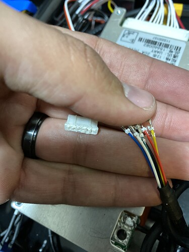

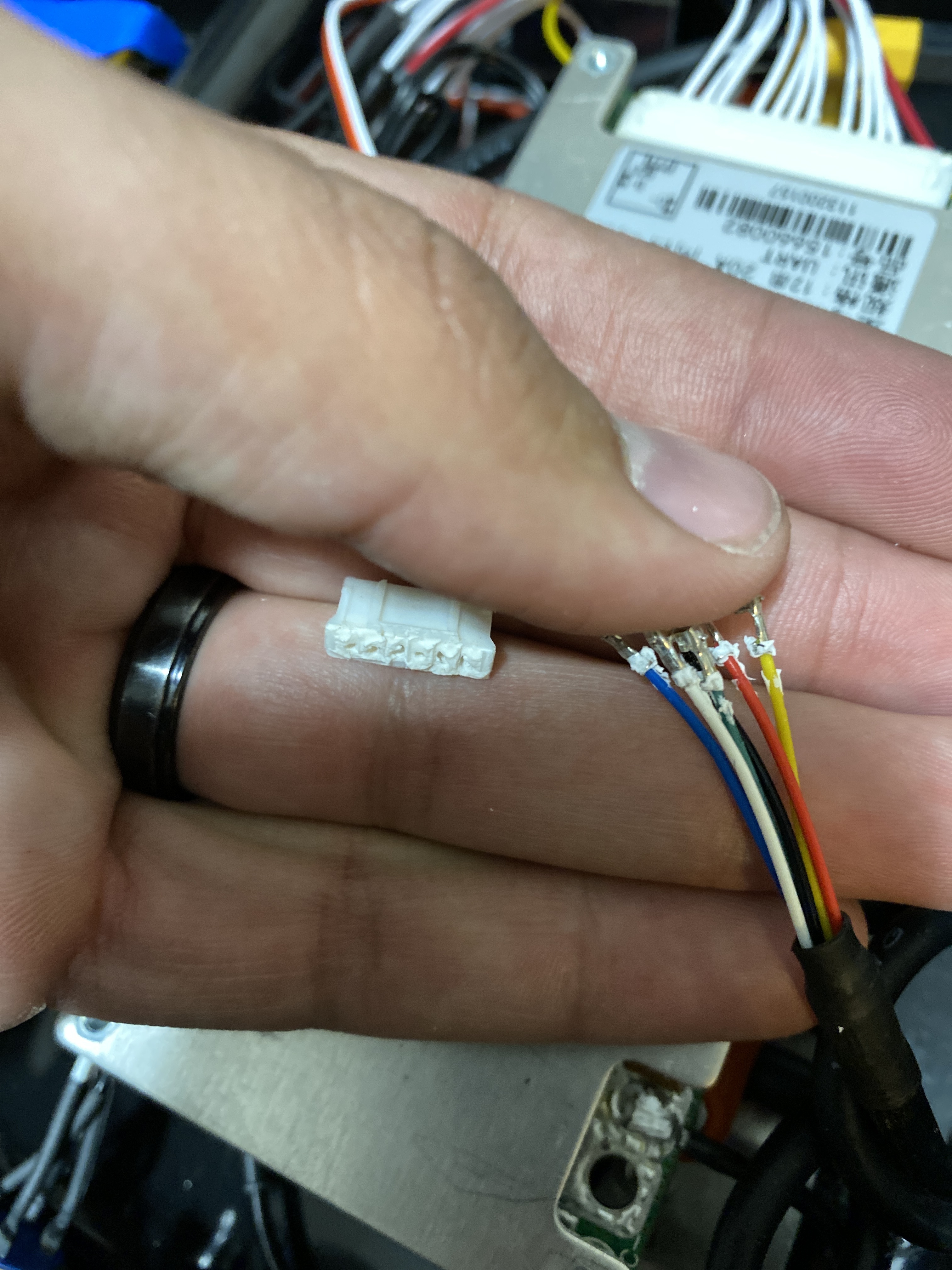

What is the hall sensor placement for a unity? I need to put a JST on but not sure of the order for some 6374 motors.
Or more so what the colors mean. I’m guessing red is the 5v?
Red is 5v, black is ground, white is temp, the other 3 are hall. Doesnt matter the order on those.
