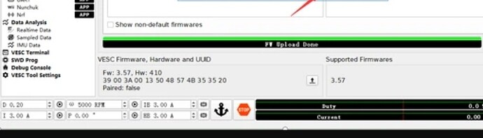

re download the latest vesc tool should solve this
what esc btw?
Are you coming from Ackmaniac?
unity
i downloaded the free one from this page - https://vesc-project.com/vesc_tool
shouldnt that be the latest version?
im not, was coming from this vid and this vid
I mean if your vesc currently has the ackmaniac firmware flashed.
ive no idea. how can i tell?
On the firmware tab, what firmware does the vesc tool state you have? 3.103 is ackmaniac.
(Where you flash your vesc)
Picture as an example*
If you have stock unity firmware. It’s 23.46. vesc tool sees that as too new.
Use focbox ui. Or force install VESC/bldc 5.1 on it.
23.39 then
@fessyfoo good catch…i should’ve asked what vesc first :sweat_smile:
OK @fessyfoo so i should use the focbox UI to update the UNity firmware, is that right? What do i update it to?
Focbox ui - 23.46. (Last one)
Or VESC tool.- 5.1.
There’s a choice there idk how to advise on. I’ve been on 23.46. Waiting in 5.2 Wanting less new in my world.
