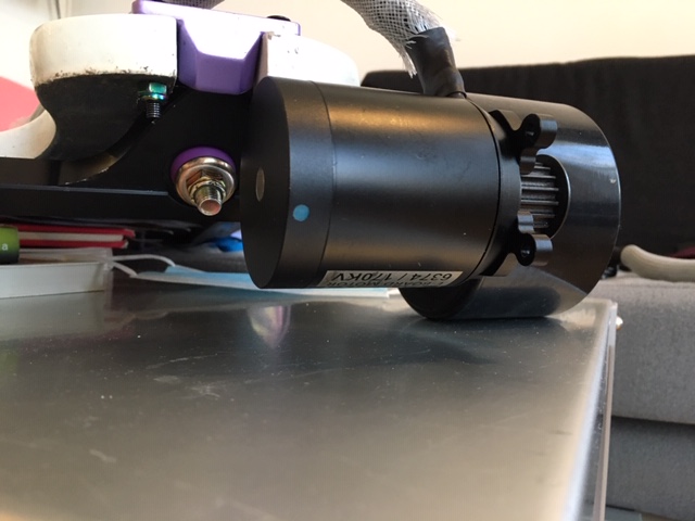

is 2.5cm acceptable for motor/ground clearance? (on a drop-through hummie)
IMG_0011 IMG_0012 IMG_0013 IMG_0014 IMG_0015
I think that’s more than I have on my DD board, but it’s probably not ideal when hanging over the back.
ok, phew! btw, im thinking these mounts wont do for bergs - too short, but what do you think? (they;re the dicky-ho ones from nexus)
that’s more than any of my board :rofl: unless u want to keep those motor with near brand new motor can surface or else i’ve gone as low as 10mm
haha, ok, wicked, glad im on the right path :+1:
