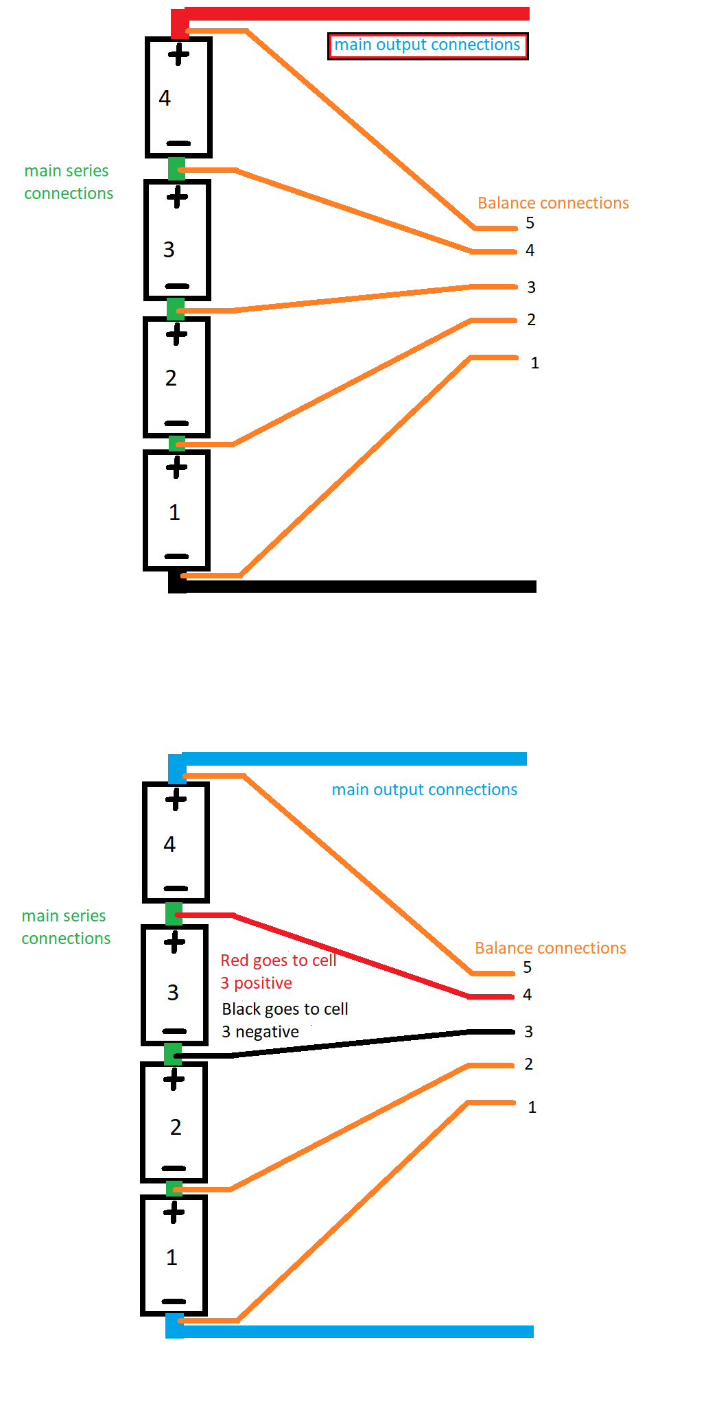

can someone help me understand how to isolate a p group for charging via the balance plug or at the cells(nickel strips, etc). if they are connected in series how does that work?
Literally just plug the charger’s two wires into the two spots in the balance port that correspond to the p-group in question. That’s all.

Find the two wires you need, and plug the two charger leads into them. Set the charger to 1s mode, and begin charging.
so if i’m charging p group number 3 i would plug into 3 and 4 correct?
Yep. Check them with a multimeter to make sure the voltage is what you expect (you’re charging the low cell, so make sure the voltage you see matches that of the low cell)
ok, got it. I know what to do now and it’s working… but I need to understand why it works. I’ve read a lot of documentation but I don’t see anything that explains why this is working. each balance wire is going to the positive of each p group how is this working? :thinking:
The positive of one cell, and the negative of another cell.
Because the cells are in series, AKA the positive of the first cell is connected to the negative of the next, human-centipede style.
The numbering scheme is arbitrary. It could start at the positive side, or the negative. Doesn’t matter, as long as you can keep it straight in your head. (and of course make sure it matches the BMS lol)

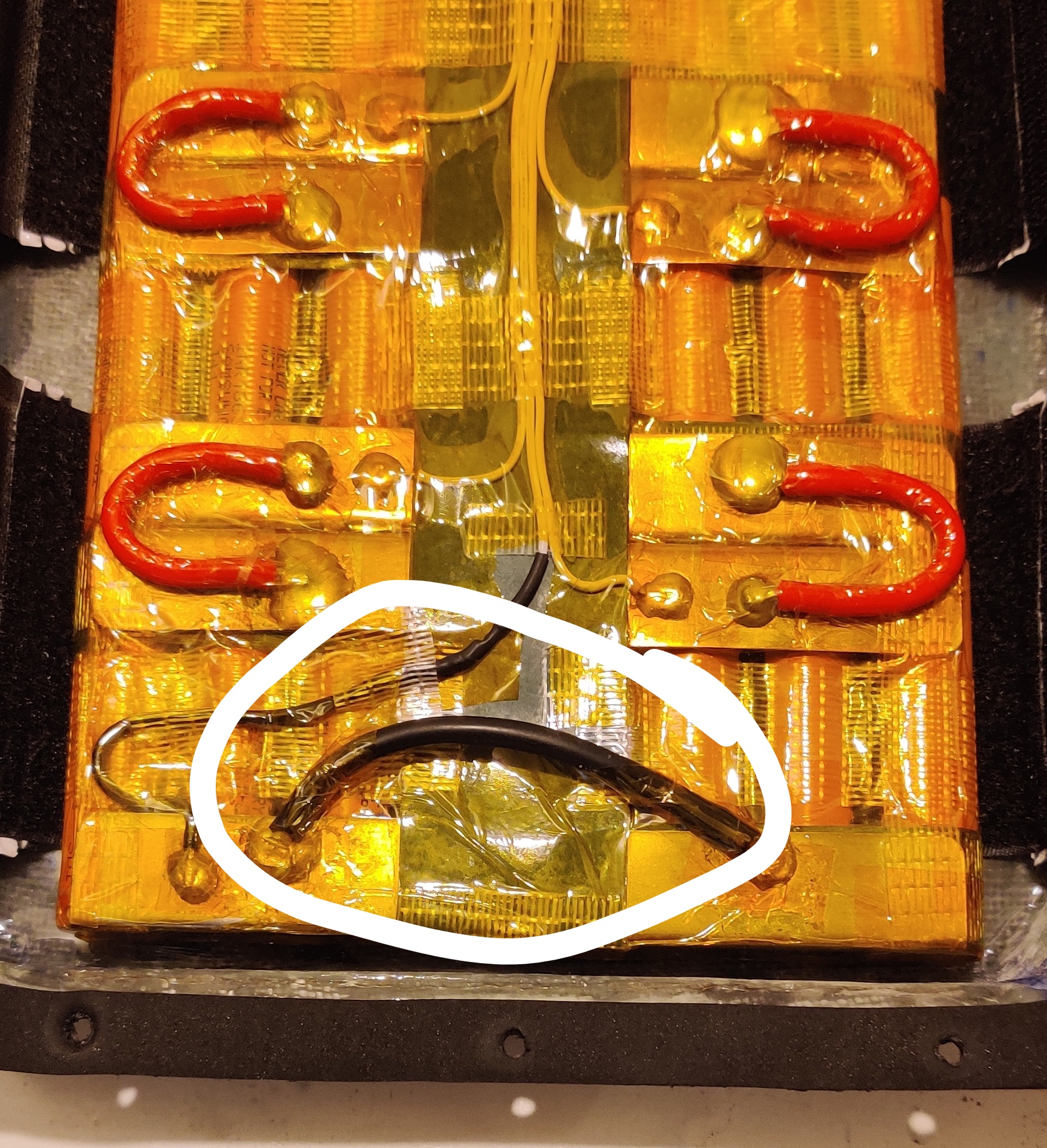

I picked up some of the TB velcro straps for battery packs (without having first considered it when making my Enclosure). I was wondering if it would be an issue if the velcro straps closed the distance between my deck and battery? Now when I mount my Enclosure with my battery in, I have to push down an bit where the pack is. Could this be dangerous for the pack?
The section of the pack where I need to push down in order for it to fit is right around here at the black wire:
Looks fine to me. It’s all kapton-ed up and a bit of pressure on the wire in that position won’t do any harm.
Yeah I agree for the most part.
Might be worth slipping a little piece of fishpaper under there just in case, but it should be fine without.
