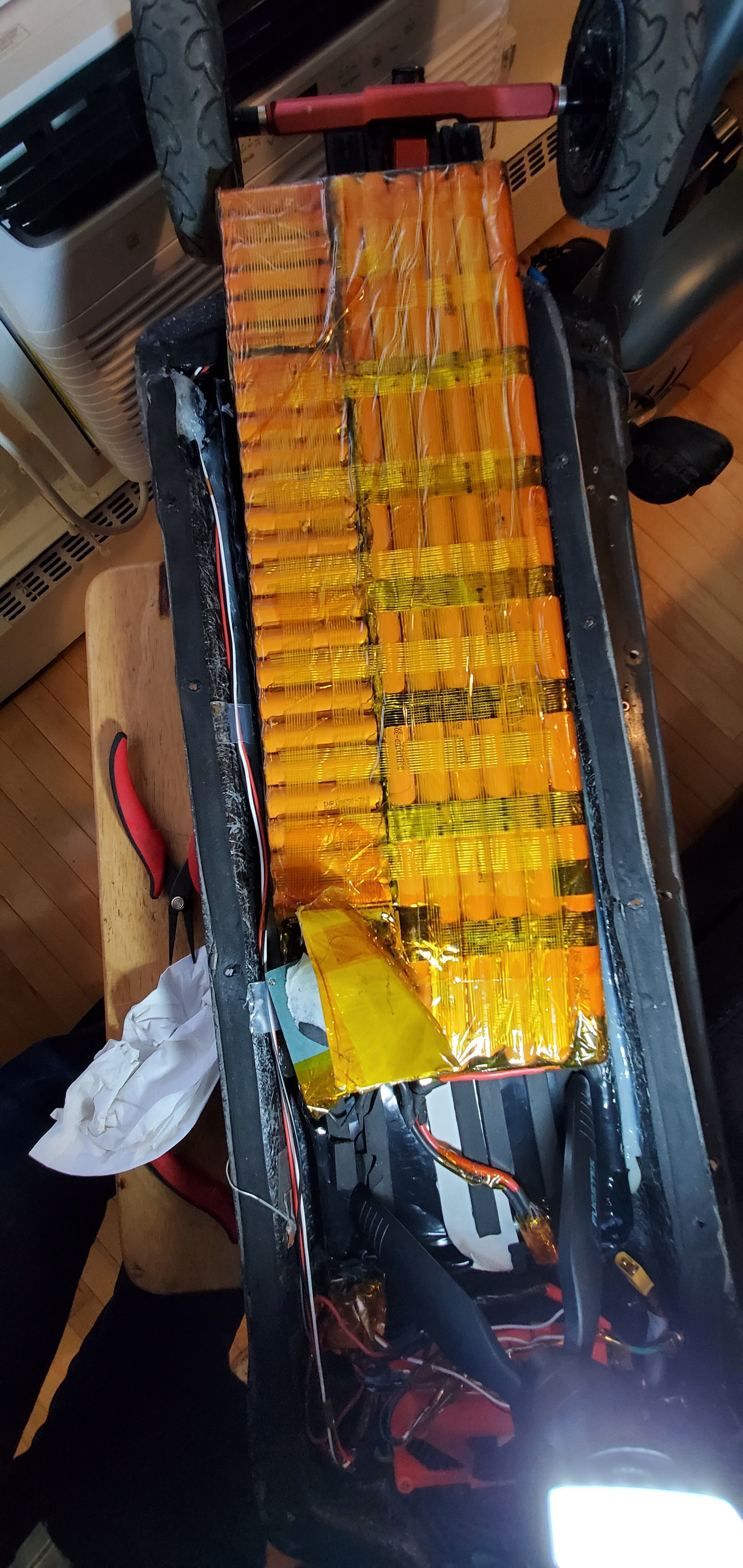

My battery will only charge to 47.46. So I took it aprt and measured from the balance plug
  1. 4.09
  2. 8.17
  3. 11.74 :thinking:
  4. 15.70
  5. 19.80
  6. 23.67
  7. 27.77
  8. 31.87
  9. 35.67
  10. 39.76
  11. 43.37
  12. 47.46
    is this a balance problem or something more?
    Visually the pack looks good.

Well, it is definitely far out of balance.
Fix that, then see if anything else pops up.
Thx, any ideas how to do this with a Imax b6 charger…it’s the only balance charger I have.
Set it for 1S and connect only that P-pack
I’d charge it slow at like 1A or less. It’s at 3.5V so you’re okay but if it was down into the twos like 2.5V then I’d start at like 50mA charge LOL
should I charge it (number 3) to 4.09V?
I would
Once you get it all balanced and charged, when you begin to discharge it again, stop and measure them again. If p-pack 3 is draining faster than the other ones, then you’ll have to snip it out and make it 11S battery
any suggestions as to how to connect only that P group for charging. Would this work charging from the balance plug.
I use those alligator clip things
And that harness, yes

that is how I do it with two jst pins
Yes, that should work.
Just go through and get every group to the same voltage. Could be full charge (4.2 volts), or storage charge (3.6/3.7 volts), doesn’t matter, as long as they’re all the same.
