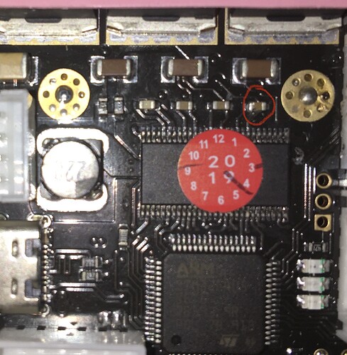

Could this cipped piece be an issue? Or “if it works its fine”
Yes, it could. But it also might just be fine.
If it were a PCB I was building myself and I had the correct cap on hand to replace it with, I would definitely do so. But if I didn’t hade the part on hand, I don’t know if I’d be motivated enough to look up the schematic, find the right part, order it, and then replace it. I’d probably YOLO that shit.
