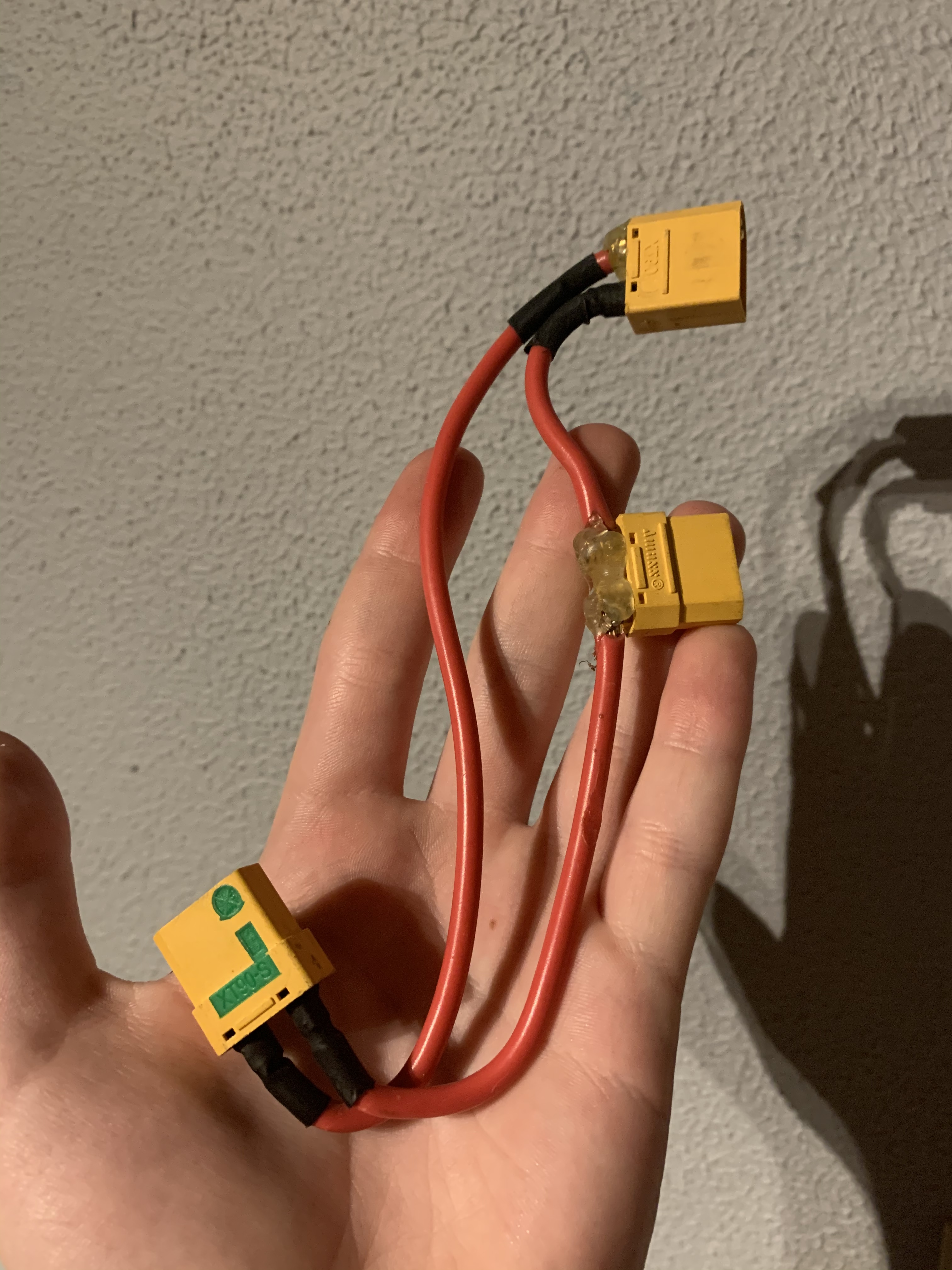

Hey guys, I’m starting a new build with a 12s4p battery and two tb6 vescs. They don’t happen to have a build in switch do they? I think I’m gonna have to buy a external anti spark switch
No, they do not. Not many ESCs do.
Unless you have a good reason not to, I’d suggest you go with the simplest (and cheapest, and most robust) solution: An XT-90S loop key.
Nope, make a loopkey if you wanna save some money. I’m not sure what reliable antisparks are out there atm. I’ve been out of the game for awhile. I’ve also seen my fair share of antisparks causing accidents mid ride. But I’m taking a chance on a fatboy antispark atm. We’ll see how that turns out.
Easiest, most reliable, cheapest. Only downside is they are ugly, but even that can be mitigated.
I’ve got this old one I made, but it still sparks when I plug it in. Don’t worry about hurting my feelings, criticize it all you want! Yea that’s hot glue
It sparks because you’re using an xt90 instead of an xt90s. The one with green on it is an xt90s.
This is almost always caused by this
What @RedBaron said. You’re using a regular XT90 connector where you should be using an XT90-S (the green one), and using an XT90-S where you should be using a regular one. (Assuming you had your battery plugged into the bottom one, your ESC in the top, and were using the middle one for your loop key)
And you’ve also got the genders wrong. The green XT90-S female (bottom on in that photo) should be the removable “key” part, not mounted in your board. That way, if the resistor in it (the part that makes it “antispark”) ever gives out, you can just replace the key, rather than tearing into your board’s wiring.
Ah I see thank you guys!
