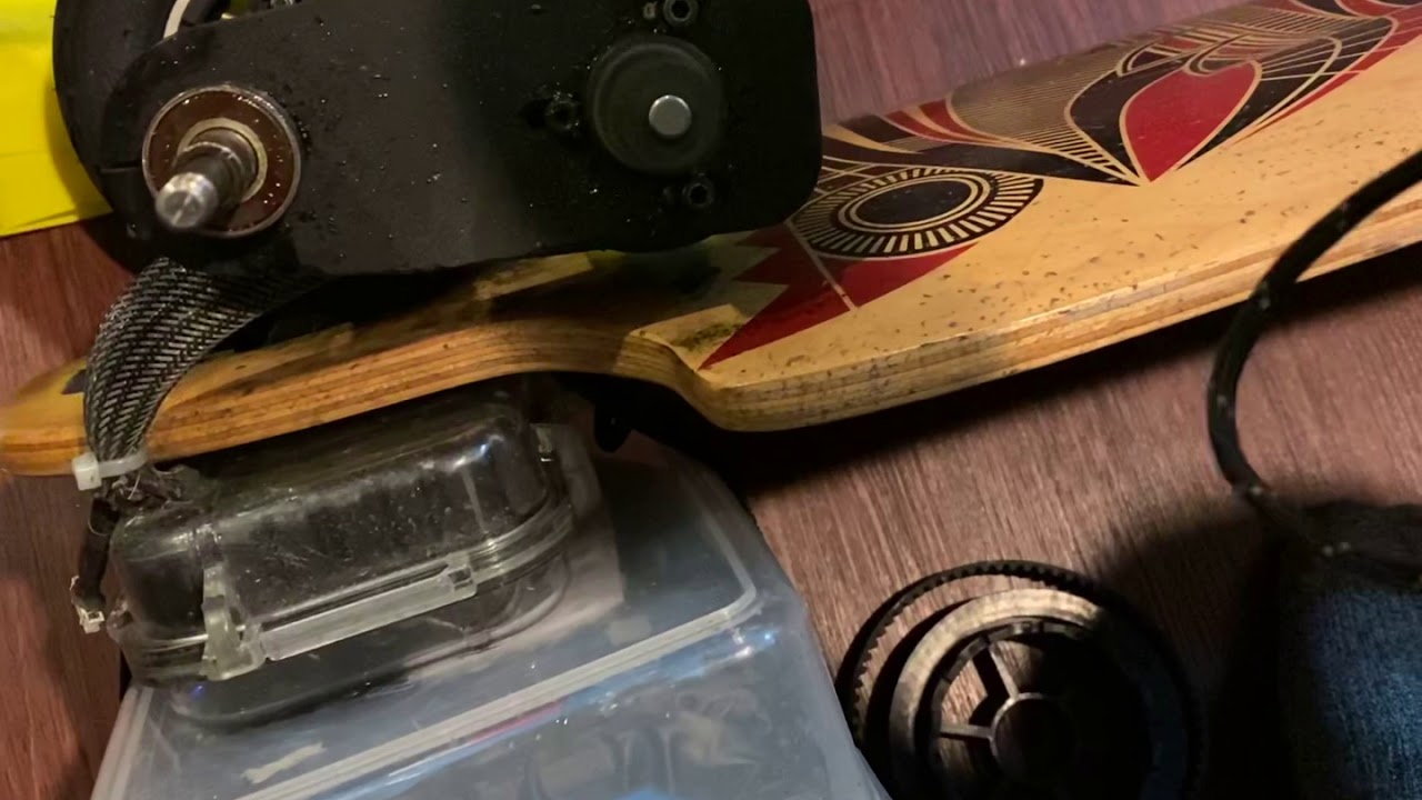

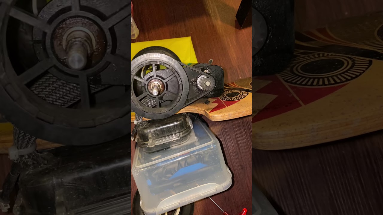

Weird noises
Da da da
Without belt seems normal
The belt sounds too tight in the first video, also check that there is not a stone or something stuck in the pulleys

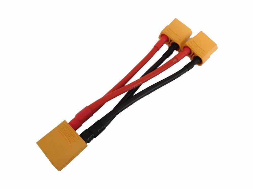

my battery has one xt90 output, but ive got 2 maker-x esc’s … how do i connect them both to the battery? is there like a splitter or something?
Yes. You need to make a parallel splitter.
thanks…i guess this is what i need to do? looks pretty ghetto lol
ah looks different to what i found
I mean you can do it however you want as long as they’re connected in parallel. That is, the two positive go to the same connector side and the two negative go to the same connector side, like in @M.Hboards pic
i guess if there’s no difference, ill go with the one in video. thanks
