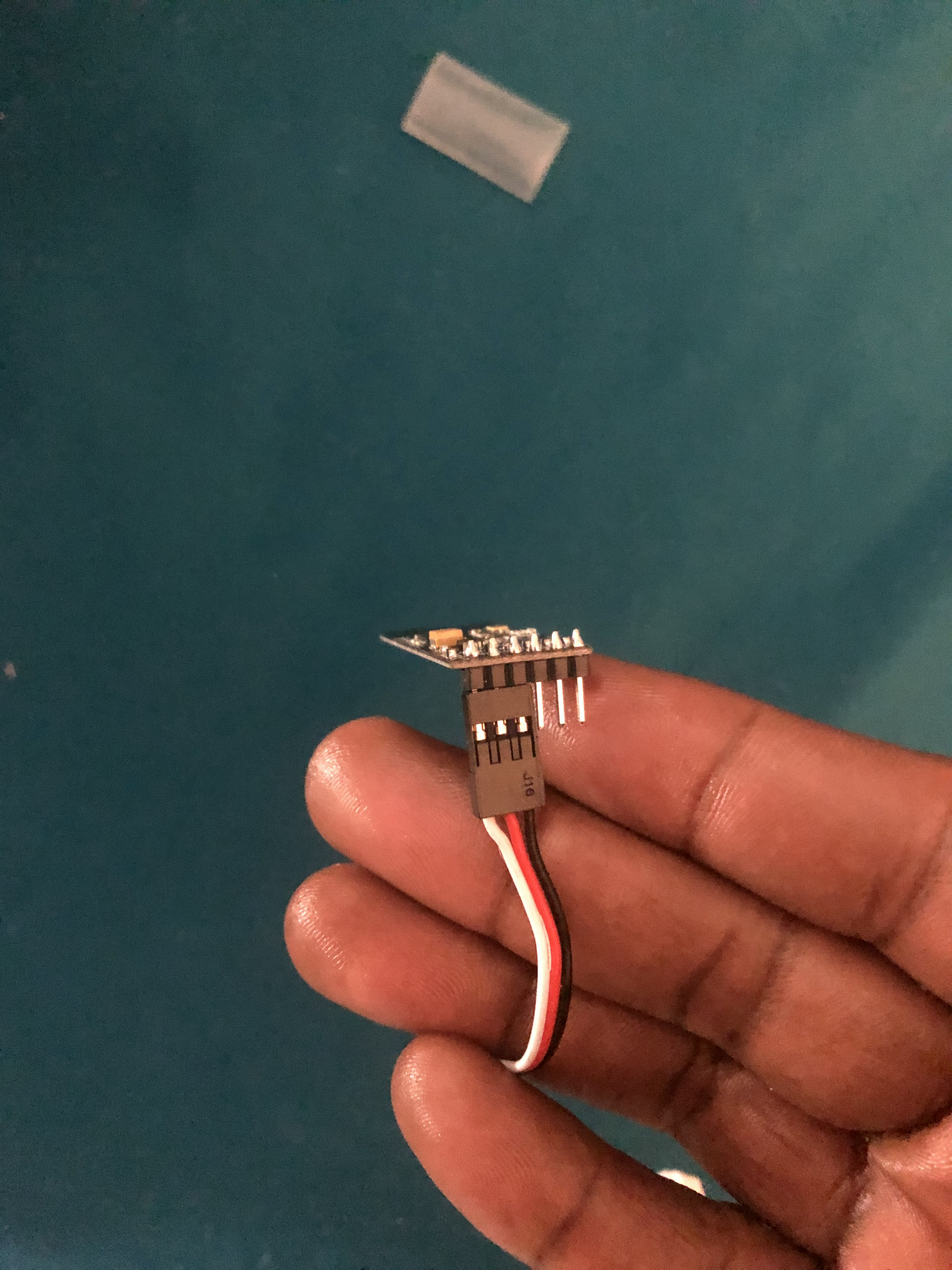

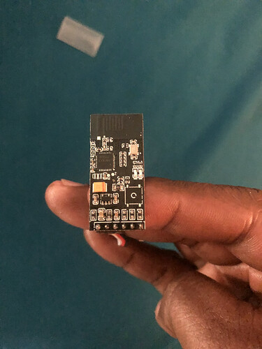

Pic?
Anything obviously burned? Pinched cable?
Did it work before? Changed any setting?
It worked before, I was cruising with it then nothing.
Vx1… can you try to connect it via uart?
Also, very carefully measure the voltage coming out of the esc between ground and vcc and 5v. Should be 3.3v and 5v. Anything else and it’s not powering on the receiver

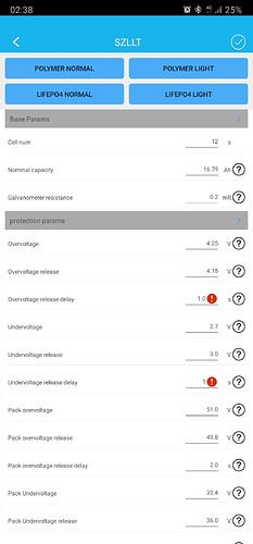

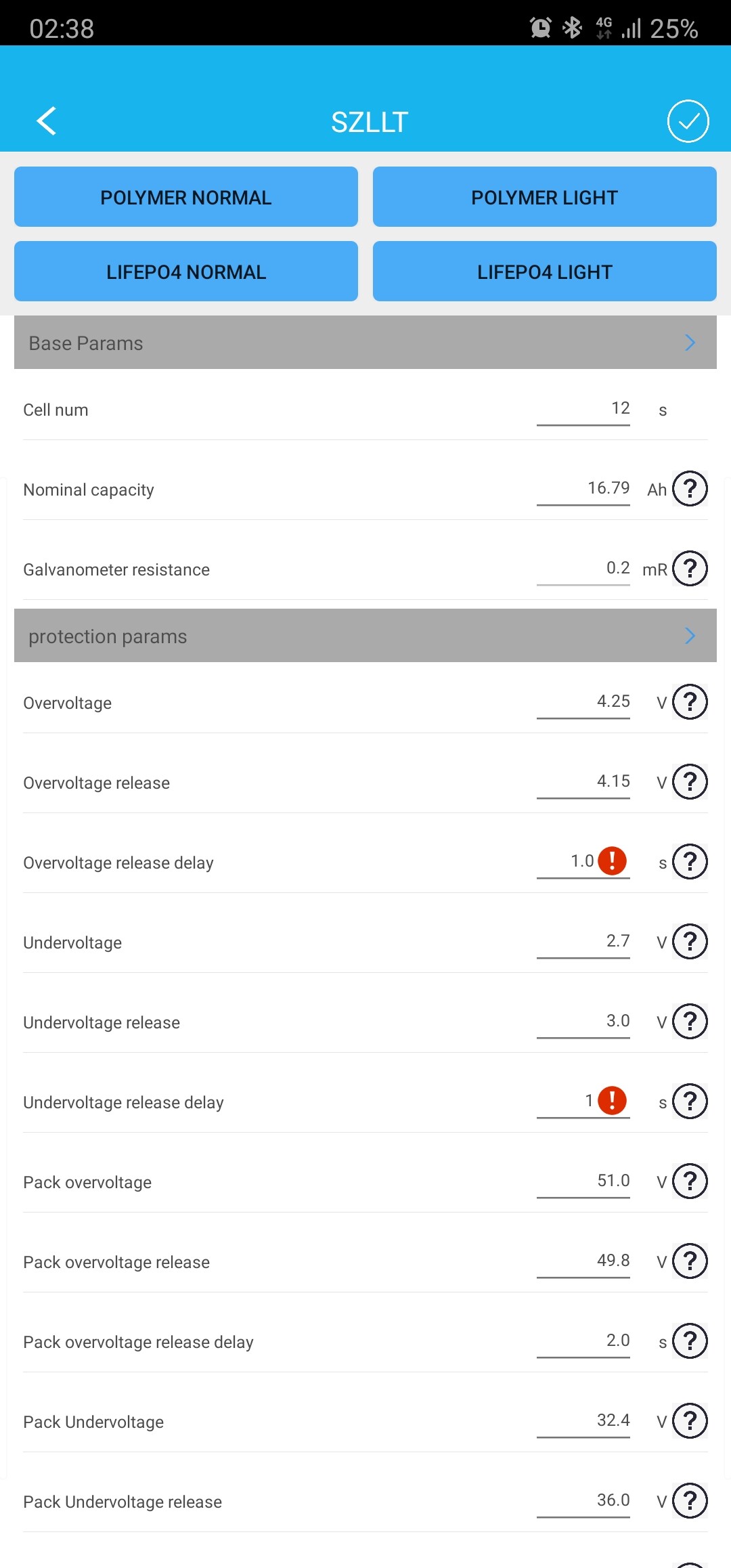

Yep you have to set your “overvoltage release” to whatever you want your pack to charge up to. So 4.19v per cell.
In case you haven’t seen it:
Basically what is happening is that your pack gets to 4.21v for a tiny amount of time, the BMS cuts off charging, and then your pack equalizes down to 4.13v per cell. With an Overvoltage release setting of 4.11v, your BMS wont resume charging until the voltage is below 4.11v per cell.
Make sense?
I actually copied these when I was setting it up :sweat_smile:
Idk if it’s just the version of the app I’m using, but when I try to change the value of the overvoltage release to 4.19, the app forces 4.16 to be input instead:
Something’s not right. Are you sure it’s set to lipo normal, as a start?

Exact same thing just happened to me on my VX1 :man_shrugging:. I was riding along fine and then no connection. I’ve tried unplugging reciever then reconnecting but get nothing :disappointed_relieved:. I’ve picked up a Hoyt St Puck to replace it.
