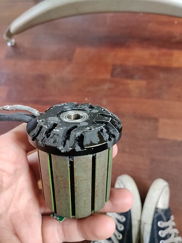

Hey guys, how do i get this front piece off the stator?
Im taking a look at reparing these ol scuffed motors i got from my boy @PixelatedPolyeurthan and yes he put silicone in the front, shame, shame!
Front needs to go off since i need to solder new wires to the windings.

Often that piece has a cylinder of metal that goes inside the stator and is epoxied in there. So it’s likely you cannot remove that piece at all.
Yegh, i was afraid of this, you know any material that dissolves silicone and does not damage enamel? I have been looking for something to desolve silicone and i cannot find anything good.
Fingernail scraping usually works for me
Silicone seems very inert, I don’t know of anything that dissolves it.
ah he told me it was sikaflex291i
so basically its pu
edit: nvm its silicone ugh
