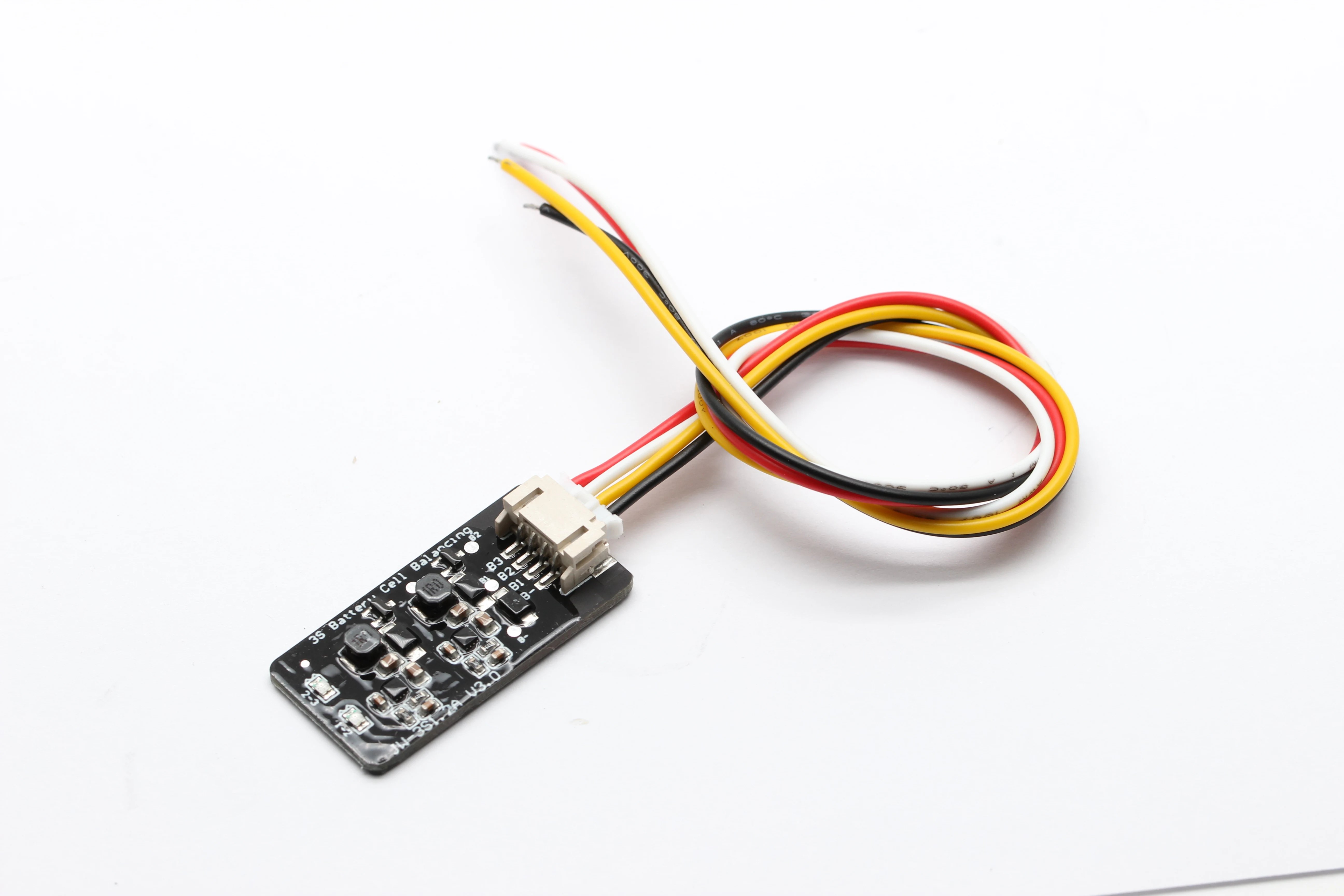

I got a bunch of them for balancing a variety of S lipo packs, but also a few 10-12S ones that I’ve been using on esk8 packs.
Ohh that’s an active balancer. I meant a passive balancer. But yeah, that’s an idea too.
Aw shit, what’s the difference? lol
Bleed vs transfer?
Yes, bleed versus transfer

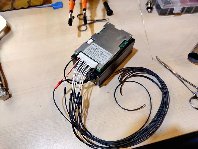

Dammit, I just committed to trying to fit the BMS I have coming in, into my enclosure. I will find a way to utilize the heatsink for sure.

if you have room in the enclosure I don’t see why you couldn’t use it

Yeah, it does what it advertises. I was pretty hesitant bc some of the reviews seem to echo your statement, but I bought a 6S one to put on a busted lipo pack and it seemed to do just what it said it would, so I bought some more.
Did yours just not balance/light up at all? How out of balance was the pack?
I basically charged a 12s pack to 4v per cell, then one pgroup to 4.1v and left it plugged overnight.
The balancer did move charge around the pgroups randomly, but delta between highest and lowest was still around the same 100mV.
Into the dumpster it went. :sweat_smile:
That sounds like just some unneccessary wear on the cell cycle life and maybe some extra weight, but nothing useful :rofl:
Seems like a reasonable test, haha. It’s only ever acted like I expected it to. Drains high cells to low cells next to it if the difference is higher than 30mv. So, for the most part it isn’t doing anything on these packs except for occasionally when charging, and possibly upon discharge as well. They’ve definitely done work on imbalanced packs though :man_shrugging: I guess YMMV!
I have and use lipo bags to charge and store my lipos.Thats fine with my current setup where i have to remove and charge them with a hobby charger. However, since I am converting to a BMS, the enclosure will be the only real defense.
I just don’t think I could fit a lipo bag in my enclosure.

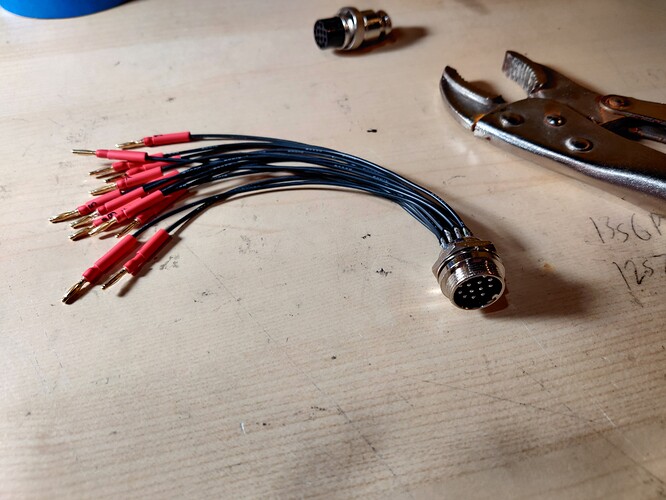

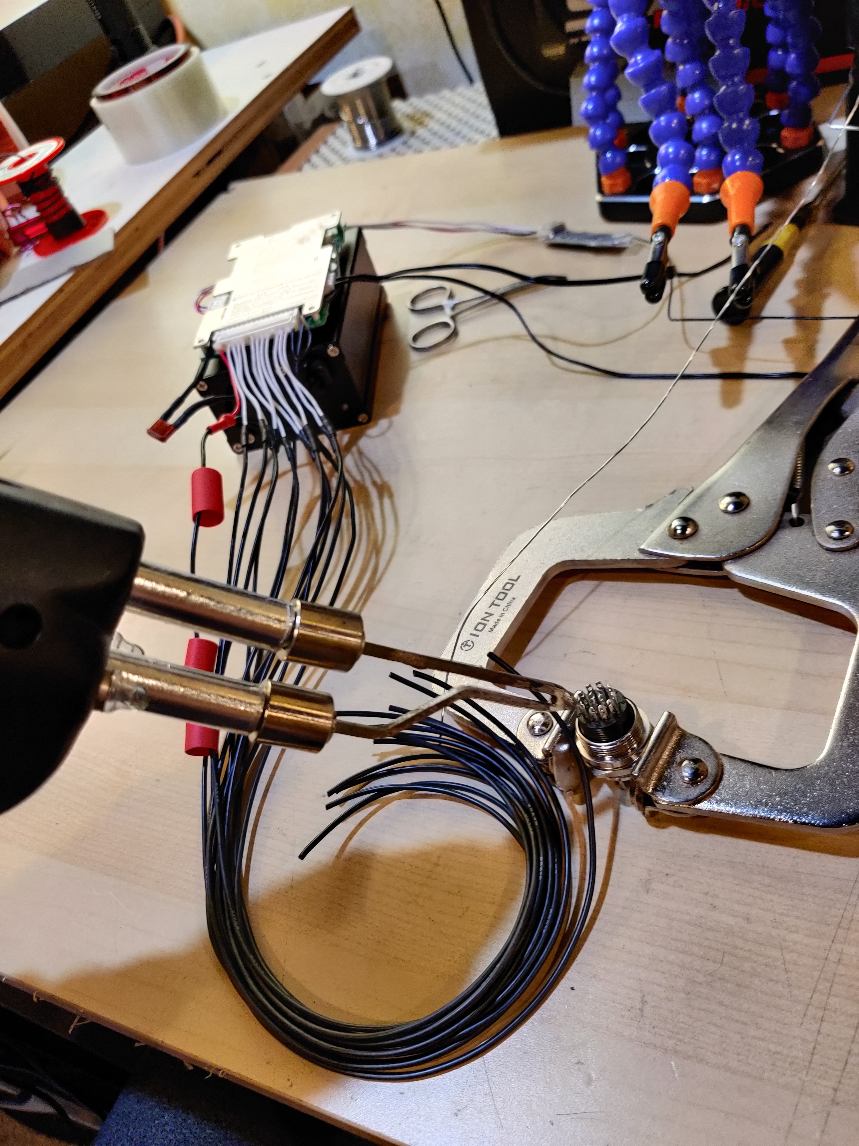

I did it mostly as a proof of concept, and I will be revising my process and doing it again on my upcoming eMTB build. These pictures use a GX20 14pin connector, and @glyphiks is right, a bit of metal or water in the port would cause a big ol’ spark. I plan to print a cover out of flexible TPU.
