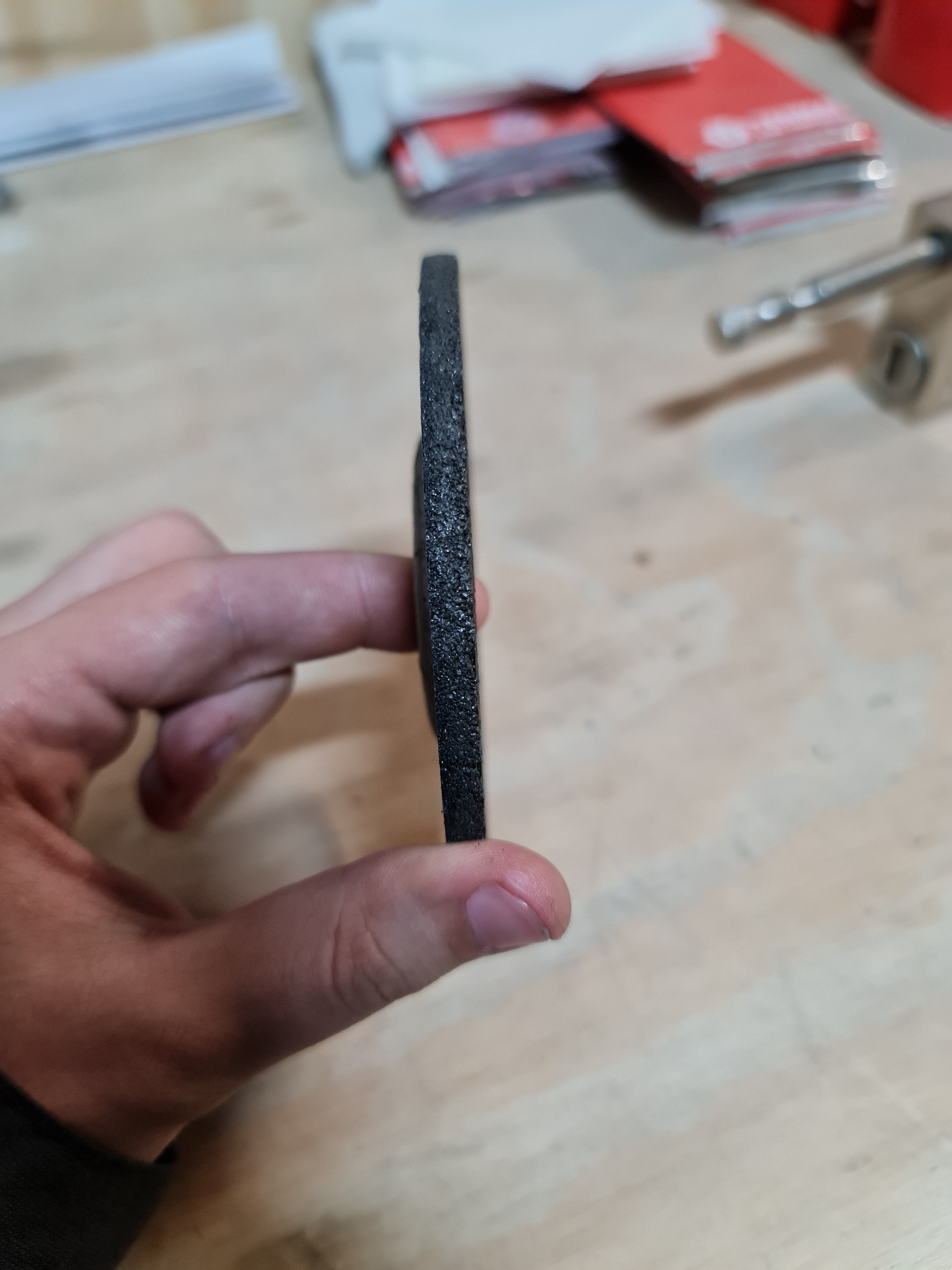

Very slowly with an angle grinder and the proper disc. Tape the shit out of it, cover every hole, mark exactly the distance you need starting from the mounting face and give the angle grinder to someone who won’t set the house on fire to do it. Tell him to finish off the sharp edges afterwards too.
You will want the slightly thicker steel cutting disc for this btw

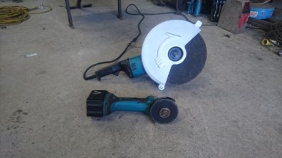

The kickback alone from starting the grinder with a heavy blade can launch it out of his hands. Shit ain’t fun
Example:
Mysteriously everyone who asked for a free blade from the company hates my guts. Wonder why
The tiny ones are fine for precision work, the big ones, not so much :smiley:

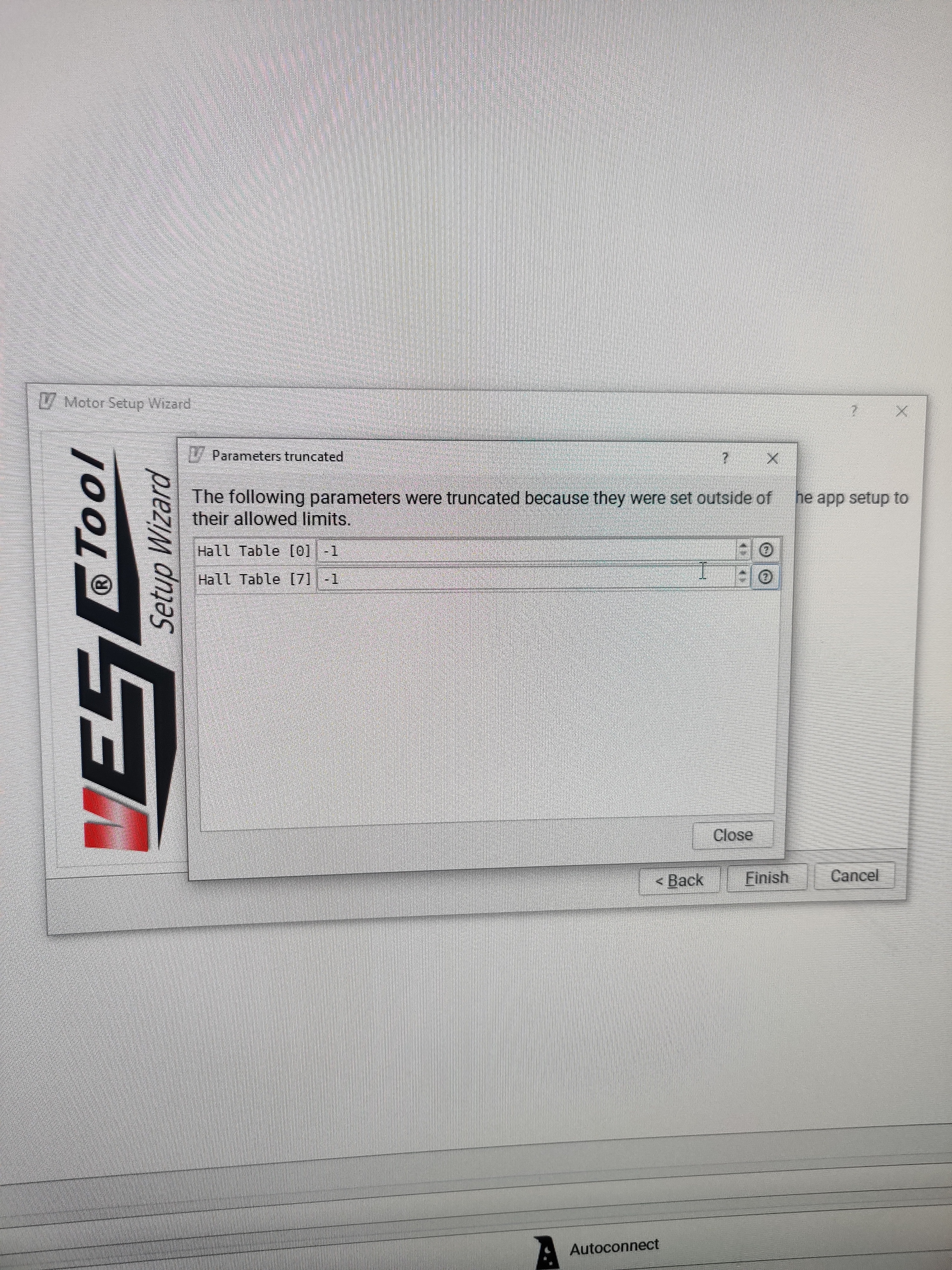

I’m having issues with my motor in which it seems to run ok until after a short period of time, or even turning the motor seems to brake and slow down and sometimes begins to stutter, with it moving back and forth very quickly.
Could this be something related to the sensor wires. I have a HK SK8 149kv 6374 motor that is sensors, being powered by a flipsky vesc. Maybe they are pulling when turning and becoming loose need the motor? I have plugged it in to vesc tool to see if I could set them up again. And got this message after detecting and applying parameters:
Could this be my issue? Any help would be much appreciated! Thanks
Sensors could be fucked, but you should also check with a multimeter to see if you have continuity between your phase wires. If you do, then you have an internal short. If your motor mount bolts are too long, that can cause a short.
Try not using the sensors at all
If I do have an internal short, would running the motor without sensors as @b264 said be ok? Or would I need to replace the motors?
No.
Try the hand test
