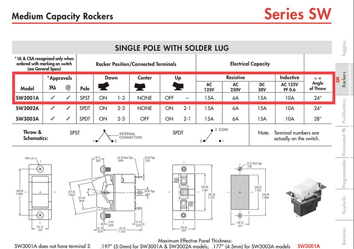

https://www.nkkswitches.eu/products/Rockers/Rockers%20SW/SW3001A/
I’m trying to get 12V out of a 14s battery via a DCDC converter.
The application is a USB power supply, and the DCDC converter is 12V8A.
I’m thinking of using this switch between a battery and a DCDC converter.
Rating is DC30V15A.
Is it dangerous to use this switch?
I think that 2-3A can be used even with DC60V. Is this idea wrong?

Your use case is well within the ratings of the switch, so you should have no problem. Throw a 15A fuse between the battery and the whole lighting circuit if you are worried about something.
Probably not a big risk. I’ll give it a try.

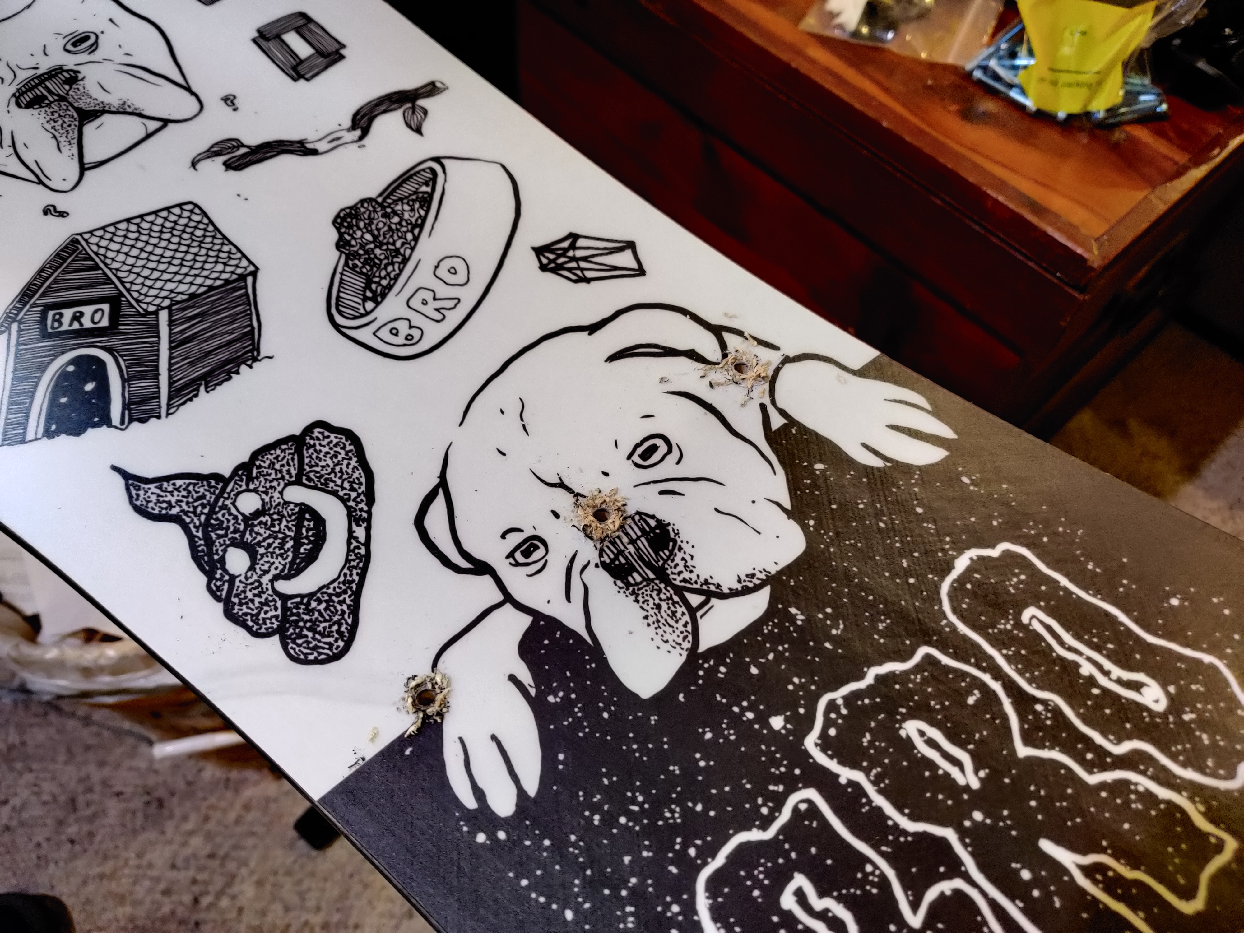

How does everyone mount a top mount battery box onto a concave deck (MBS pattern)? I want to avoid drilling holes, and I originally wanted to velcro it down. However, being a concave surface, it’s not going to stick except at the edges of the board. Plus it wouldn’t let the deck flex well. My next idea is a velcro and spacer sandwich in the center, but I want to see what other people have done that’s probably a much more elegant solution than what I can come up with.

That could maybe work if you can match the curve of the concave close enough, and bolt the spacer to the enclosure. On my Hearo Bro, I drilled three holes in a straight line on the middle of the deck, which has a very convenient flat spot for the enclosure to sit.
I then put a layer of neoprene between the deck and the box, to absorb vibrations and provide extra friction to hold the box in place.
I did it this way so that the deck is still free to flex on either side of the box. No clue if its going to work or not :man_shrugging: might just snap the deck along the perforated line I have made lol. Or could just pop through the bottom of my box when the deck flexes up into the outside corners on the box.

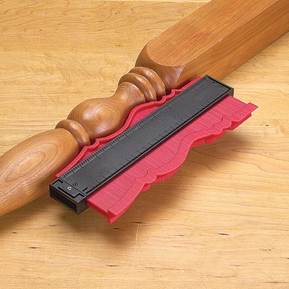

Yeah the concave is the tricky part. Good shout on the neoprene though, I could use that as a gasket and damping material around the edges of the box and the center spacer. I think I can get by with a 3D printed spacer, with some neoprene on it for vibration reduction. Getting that curve right will be a bit of trial and error though.
How bad is it? Probably not. I usually just carry a spare belt and replace them when they snap or start slipping a lot. I have had belts with 4 or 5 little tears or hole in them from rocks. No big deal.
Contour guages are awesome

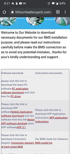

I’m like 90% done with my battery, just need to tape up the ends and wrap it. Anyone know which link I should be downloading for the LLT bms? There’s 3 links on here (android btw)
