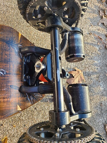

Anyone know the size of the nuts that go on the axle bolts on matrix II?
Can you add 7 inch tires to Bergs though? 150s aren’t that big a tire.
According to Joel himself, the kingpin nut (which is what I’m assuming you’re pointing at and is missing) is M6 thread.

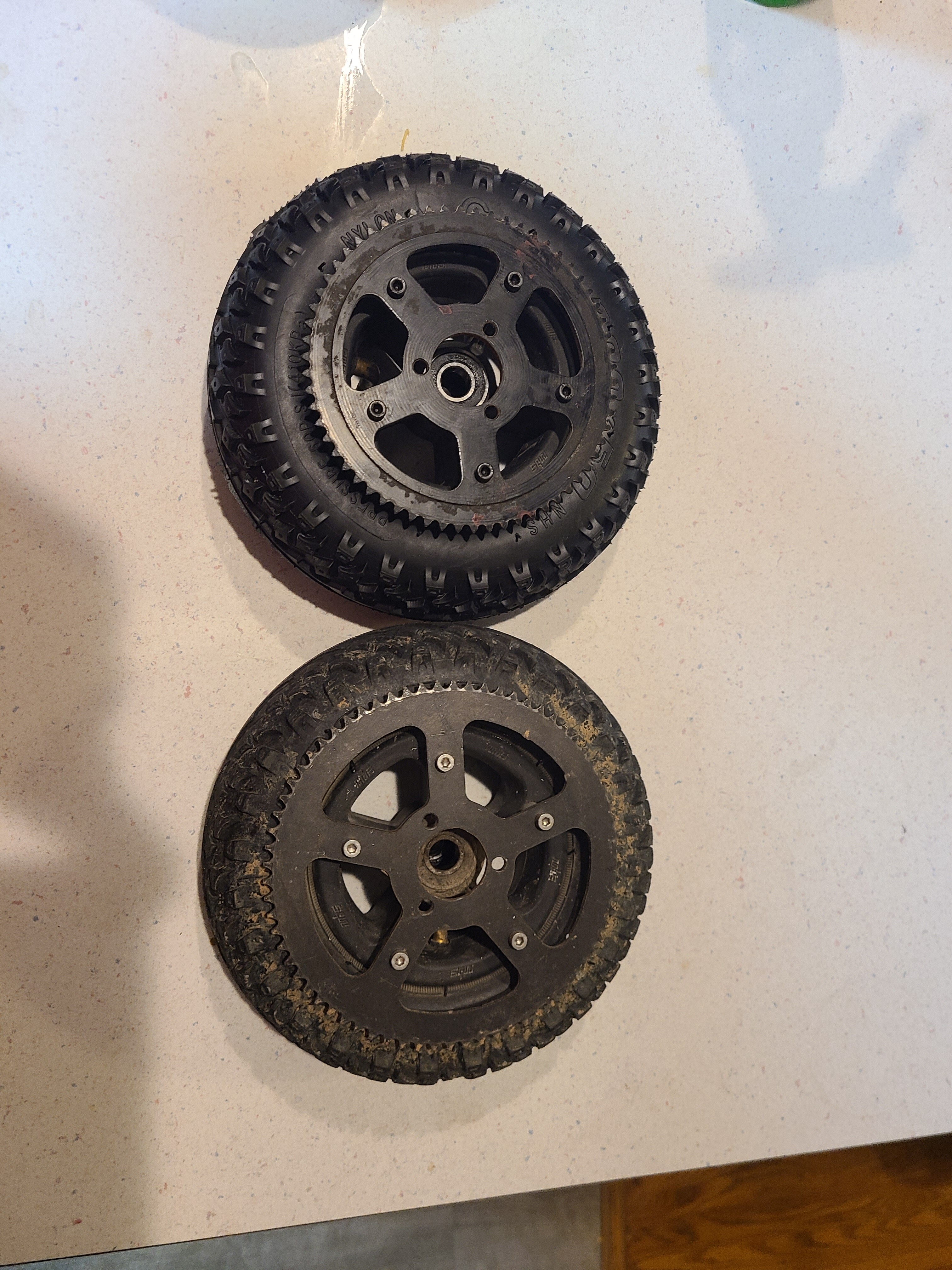

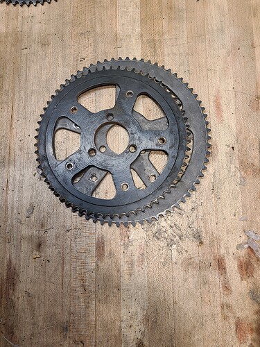

Out of curiousity, what size is that wheel sprocket?
Thanks dude.

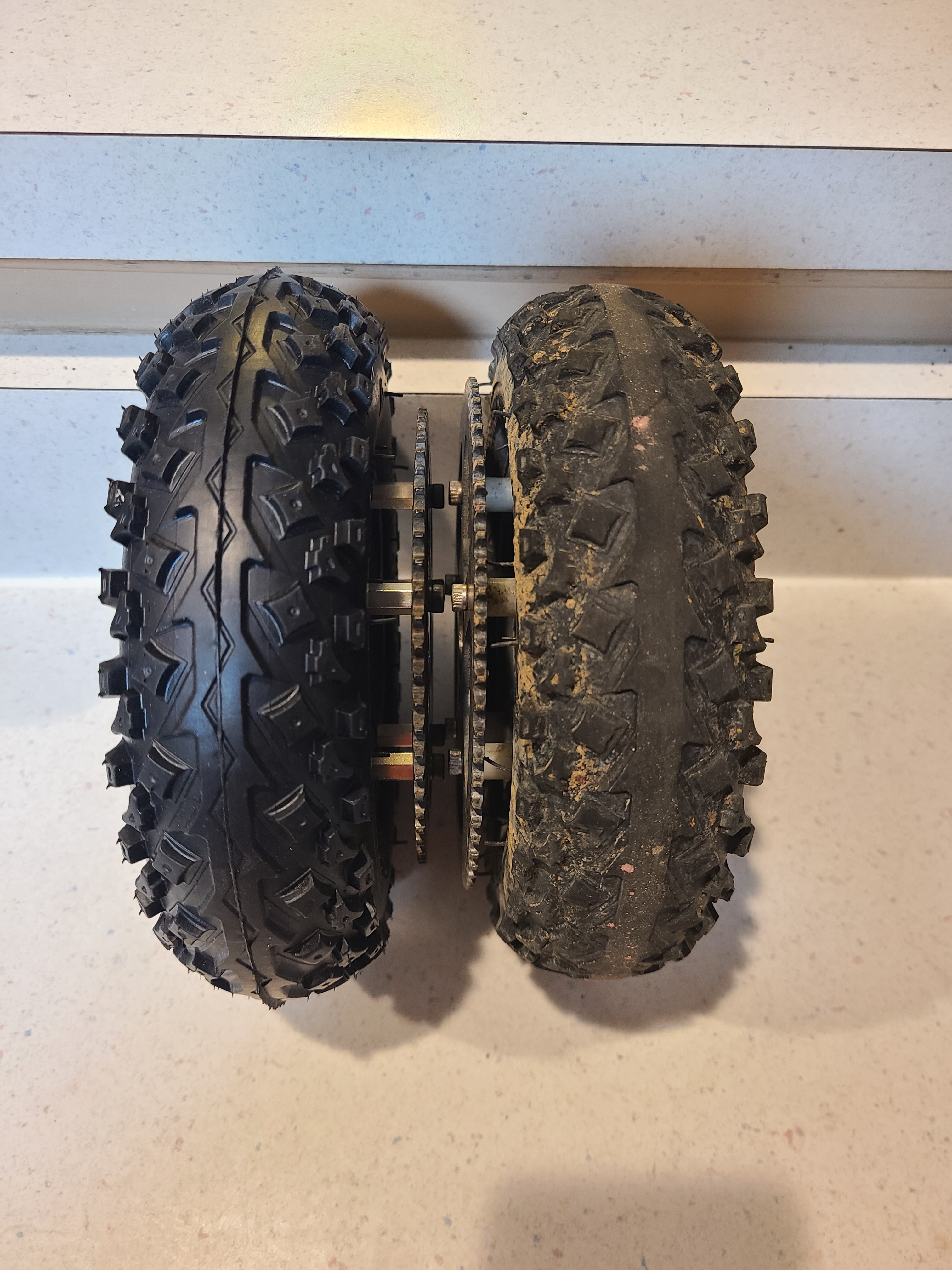

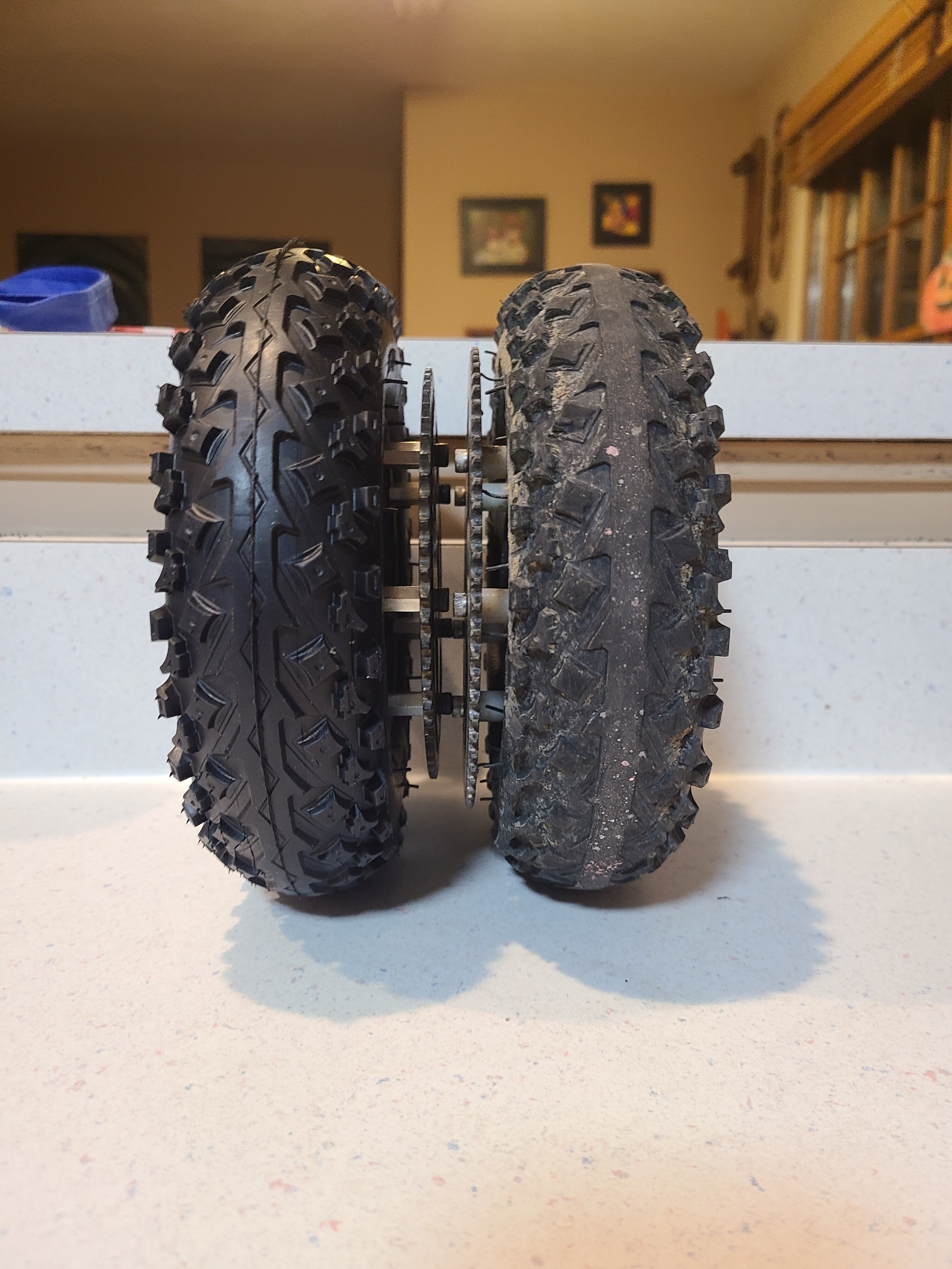

The wheel sprocket is for #25 chain and is 70 tooth.
I’m changing to 62 tonight…
The 70 was not great clearance and would hit stuff sometimes.
Dang ok. I was debating between those two as well, but that 70 is way larger than I expected. Looks like I’ll go with a 62 then. Might have to drop my motor sprocket to 10t instead of 12t to counter the higher KV of my motors. Thanks for the comparison pictures!
Yeah. I go for torque and will be running 12s soon. These are 190kv motors and I’m going to run 9/62.

Wow I didn’t think an extra quarter of an inch of clearance would be a big deal, but that’s a pretty big difference.
