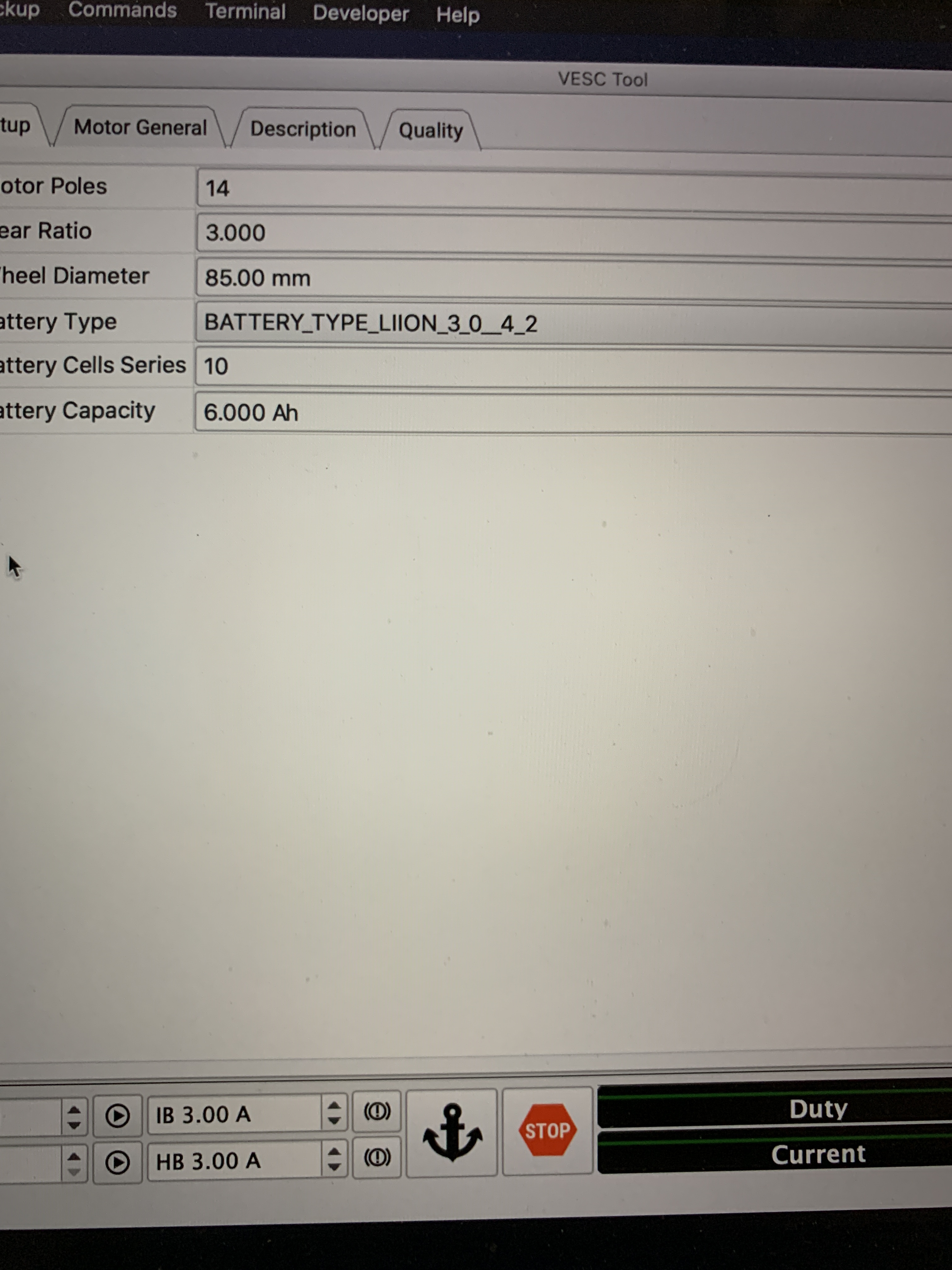

also do i need to worry about changing these or nah
Yes. They should be part of the setup wizard which are all pretty important to tune to your current build
ok, i will try to figure out what the battery capacity is

its a 10s2p p42a battery that skyart built. ive already contacted him for the specifics on the battery
P42a cells are 4.2 Ah each (Hey, it’s in the name! :D) and you have 2 in parallel. So your capacity is 8.4 Ah.
ok perfect. thanks. for detection i did 15a, 250erpm, and 0.15d. should that be good?

i tested those on my test ride and it still had hiccups. i have a feeling that it runs better in foc since i didn’t have issues when in foc
Did you do the detection in BLDC? BLDC has a separate motor detection than FOC. Some folks have tried BLDC without doing the detection, thinking the FOC motor detection was the only one
yes i did, and tried different detect parameters. i also tried bldc in foc setup, but that didn’t work
