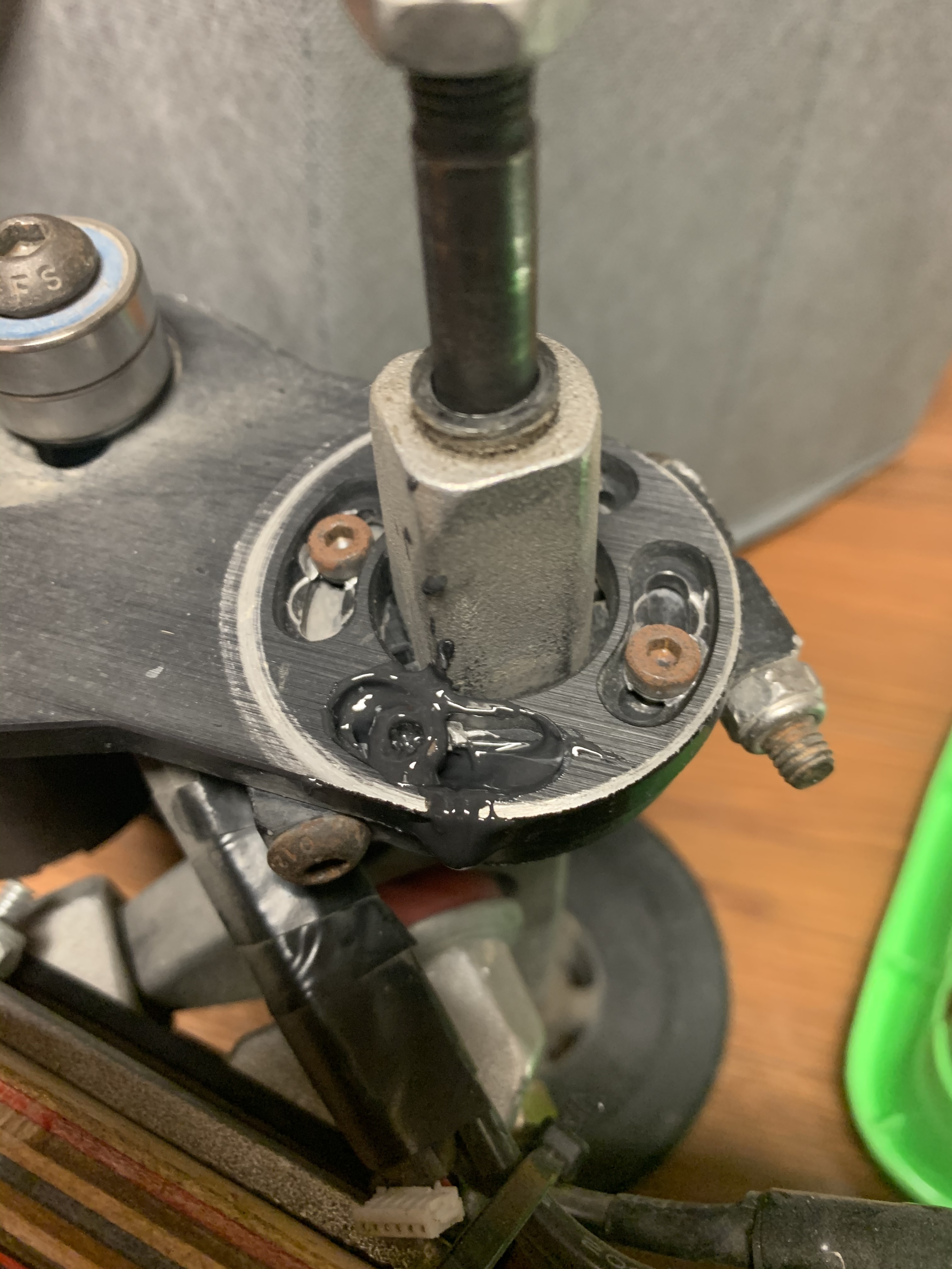

Anyone selling boardnamics idler motor mounts?? mine cracked close to the truck mount.
JB weld here to save the day
Kevin said he’s getting them in stock in a week or two

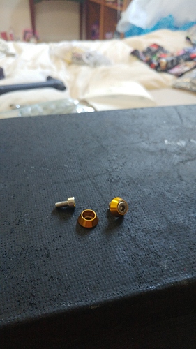

Where do i get hardware like this and also ineerts for the enclosure as im missing some.
Those are socket screws and cone washers; you can get some off amazon, ebay, mcmastercarr, etc. Ezlock inserts are nice.
**o also make sure you DONT get brass inserts, as they strip really easily
I learned to not use brass inserts the hard way haha

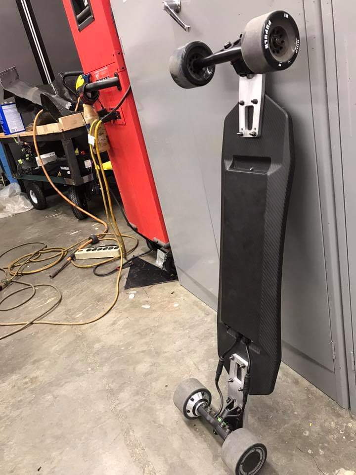

What are my options for achieving evolve type carving without using their DKP trucks? I’ve seen people use surf adapters, but that seems a bit much. any ideas?
Additionally - who sells these? I can only find an expensive surf-skate type substitute
