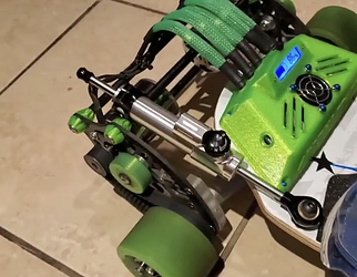

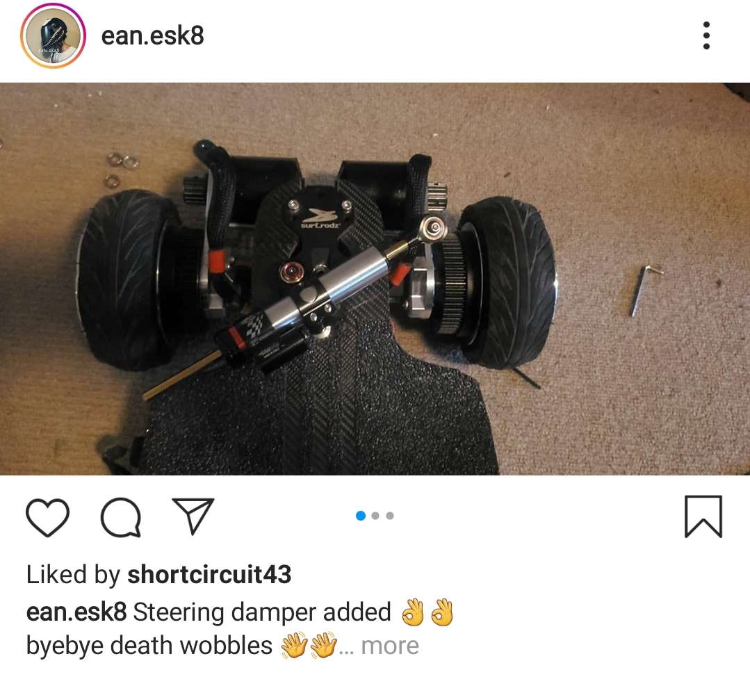

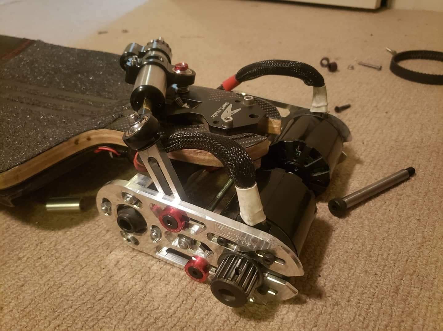

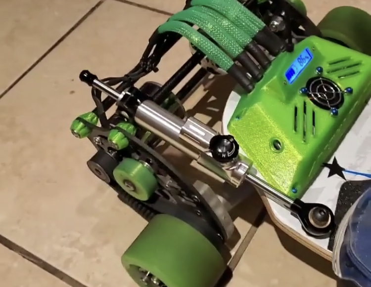

Do anyone here tried adjustable stabilizers?
Like this on the @MomentumBoards build:
How does it feel like?
A guy here in Aus just put one on his new build. I am definitely curious as to how it works out for him
Me too, tbh
Looks like mount tries to break the damper’s axel during turn, instead of pulling/pushing it.
…maybe he rides only forward and does not turn? :laughing:
