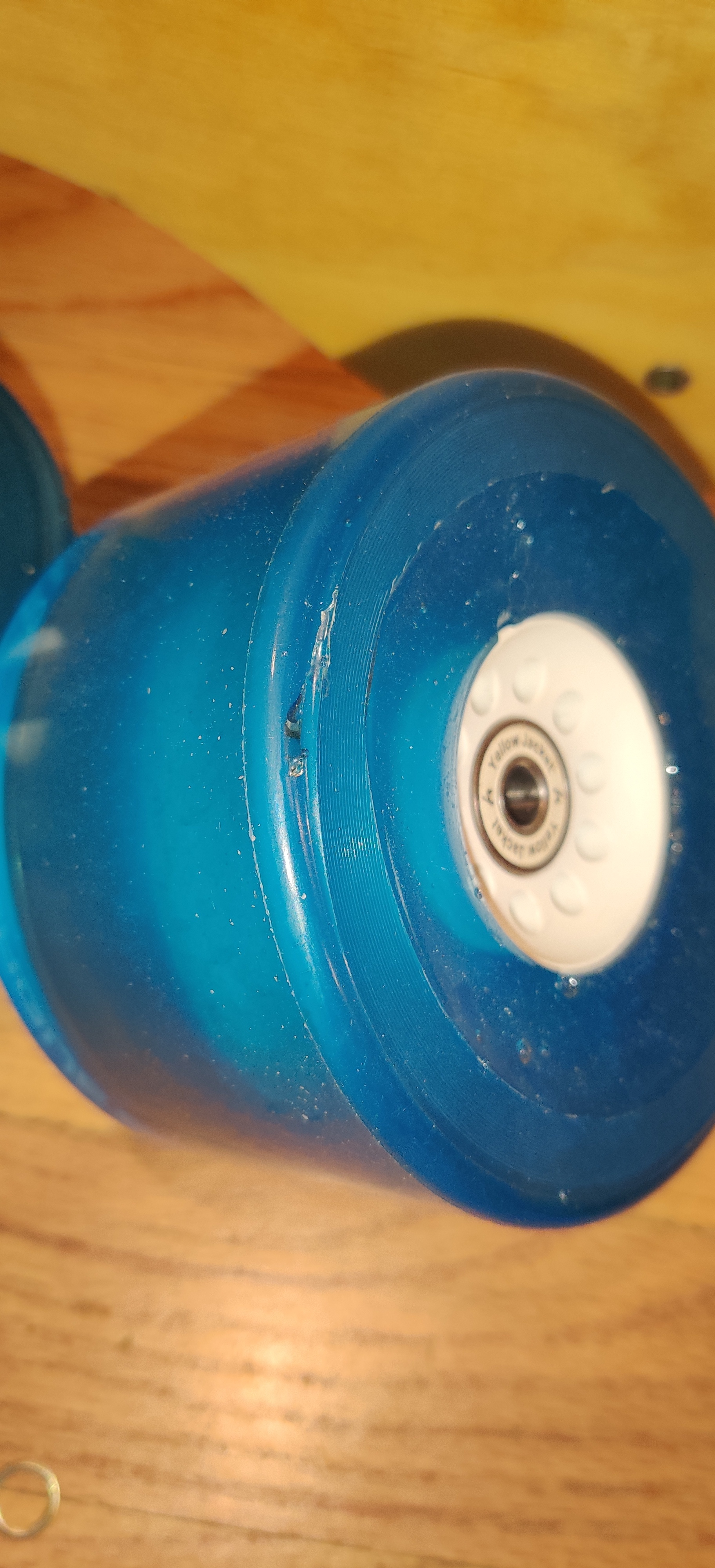

So same deal with the wheel “wobble” on the front (uncut) truck without the pulley.
I’ve also attached some questionable(?) deformations on the wheels. Anything to be worried about?
This last one is the wheel from the original video
I’d email TB and ask them. If the inside edge wobbles side-to-side it’s not really any issue at all. But if it wobbles in the radial direction (where it will lift the axle) then that’s another story.
