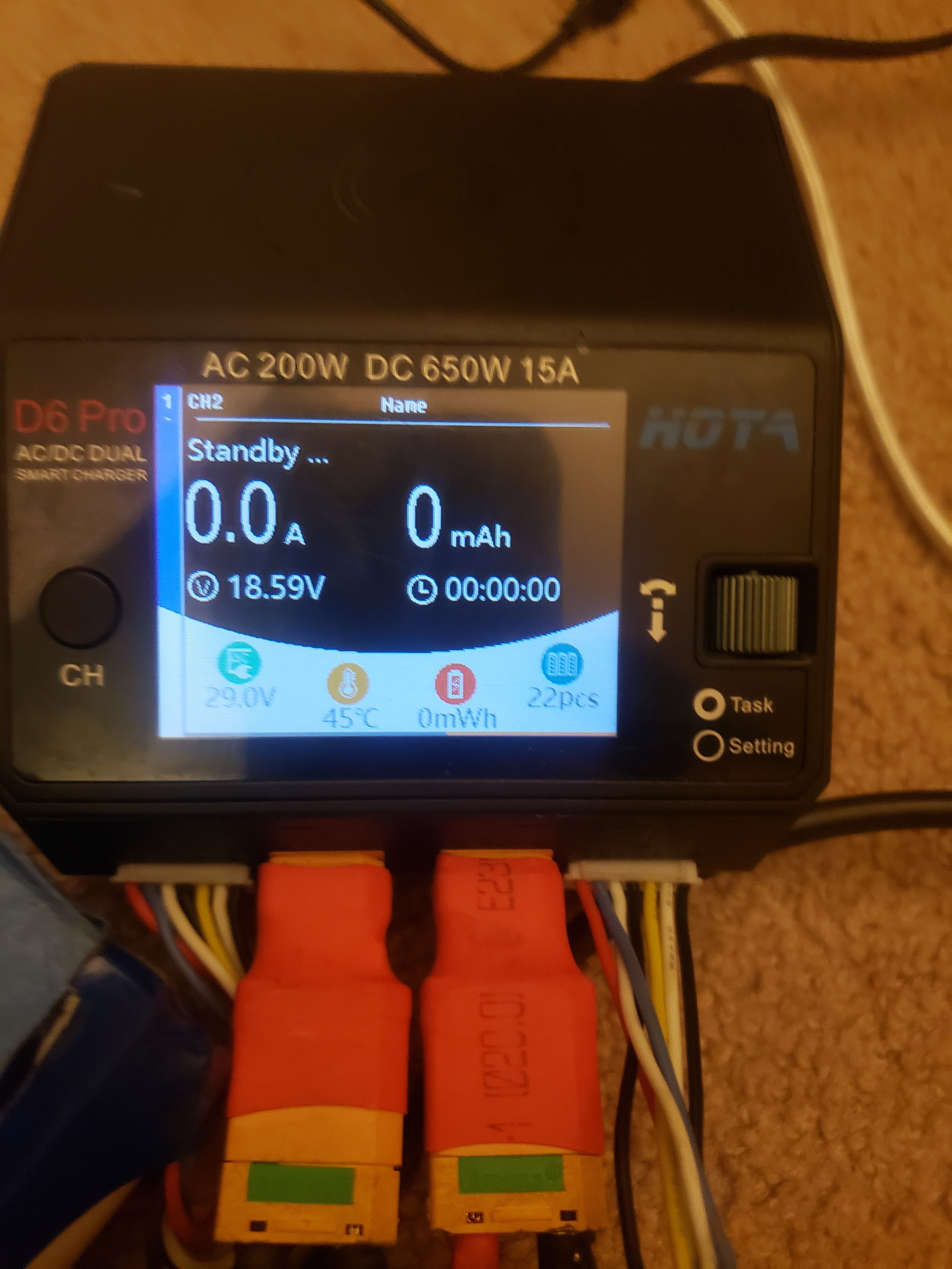

Alright need some advice here. Went to charge my batteries and got this on one of them.
Charger is only sensing 5s for this battery. I noticed some blackening on the red contact of battery balance lead. Cleaned it off but it didn’t work. So I’m assuming one of my cells is fucked, voltage is too low for charger, or the lead itself needs to be replaced. Thoughts?
Can all be verified with a multimeter :slightly_smiling_face:
First 2 with voltage reads, last with a continuity test
