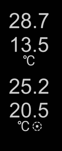

Is there any way to tell the vesc that it has a different temperature?
The temp reading on one of my 4.12s is quite a bit off. Is there a way to tell it “you are at 28c instead of 13c” ?
Usually, its the software program that does it for you. But unfortunately, I don’t know if the system named it something else.
Its supposed to be Temp. Adj. Its basically the thermostat of the vesc software. Maybe someone knows the name for it and location?
Edit: its called thermistor.
