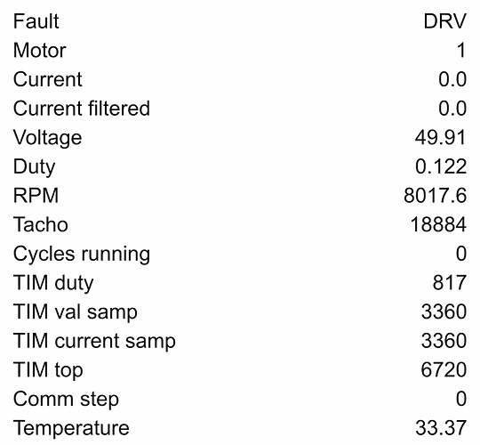

Does anyone know why I keep getting DRV faults?
They usually come in burst like this:
All within one second, and always on motor 1.
and here is the message:
But I never notice them while riding and I’m not sure when they started because I just got my Metr yesterday.
Here are some more pics:
Always 0 current too.
