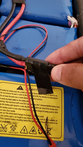

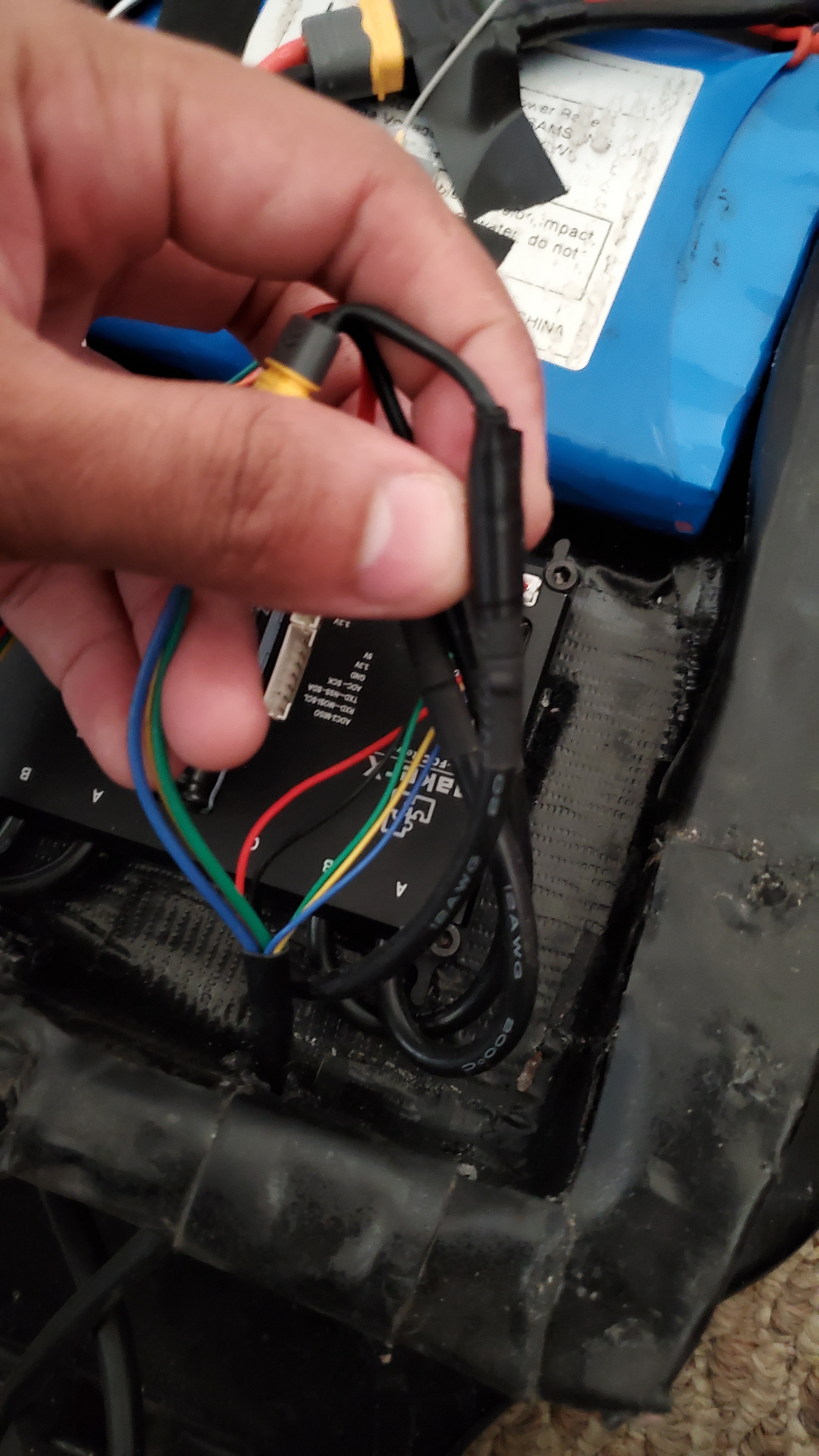

Oh those. Yeah, I’d say add electrical tape like so:
The reason why I say to add it is because there were people who broke their esc, and it was because their wires came off while riding (I also experienced that as well).
And those can be placed within the esc enclosure with no vent needed.

I would absolutely avoid electrical tape.
Firstly, it leaves glue behind everything it touches for more than 5 minutes. Like, cheese strings kinda glue.
Secondly, the glue on electrical tape is not made for high temp. It softens like that gum you left in the sun at 50°.
Ziptie connectors that can be ziptied, use kapton tape on small, non-essential things like remote wires. Maybe double sided foam tape for the receivers.
Finally, velcro strips for the heavy components. Don’t go overkill or you will have trouble removing stuff. Fill up with foam cut chunks/strips (neoprene works, just know that it doesn’t resist tension in time) for very big gaps like sides and to the “ceiling” of the enclosure space and test if anything rattles inside. For the “ceiling”, things like egg crate foam works as well
