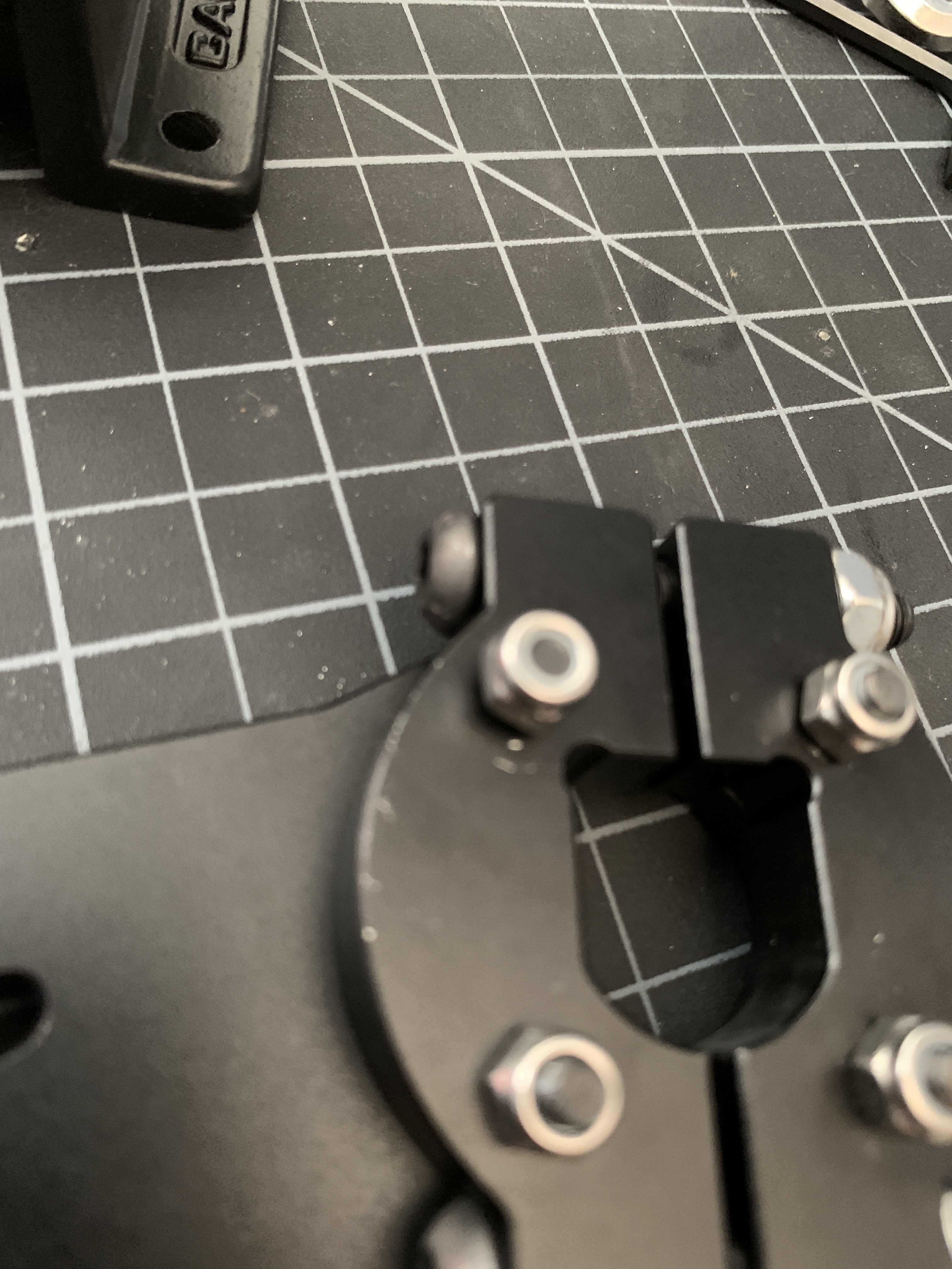

Welp, I just stripped my m4 screw for my boardnamics mount. It wasn’t screwing in, and now I stripped it
Stripped the screw threads, or stripped the hex drive?
The hex drive
I would like to still use it since I don’t have a replacement, but I can’t get it to move
Grab the head with a pair of visegrips or similar and use a wrench on the nut.
If that doesn’t work you could also try cutting a slot into the head and using a flat blade screwdriver.
Or you could try a screw extractor.
Then once you’ve got it off, throw it away and buy some class 10.9 high strength fasteners (stainless is soft and easy to strip), and a set of Wera Hex-plus hex wrenches. Yes, they are more expensive. Yes, they are actually worth it.

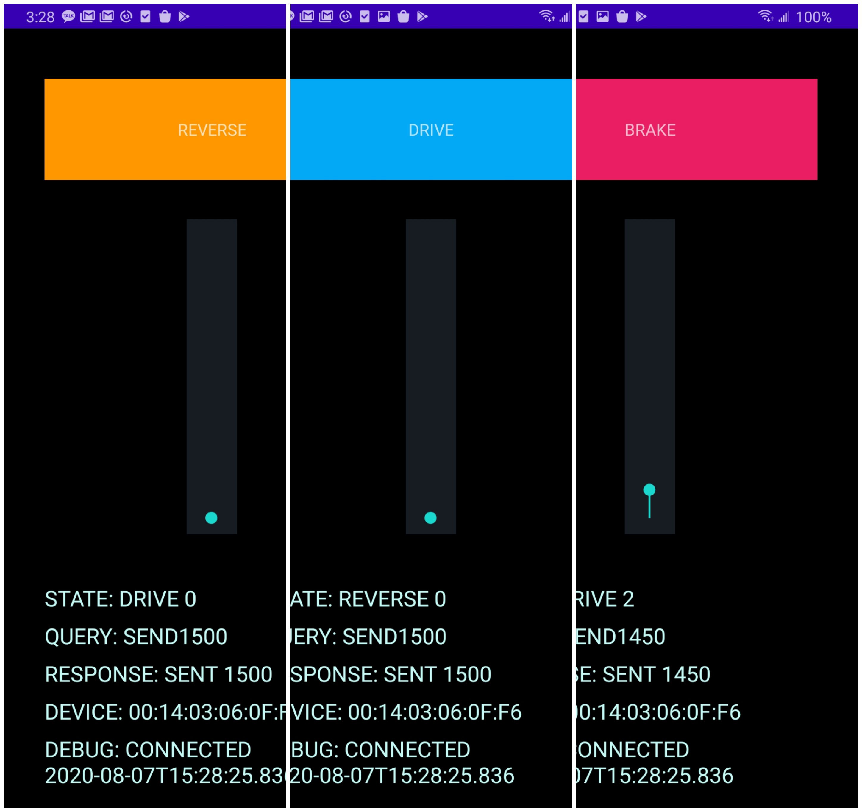

@Venom121212 each keypress is an incremental change. Just less discrete steps than a potentiometer in a standard remote.
To add: wera blacklaser steel, not stainless. The 1.5mm bends like wax

So it acts like a cruise control then or do you have an on screen slider?

Right now I don’t have the money to buy another set of hex keys, but I decided to just use something similar to visegrips to tighten it down, and the mount seems pretty sturdy now
Put them in your wishlist or save them for later so you don’t forget to grab them once you’ve got the cash on hand.
And don’t forget the high strength fasteners either. I like to get most of my bolts, screws, etc. from boltdepot.com.
Yeah. It maintains the speed without me holding the volume keys down. Initially used a touch slider instead of physical buttons and I was concerned about accidental sliding so now its purely a visual indicator of speed.
Okay, I will purchase those when I have the chance. Hopefully, the screws will be tight enough for now, and then I’ll replace them in the future.
