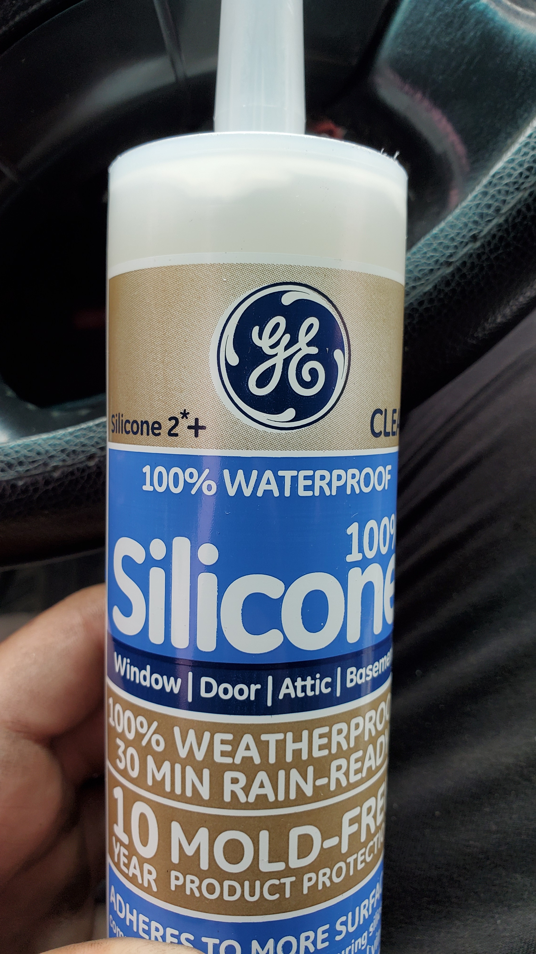

@b264 Hey is this the silicone you use inside your enclosures?
That’s what he suggested to me. The 2*+, like you have, is the one.
Thanks man

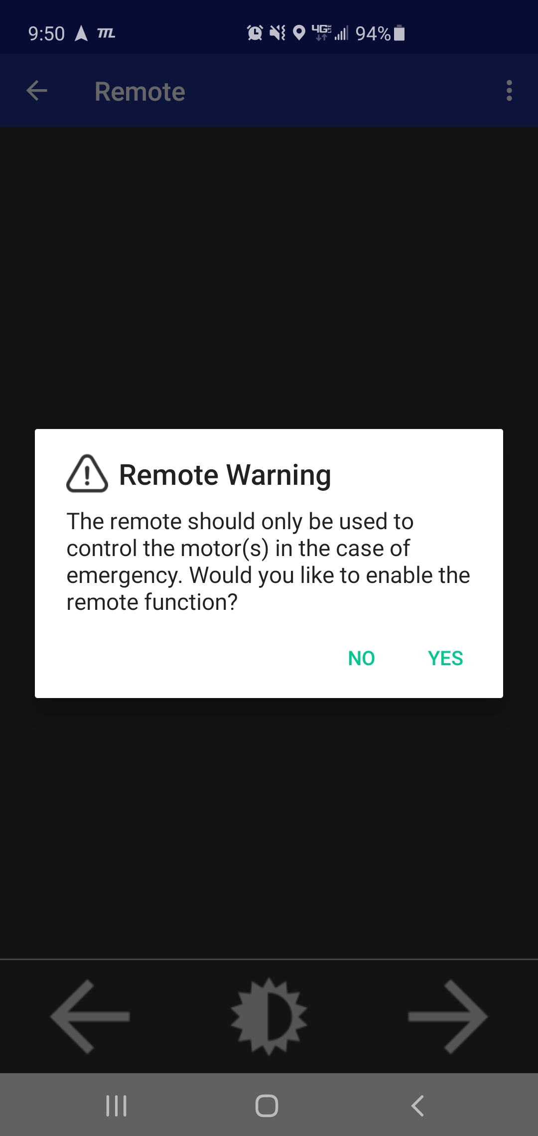

@jwy it isn’t a very reliable way to control. How do you differentiate between half and full speed with the volume keys?
@ricco put an emergency remote control via his lighting control app. I haven’t had to use it ever but played with it on the bench and thought it could be cool if my remote died far from home.
Not connected to board atm though so I can’t show the full interface
