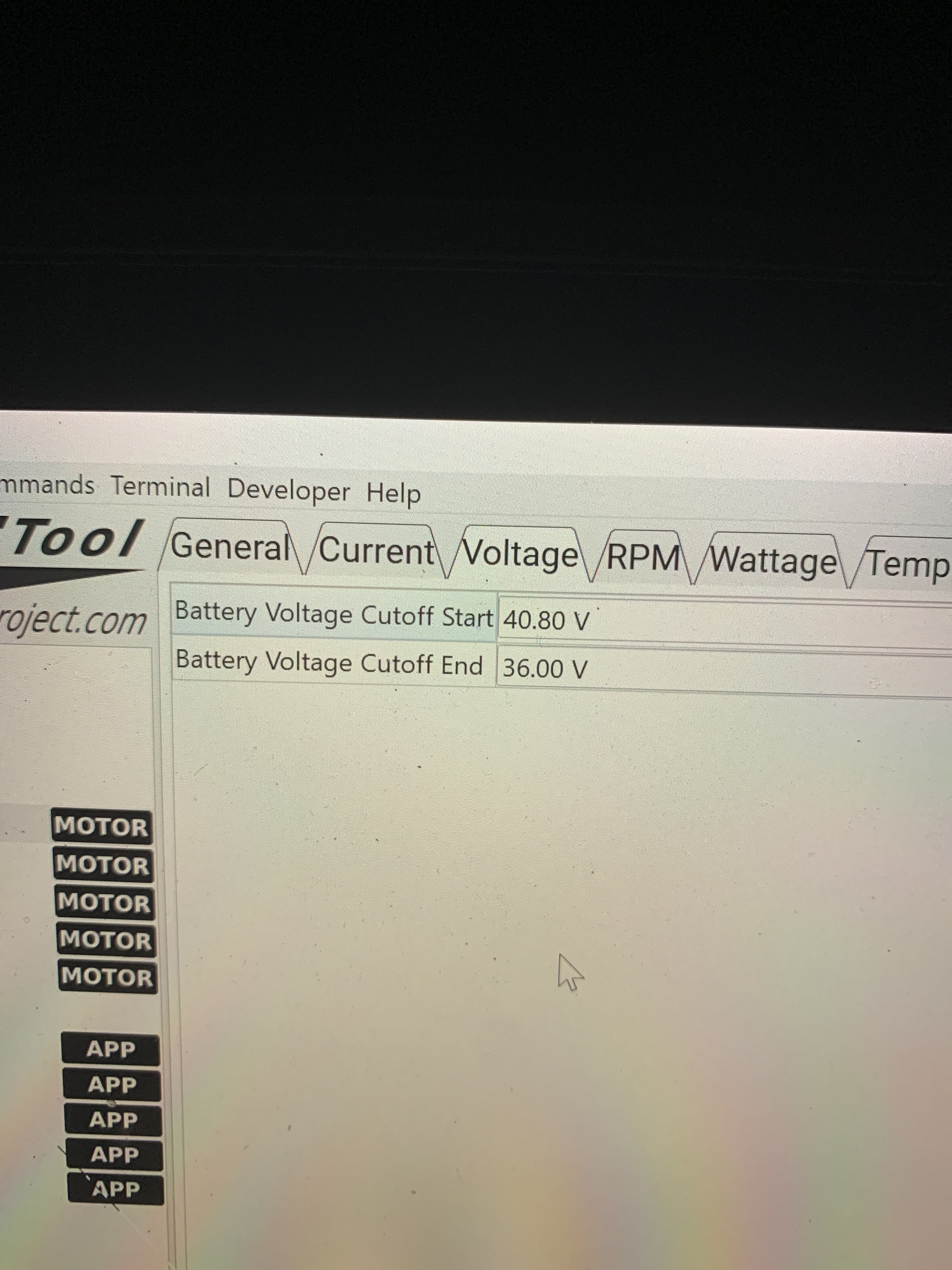

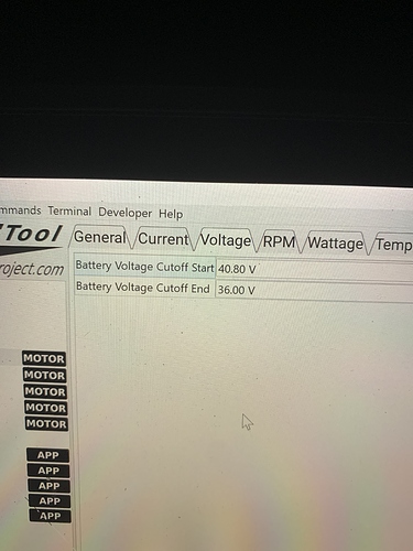

What are your battery cutoff settings?

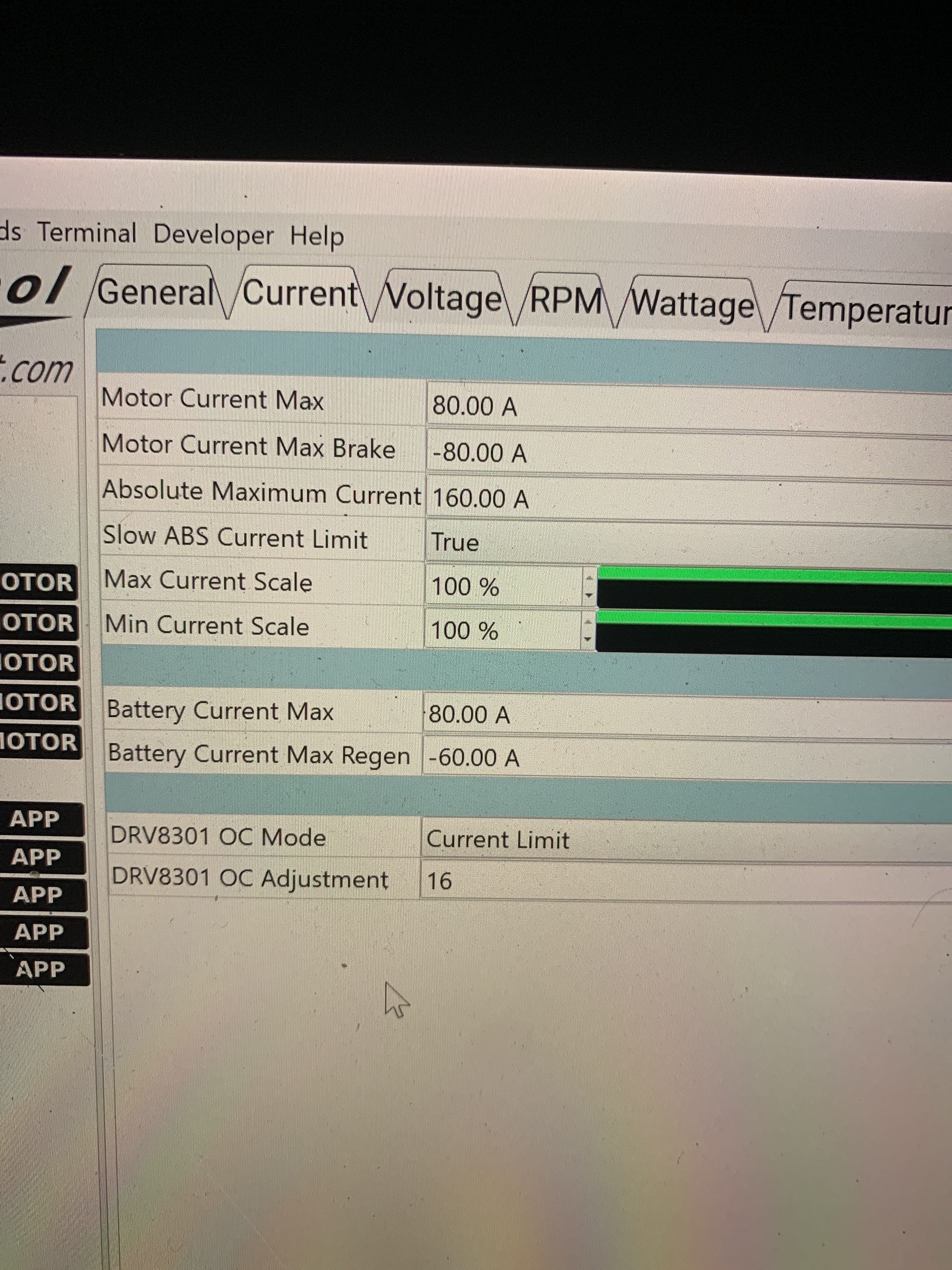

That’s the ESC temp, not the motor temp. My AT board has motors colder than the tires and the ESC has to throttle because the FETs are cooking

As @ZachTetra says ESC temps are separate from motor temps. you probably aren’t feeling the ESCs temps…
80°F for the ESC isn’t bad.
180°C for the motor would be absolutely irrepairable like you said, but they didn’t even feel warm to the touch. I am almost certain the reading is off, but I don’t know why or how to fix it

That’s another weird thing. I started with about 60%, drained it to about 50%. Turned off the board and stuck it in my car and drove home (Wasn’t hot in the car). Got home and rode it a little bit and app was saying 0%. Again, this is a 12S8P battery. Plugged it in for like an hour and a half, still saying 0%.
What BMS? It might just be fucked. Check the connection there just in case.
right i mixed up motor and esc in your screen shot. why is one saying F and the other C? I bet they’re both in F and motor is mislabled. so your motor hitting 82c…
that’s the beginning of thermal throttling with default settings… and in the range of throwing faults if you have the dreaded temperature sensor noise issues. however if you have unity firmware it has a motor temp throttling flag that disables it and is usually disabled.
Tried changing between Celsius and Fahrenheit and this is what happened. Weird!
so negative numbers usually mean no temp sensor. :). but jumping from a large positive to another random negative means software weirdness.
