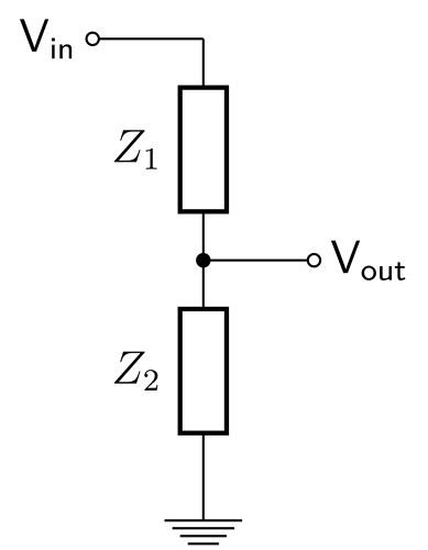

in my not so expert opinion. I think this is a voltage divider. to drop the signaling voltage from the HC-5 to match the vesc.
source: I built a “nanite” arduino clone and it used this trick to adjust usb signaling voltage so it could just be handled by one of the ATiny85’s pins
I’m not a sparky guy by any means but the resistors are on the TX line and then to ground…
am i just fukked up???
so it’s dropping the vesc tx voltage to the hc-10. IIUC. i’m not super sparky either but I think about it.
this is a simple voltage divider. which is what that thing looks like it’s doing.
