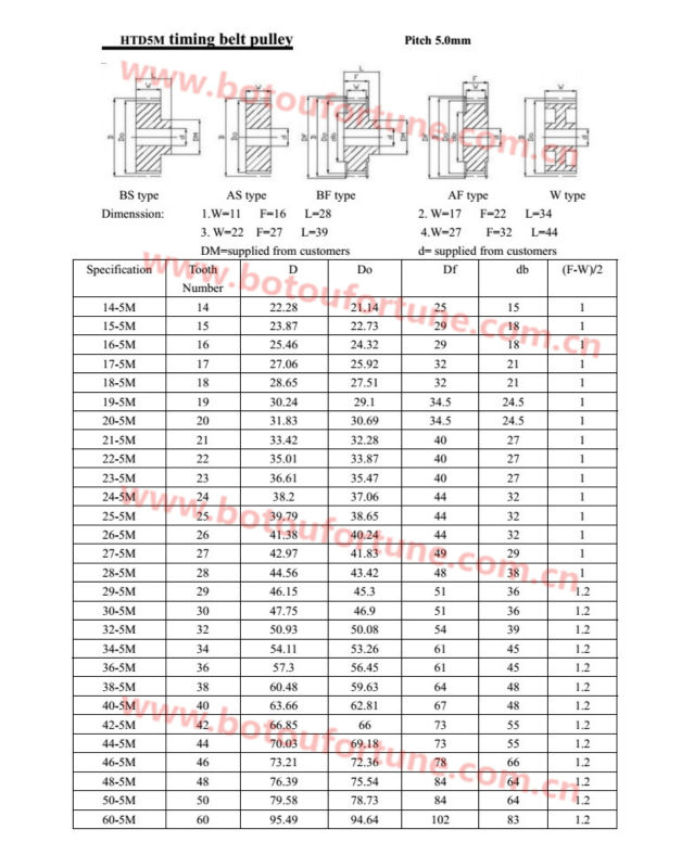

does anyone have a calculator, or reference dimensions of what size (in O.D.) a 5M pitch wheel pulley is?
I don’t want a gear calculator thank you very much… I wanna know how big a wheel pulley I can put on a specific OD wheel…

Something like this? Courtesy of some random alibaba page

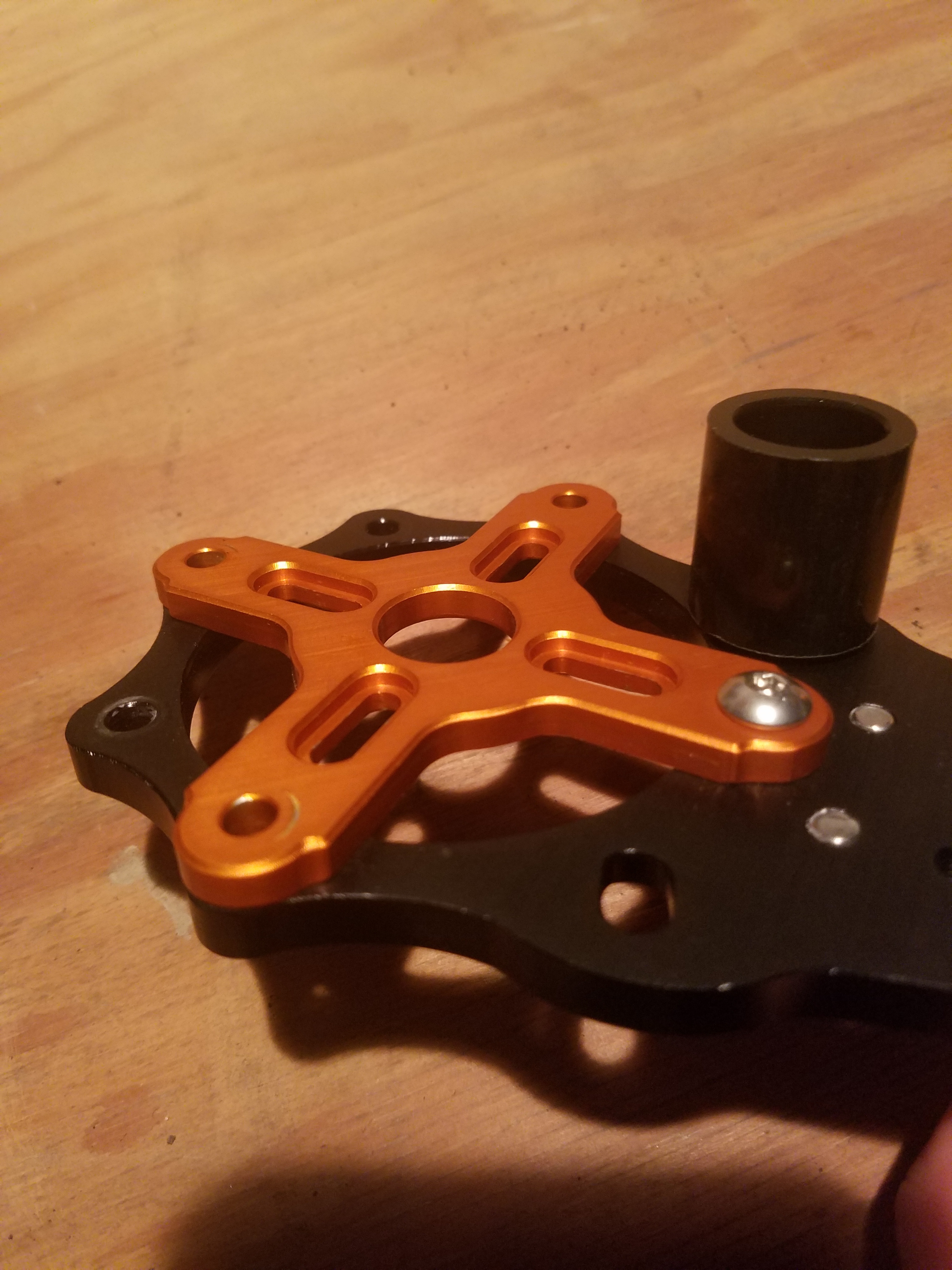

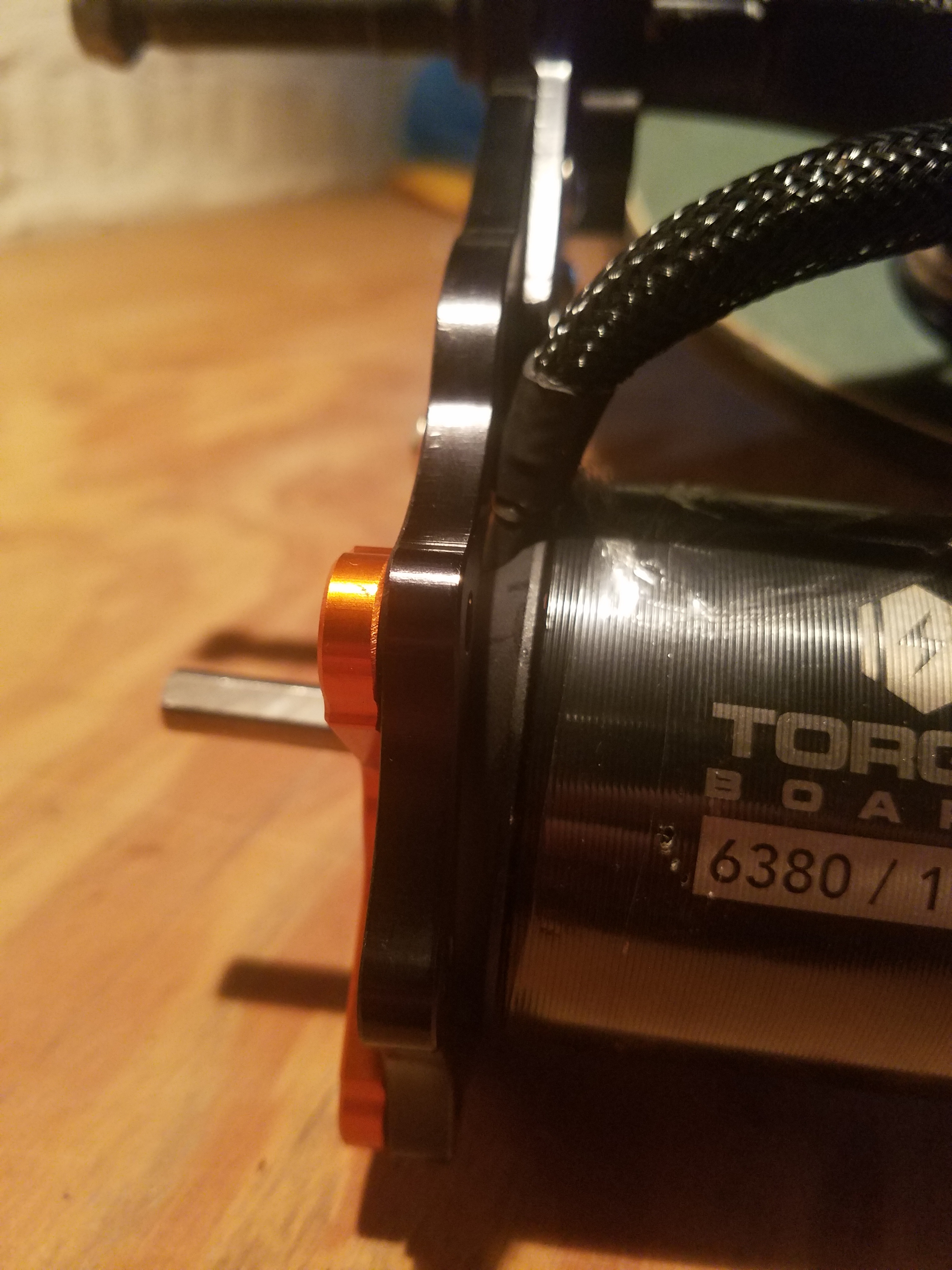

When I’m mounting my motors onto the mounts the wires are already touching. This happens waybefore they are even tight yet. I’m afraid if I tighten them down they will get crimped and not be good for the wires. Is this ok? Or any suggestions?
Anyone ran into this issue before? It seems like its rubbing or binding.

If you mean the wires are getting bent back so they’re perpendicular to the plane of the mounts, that’s fine. If you’ve got mounts that bend the wires back more than that (some have a pocketed out area for the motor) then I’d recommend rotating the motor 90 degrees so the wires come out the side rather than against the mount.
It’s repeated bending that tends to cause problems.

Yeah it is pocketed and this is nowhere near tight yet. There isnt anywhere for me to rotate the motor to so it doesn’t do this. Unless im misunderstanding something

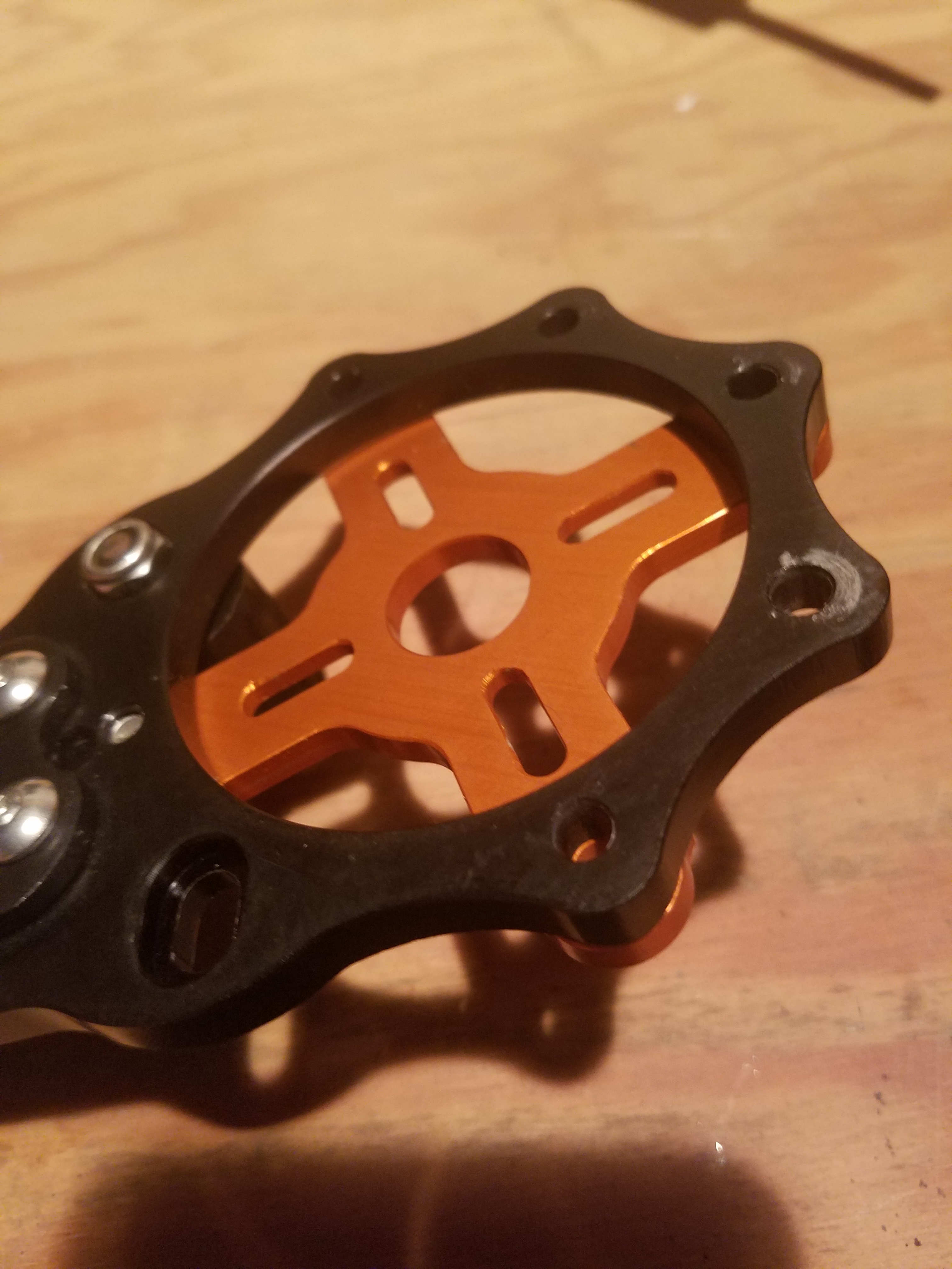

You got a picture of the mount without a motor on it?
Tb6380s and janux mounts
Is there room to thread the wires down through the hole before tightening the motor down?
Or how about putting the orange plate on the other side? You’ll lose some motor-to-motor spacing but it’ll keep the wires from getting bent.
YES… that is pretty fucking close comparing the Do dimensions…

That mount doesn’t look like it will work unless you are able to feed the wires through the mount plate onto the belt side.
I would get a different mount.

It seems like the motor should go right onto the orange part and that would act as a spacer for the wires not motor going through black part to get to orange part. Like @MysticalDork said will lose some width but would give more space for the wires.
After fiddling for afew seconds i flippedthe orange piece onto the other side and it felt magical. Haha. There’s even a cutout on that side so the orange piece fits inthere perfectly.

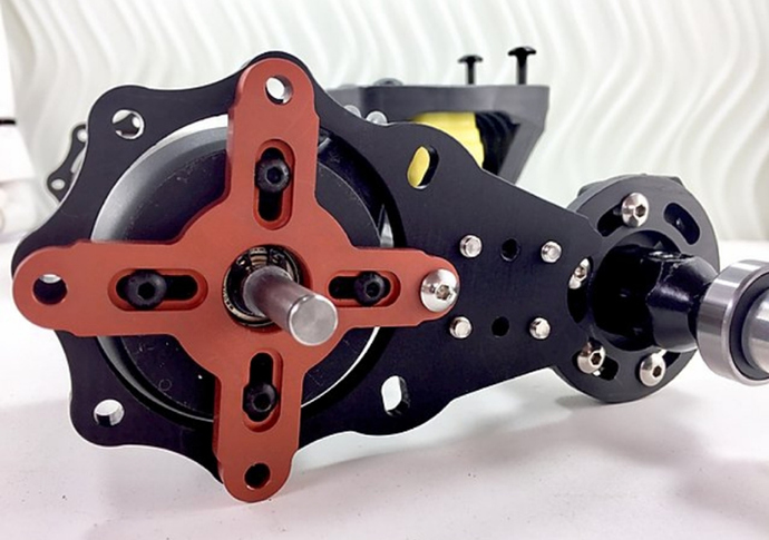

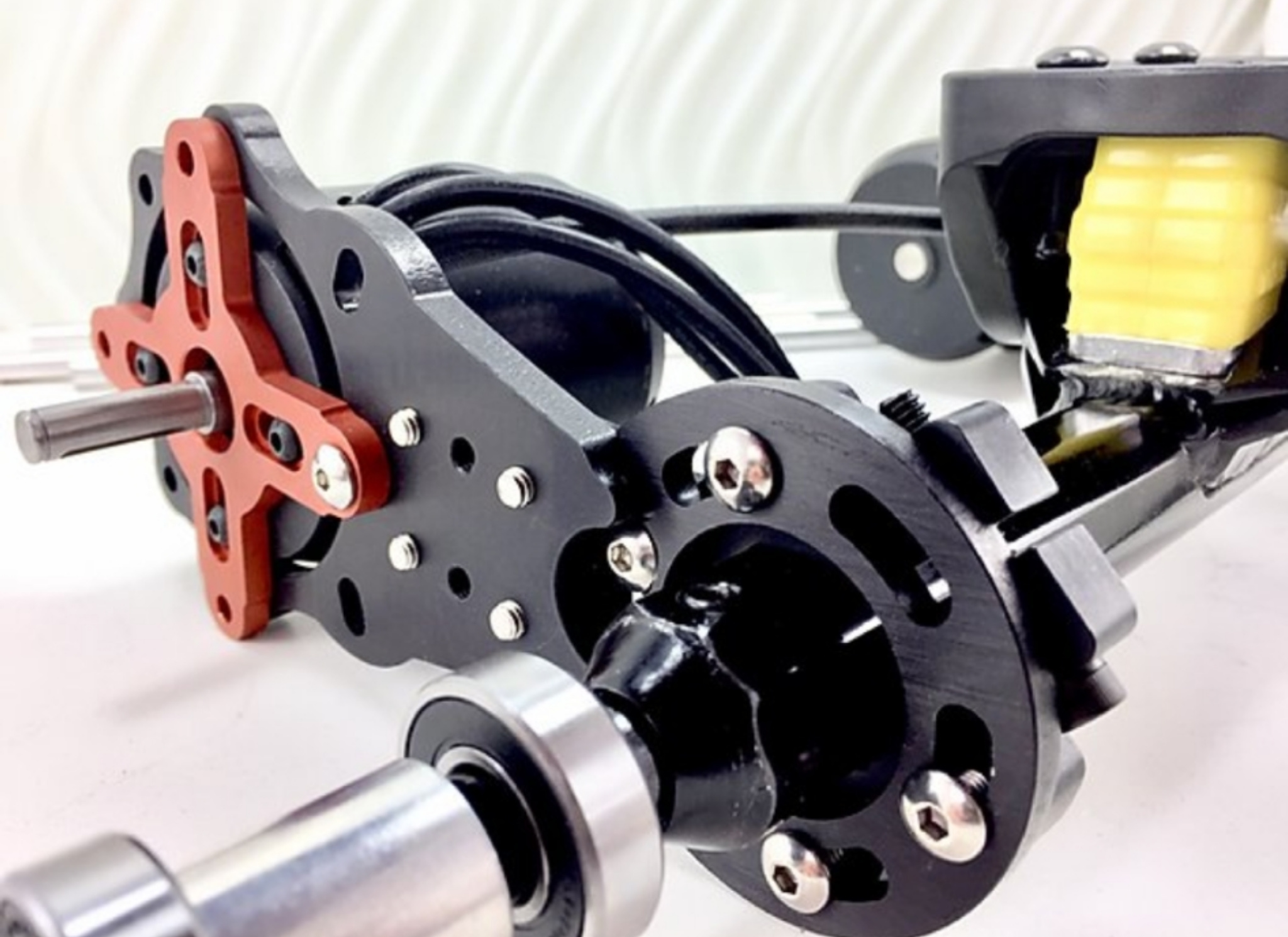

Nope, its correct like that
Oh dang thats weird. Bc check this fit
Id rather not have to get new mounts bc these are awesome and fit my matrix one trucks which are hard to find clamps for
