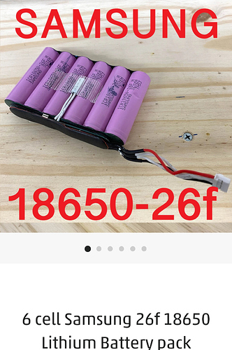

Would it be possible for a Canadian (me) to buy batteries off a vendor that only deals in the USA, have them shipped to an American (you) and have them forward it to me? Is that even viable?
Context: I wanna buy from jehu
@Flasher I’ve had some Canadians treat me really right on multiple occasions. If you’ve got a way to provide the label to re-ship I’d be glad to help you out and pay it forward. Seems expensive, though.
@abusfullofnuns I don’t have a way of relabelling as I deal through Canada Post here. They take over services like USPS but they do not cross borders. It’s for either 20 items or 44 (still undecided)
Have you checked the shipping? Usps for some trucks and motor mounts was like $40 when I checked last week.
Edit: I’ll help you either way, but you better be sure on the shipping. I was shocked at the rates.
