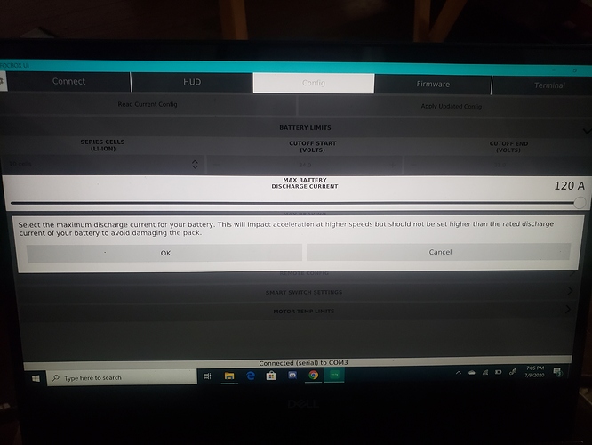

Anybody have any idea what’s causing this?
Phase wires are all good. In the video I am using the remote.
Only one motor is stuttering
Swap the motor cables from one side of the unity to the other and see if the issue follows the motor or the esc port.
Have you used those motors before?
I just did that and both motors worked great that way. Weird
Probably a bad connection somewhere. Double check to make sure.
I’m not sure what it was, but I switch them back to the I want them and everything is working great now
