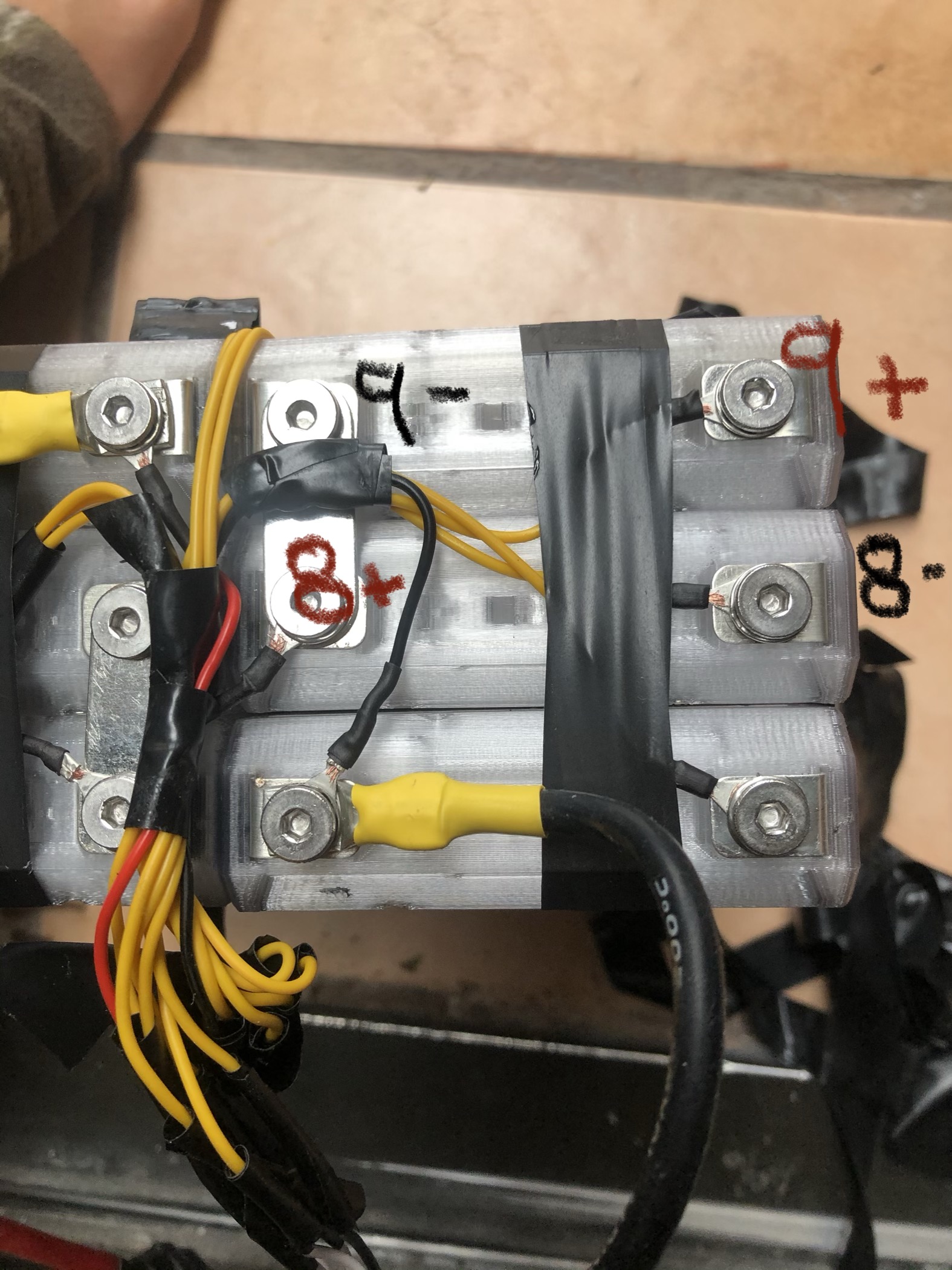

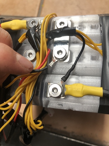

If those are 0.66V and 0.72V then that battery has to come apart. :frowning:
I’m screwed, I think I can never finish a construction
Might be the actual balance leads are screwed too. But in any case that battery has to be opened

must be the cables, otherwise it would not have the voltage of 42.5
I agree, but you have to find out for sure what the root cause is
Just proceed carefully and thoughtfully so hopefully the problem can be fixed without junking an expensive battery or burning anything down.

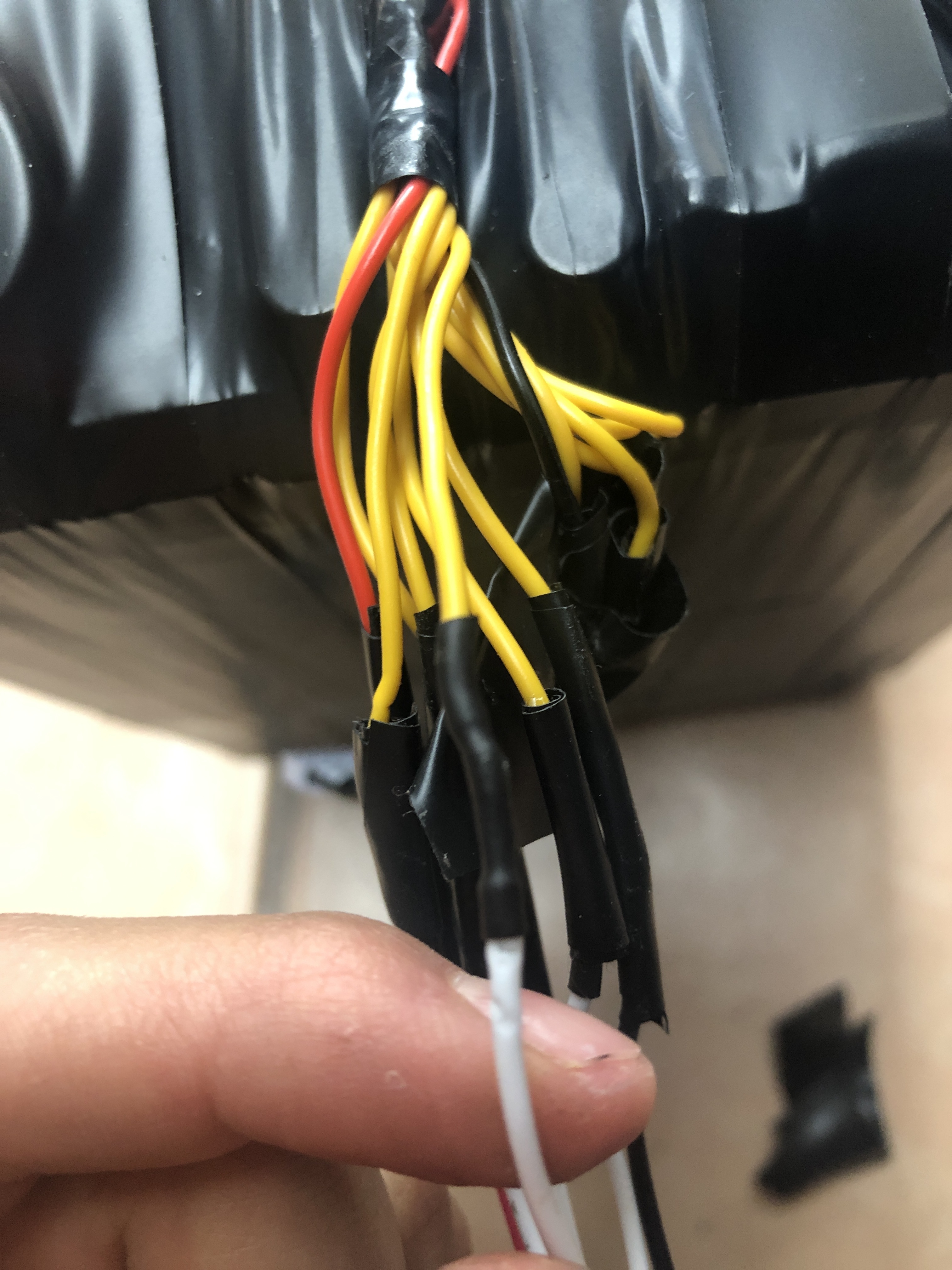

Also, get some heatshrink to put on that boy

8 and 9 is ok I think I will need to unwrap it
ouch
Remember only work on one wire at a time. Completely insulate it and be done with it before getting into the next wire.
Unfortunately, batteries must be serviced “hot” as you cannot “turn the switch off” while working on it.
And yes that’s probably definitely the issue. Those need to be soldered together with nice non-cold solder joints. My bet is on those wires are twisted together in there.
the problem now is that I end up with two rolls of duct tape Jajajaja
Heatshrink.
Tape: hours of unrolling
Heatshrink: snip snip

Should I try checking the voltages here?
