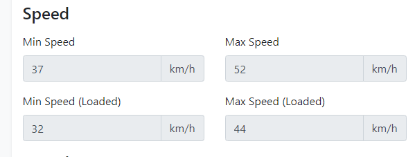

feel like a idiot here lol. Trying to calculate what kv and gear ratio I need for my drive upgrade. But there is no calculators that works just with gear ratio. I know the ratio but I have no idea how many teeths the gears have.
Its a Trampa setup so 198mm wheels and looking at the Fatboy SS mini
If you only know the gear ratio, than put 1 for motor pulley and 2.57 or whatever the gear ratio is in the wheel pulley box. You can use the calculator linked in the top bar of this site.
well shit that was simple :joy: dunno why I didn’t think of this haha well then what I thought was wrong is in fact correct. 82km/h loaded speed haha might need to go down on kv.
Thanks! :slight_smile:

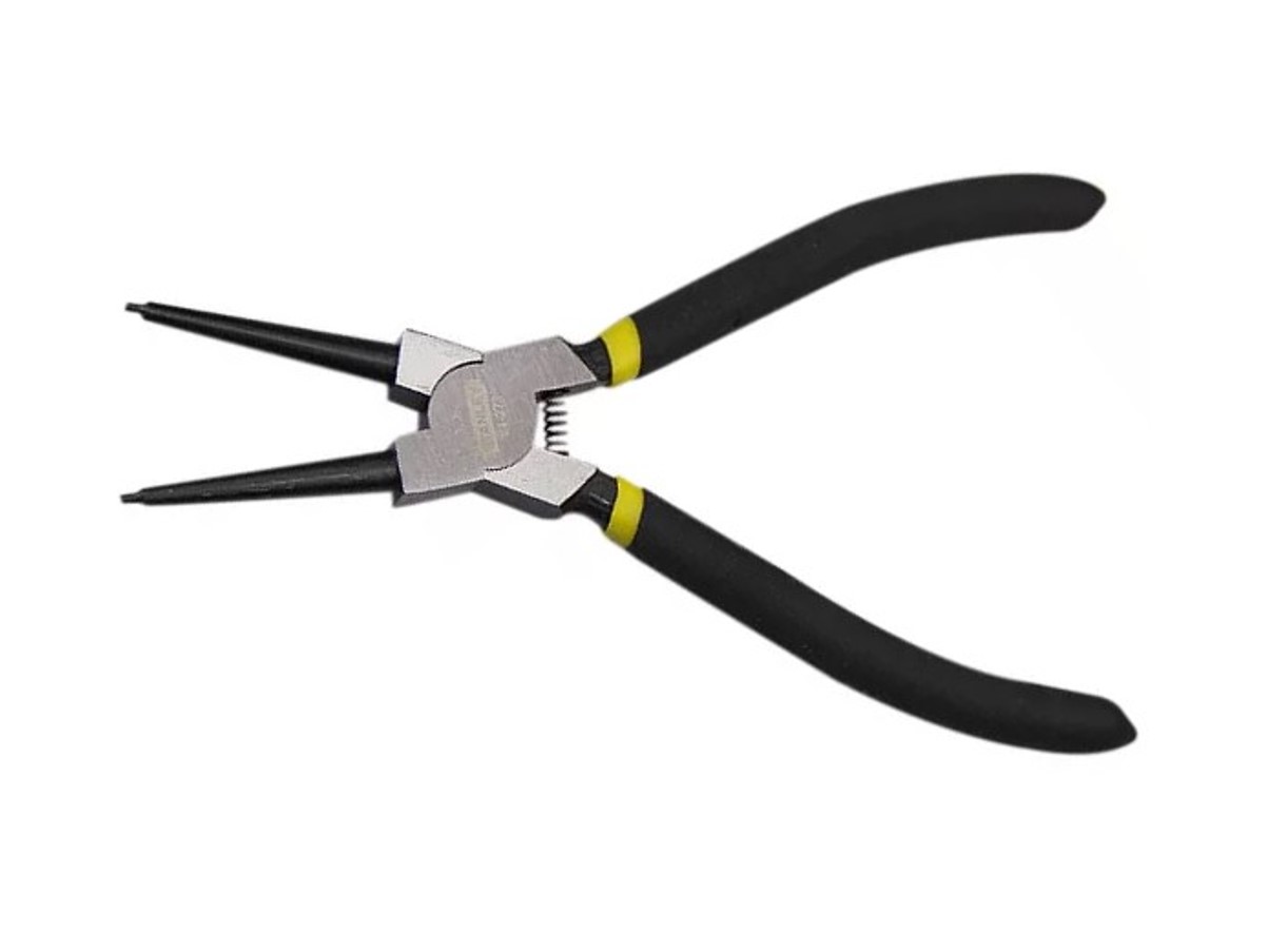

I’m pretty sure this has been asked before, but I don’t know what the name of this… How do I remove this thing there on the shaft?
C clip / Circlip / Sprengring
circlip-pliers-bent-internal-bent-external-7
You need to use circlip pliers to get those on and off.
PROTIP: do not stretch them
  • more than you need to to slide them on the axle
  • for longer than you need to to install or remove them
unless you want to buy more because they are stretched out now and broken. They are not like springs :crazy_face:

how is the loaded speed calculated? which weight?
