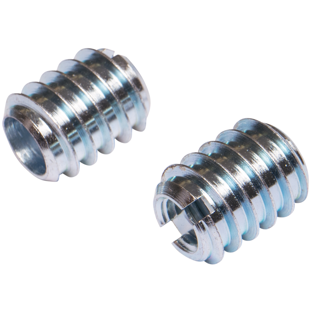

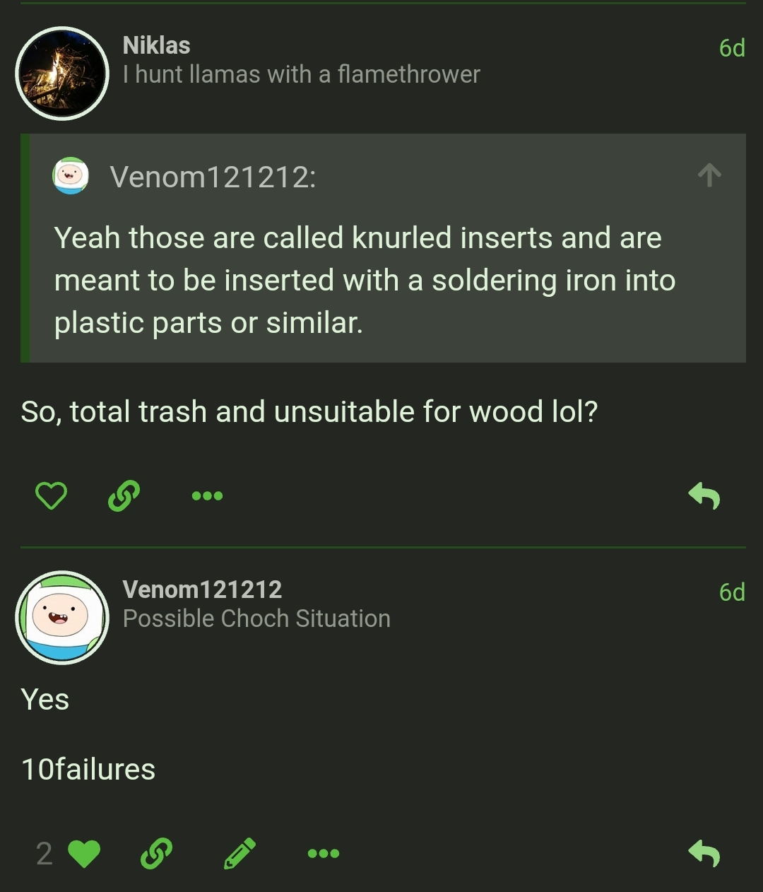

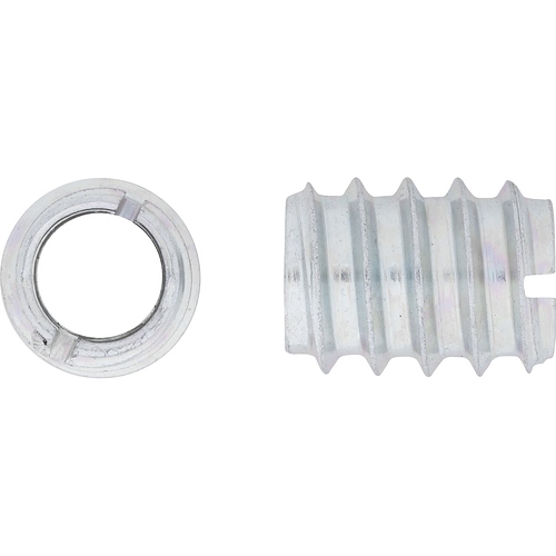

In that case, yeah I would definitely go with the 10€ ones. That’s a pretty reasonable for a pack of good quality stainless inserts in my opinion, especially in a physical store rather than online.
Hell, I just checked McMaster and a matching insert there is $2.73 each. So 1€ a piece isn’t so crazy.

i paid 2€ for an 8 pack of Zink Inserts
Dude where??? :star_struck:
Obi as always ^^
You mix hardener and binder 1:1 right? @b264
Is it okay to accelerate the hardening with warm air?
It said 1,5h and after over 2 hours now, the inserts still can be moved around in the hole
It depends which epoxy you have.
If you’re looking to accelerate hardening, then I think you might want to revisit your procedure.
Yes, warm air will accelerate it, but if you need that, then there is a separate problem that will probably still bite you in the end. So work on whatever problem that is :rofl:
If you’re dying to ride a skate and you can’t wait 2 days for epoxy to cure, then you’re also not going to wait for Loctite to cure, and you’re also going to break the skate and need to repair it. So I would weigh on the repair process whether or not you wish to break it in the first place.
I would wait 24 hours minimum on ANY epoxy, 48 hours is better
but after a few hours you can handle it, just don’t ride it

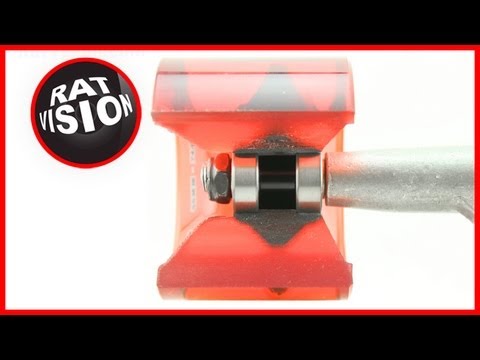

You guys reckon its crucial to include the spacer in between the bearing in front wheels? Mine just make a racket and the bearings have no way of falling inside as there’s a lip to stop them.

Yes, not having a spacer in there will cause unnecessary axial loads on the bearings when you torque down the wheel nuts.
