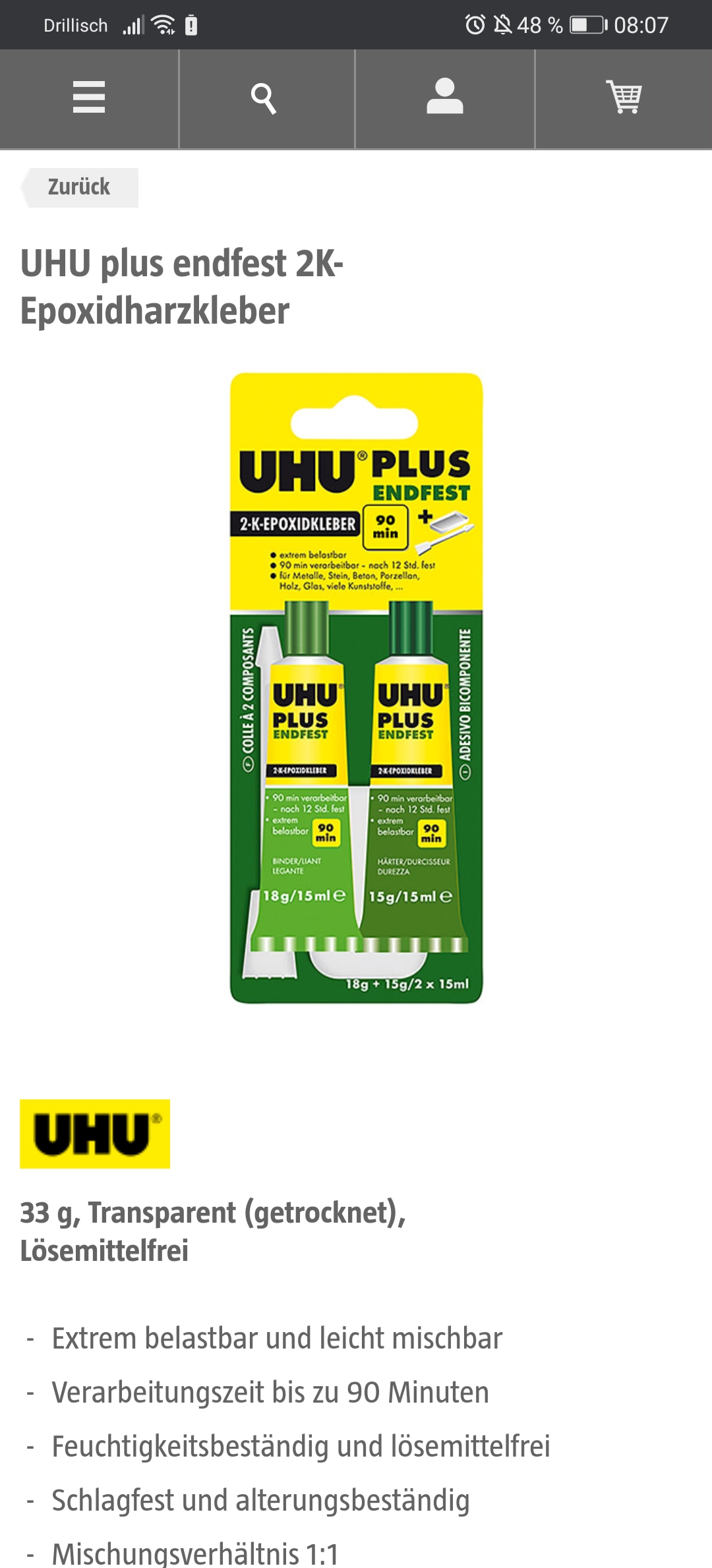

Is this good for glueing wooden inserts into my deck?
https://www.bauhaus.info/2-komponentenkleber/uhu-plus-endfest-2k-epoxidharzkleber/p/15358496
It says 2 component adhesive and that the mixing ration is 1:1
@b264
It looks like it would work, yes.
My German is a little rusty but it looks good,
Try it in a scrap piece of wood first though
Alright, thanks!!!

I want one that takes 1,5h to dry and is very hard by then, not the 5min drying one, right?

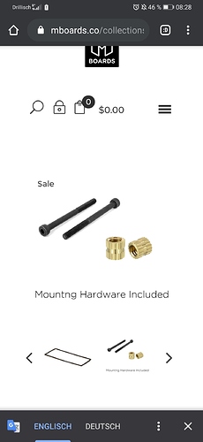

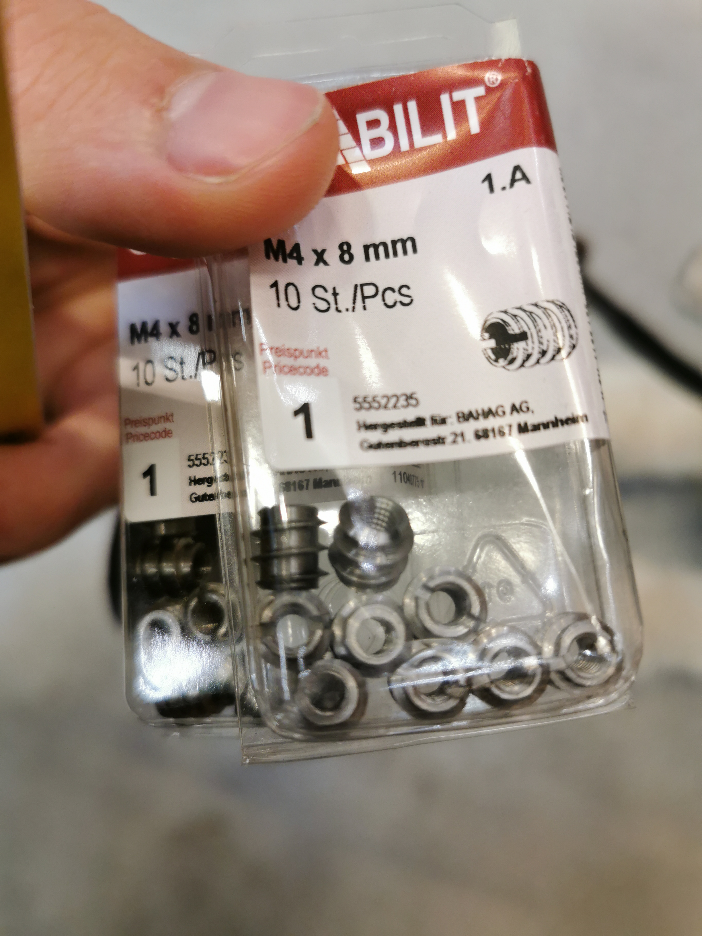

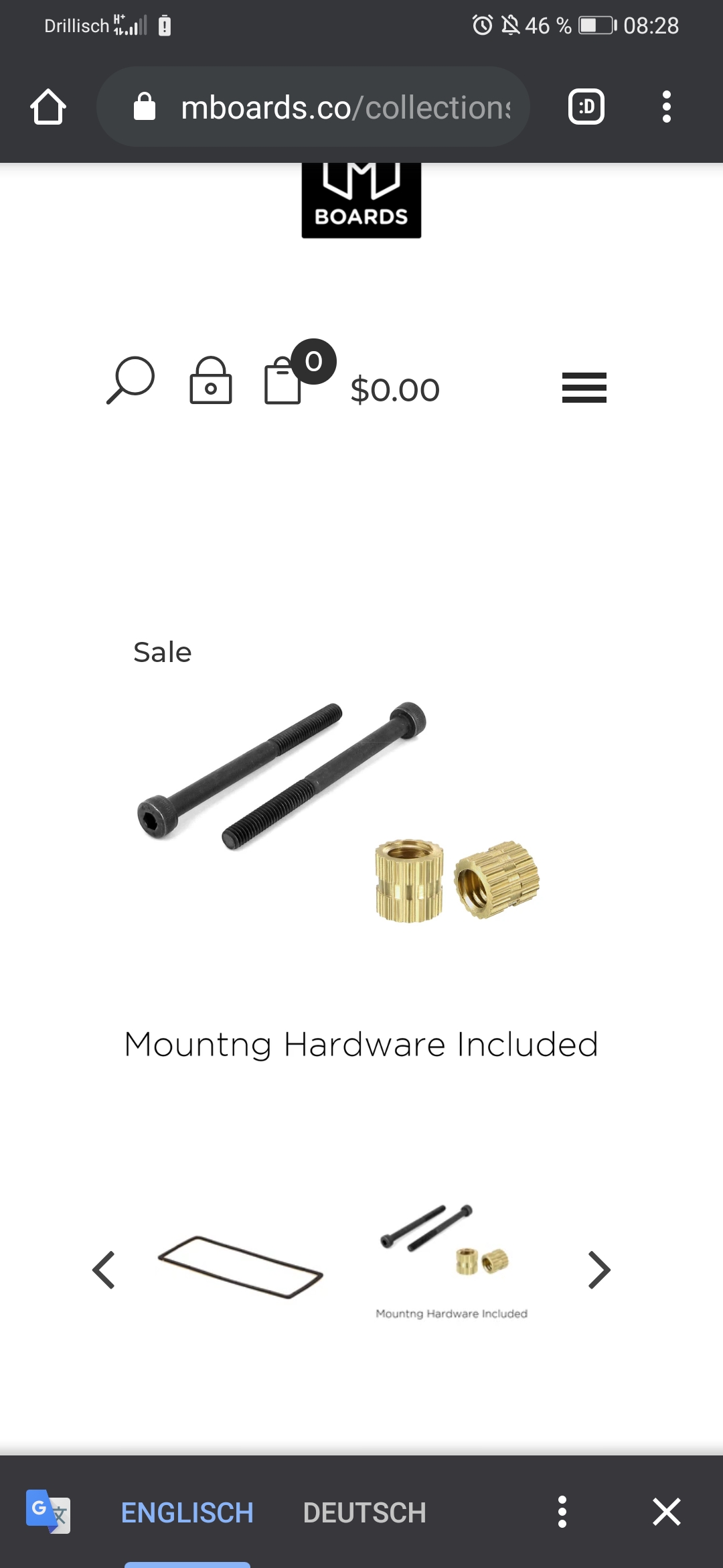

Are these inserts worth the extra 10€ over the ones my enclosure came with:

Yes, long cure times generally result in stronger epoxies, and also give them more time to wick into all the tiny spaces in the parts to be glued, for better adhesion.
Depends on the application. The inserts in the top picture are designed to be inserted into wood or similar. The bottom ones are designed to be used in plastic.
Putting them into my deck :sweat_smile:
I hope it will be fine with the plastic ones… 10€ for this seems a bit high ^^
Epoxy doesn’t dry, it cures. One-part glue dries. Two-part epoxy (two liquids you mix together) cures in a chemical reaction, not an evaporation.
You want the longest curing one you can find. Never “quick” or a “5 minute” epoxy, those are not good. Convenient, but not good.
