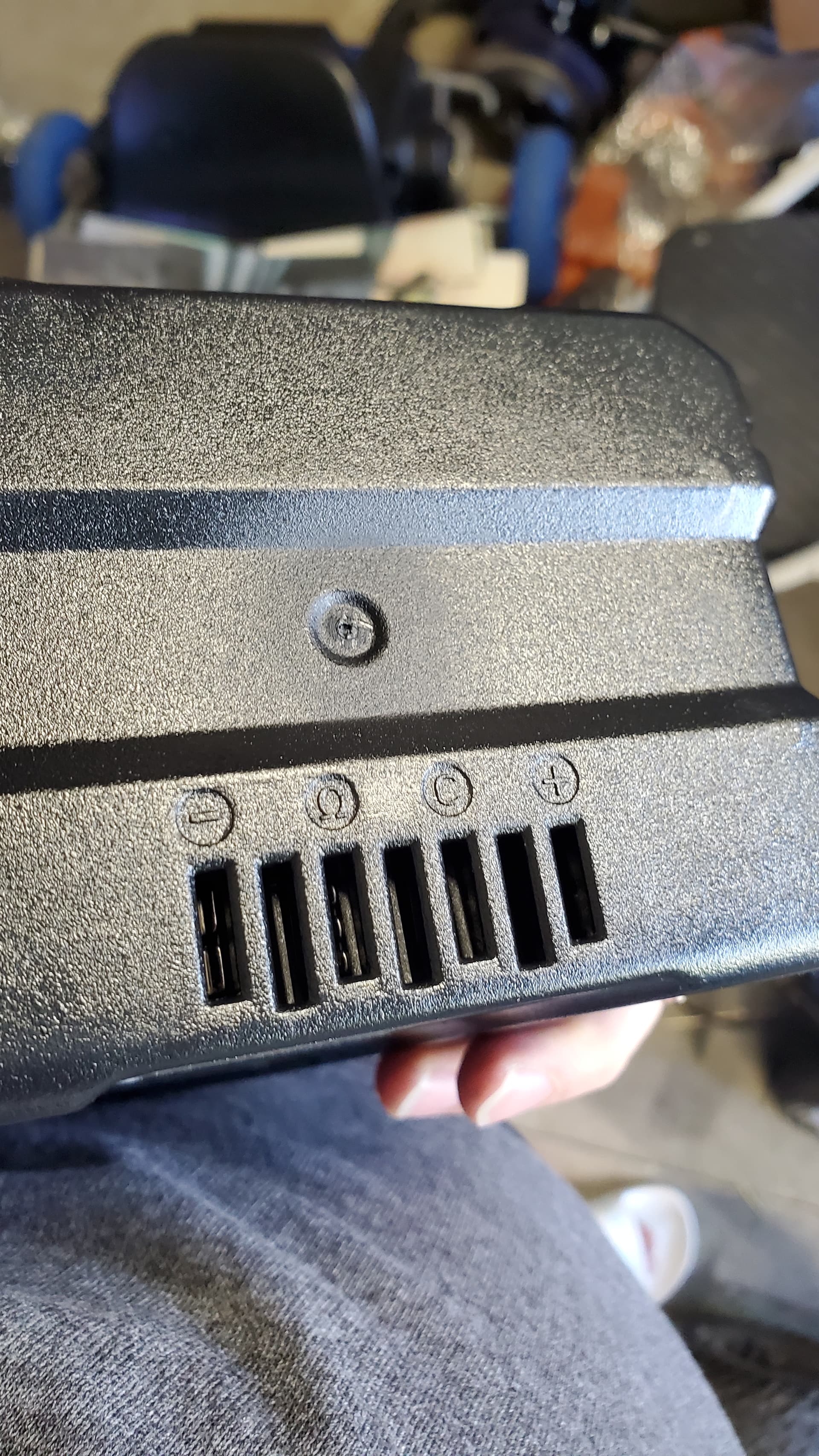

Anybody who’s fucked around with tool batteries got guesses as to what the resistance and c are doing? C maybe continuity? Ohms symbol is resistance so maybe a thermistor?
Oh dude these things are so annoying
I couldn’t even figure out how to manually charge my ryobi ones, there’s a different voltage across the C, don’t know exactly how it works but there is some kind of check that happens before it’s allowed to charge. The BMS won’t even let the battery charge if you just hook up to pos and neg
