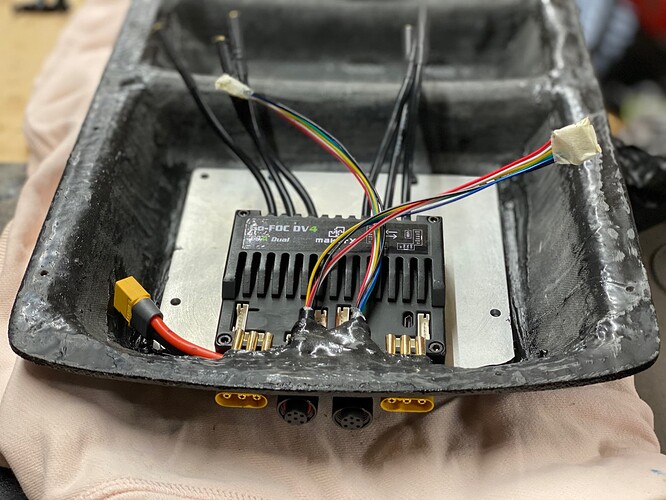

This is why I fuckin hate jst’s. They’re convenient only in theory.
In practice, 100% of the time the connector requires a bigger hole than the wires would, which leaves you with the options of “bigger hole, figure out how to seal it” or “redo the connector every fucking time you need to swap something involving it” and I hate both those options.
Do bullet connectors that small even exist? If so we could just chop em, add bullets, and easily reattach the connector inside the enclosure wall. That’d be dope. /Endrant

Epoxy to the enclosure and crimp inside to jst to plug into esc. Cut off external jst from motor sensor wires and solder splice wires onto the external plug.
Those look great but here’s the thing: i hate soldering. I know that doesn’t mesh with my current lifestyle choices but it’s still true. I hate it so much. The smaller the thing, the more I hate soldering it.
If I was going that route, however, I’m usually running low enough specs that I could go 9 pin higo connector and skip the second hole for phases. Higo’s are “do the hard thing once and never do it again,” which fits my kinda lazy, and so I constantly contemplate switching all my shit over to them.
