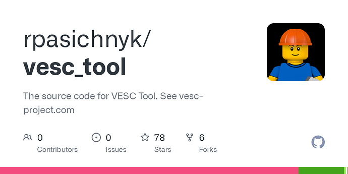

Stupid question… I can’t seem to figure out how to connect vesc tool on my windows laptop to stormcore. I can pair the bluetooth but stormcore doesn’t show up in the tool
Use this vesc tool. Bluetooth works on Windows with this one.
Don’t connect the esc directly to the computer.
Go to the vesc tool connection tab > bluetooth le > press the scan button > select your esc > connect.
Thanks confirming official version of vesc tool doesn’t work with bluetooth?
Seem kinda a silly bug.
AFAIK, vesc tool 3.0 (fw5.2) has buggy BT
Worked like a charm. Much appreciated
