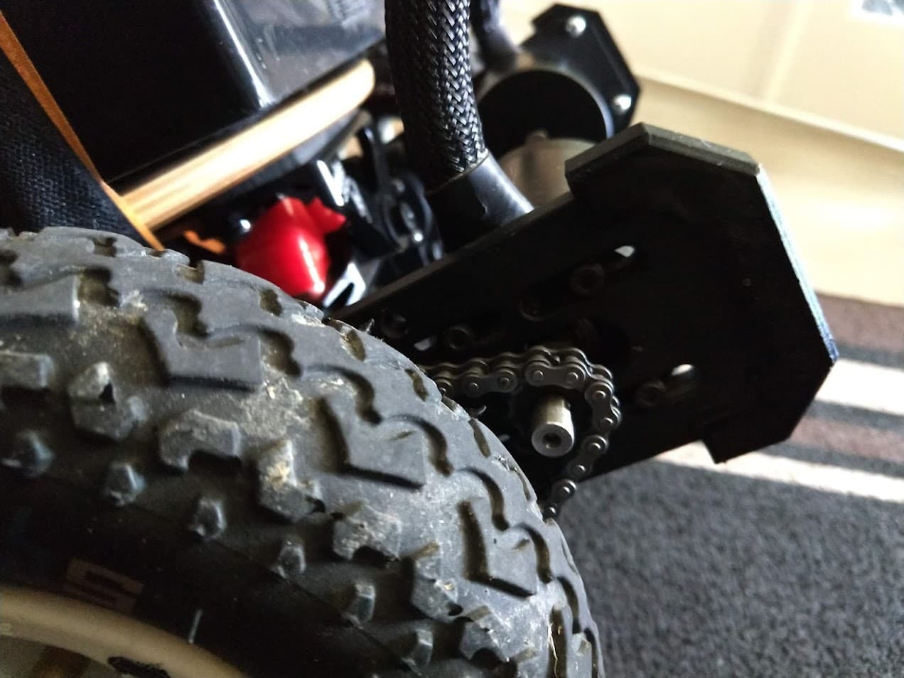

How do y’all retension motors? I need to retension this one, but it is impossible for me to reach the two inner screws without deflating the tire all the way. The distance from tire to mount is also too short to use allen keys without deflating the tire either. So far I’ve sucked it up and deflated the tire so I can fully remove the screw and reapply loctite, but I’m curious if anyone has any easier ideas.
maybe you could cut off the tip of the allen key so that it’s shorter? With belts I just take the wheel off, but I’m guessing that doesn’t work for chains. I can’t quite tell, but maybe a ball-end key could fit at an angle?
Yeah belts you could stretch and slide over the side wall, but chains are kind of fixed onto the sprocket. A ball end might work, but once the screw starts backing out I think I’m going to run into clearance issues again.
