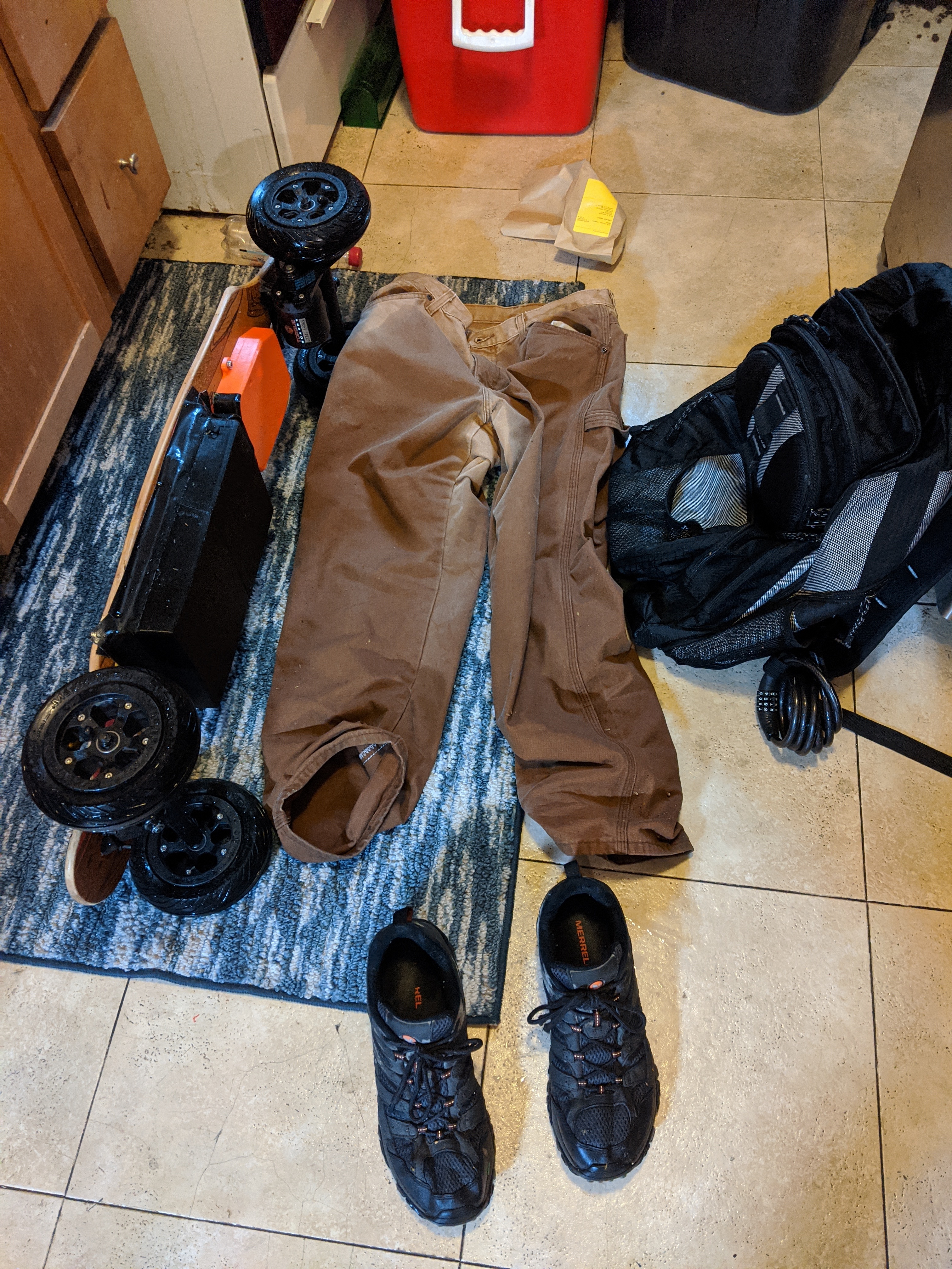

Just answered my own question on if my esk8 was waterproof… Well me plus the storm rolling through right now and the answer is so far yes as long as I seal things up with some duct tape:
I’m just guessing the sensors in the motor were protected too though I think TB does add epoxy to “battle harden” them
Would definitely be worth having “mud flaps” or some sort of thing to block the rain around the wheels have seen a couple designs but might dig more into that.
I coated the metal exposed parts of everything but for the mosfets tried to leave them mostly with the black package exposed to the air so it can dissipate heat efficiently just road in a thunderstorm and everything is okay but my electronics enclosure is pretty snug on the deck too (no rubber seal or anything but not any big gaps for a water droplet to easily get in either).

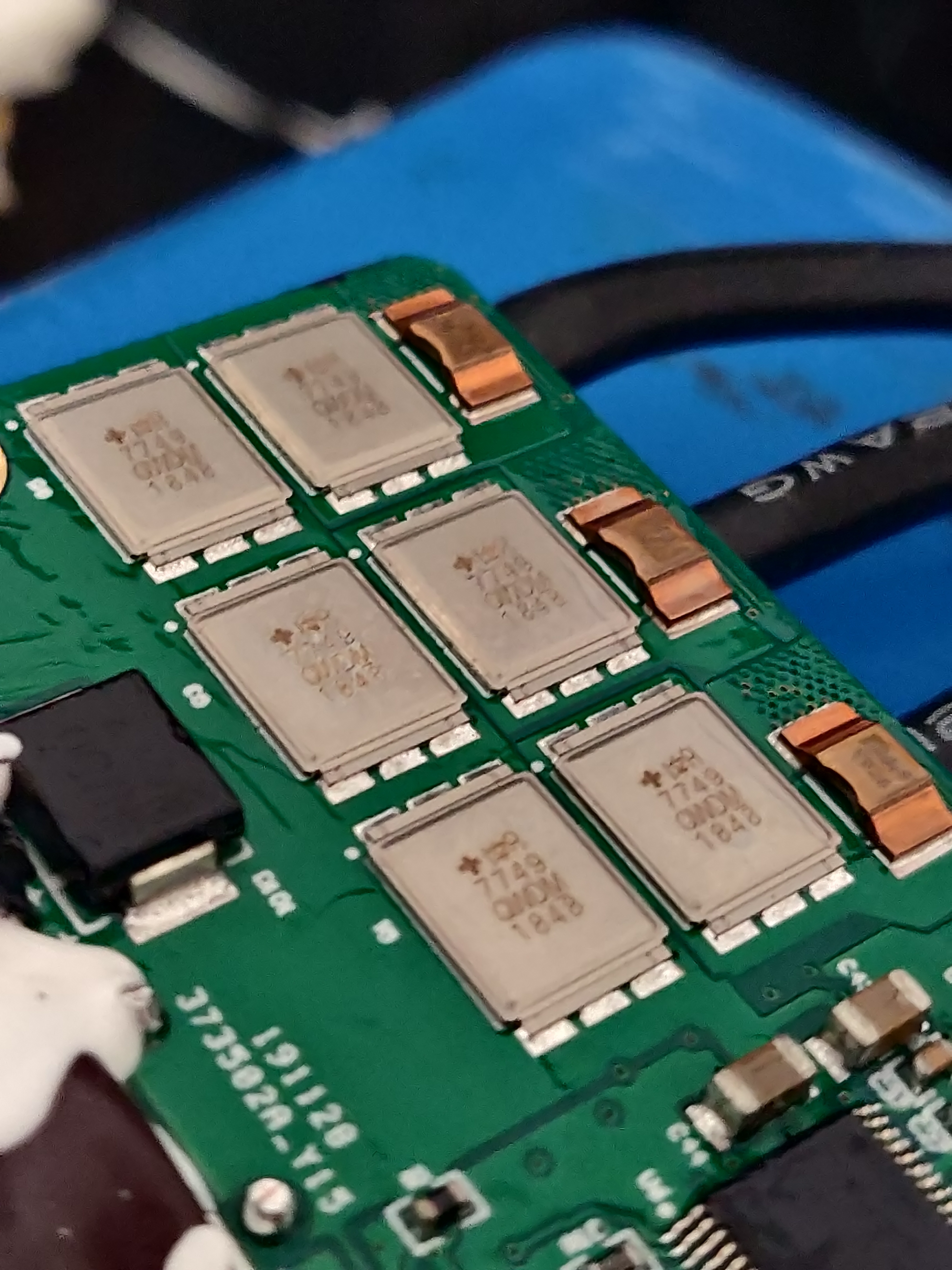

What about directfet?
Just read a post on the forsaken place. Heat transfer obviously will be hindered by it so maybe i coat everything around it except the top plate
which esc is that
Jedbox
Not sure really I would guess coating the contacts is good enough to avoid a short there but might still be good to coat the whole thing with 1 layer at least just to avoid corrosion of the package/heatsink part.
Jedbox is by @jeffwuneo aka scam?
Si Senior
Do you know if the 4.12 version had direct FETs too?
both have directfets, yes.
