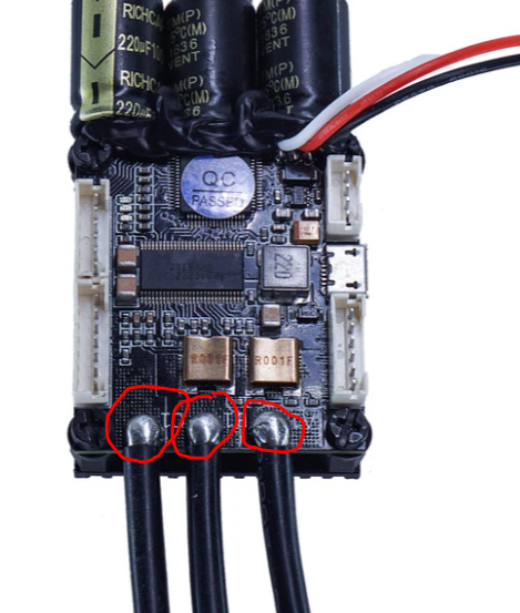

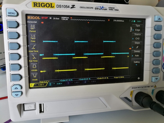

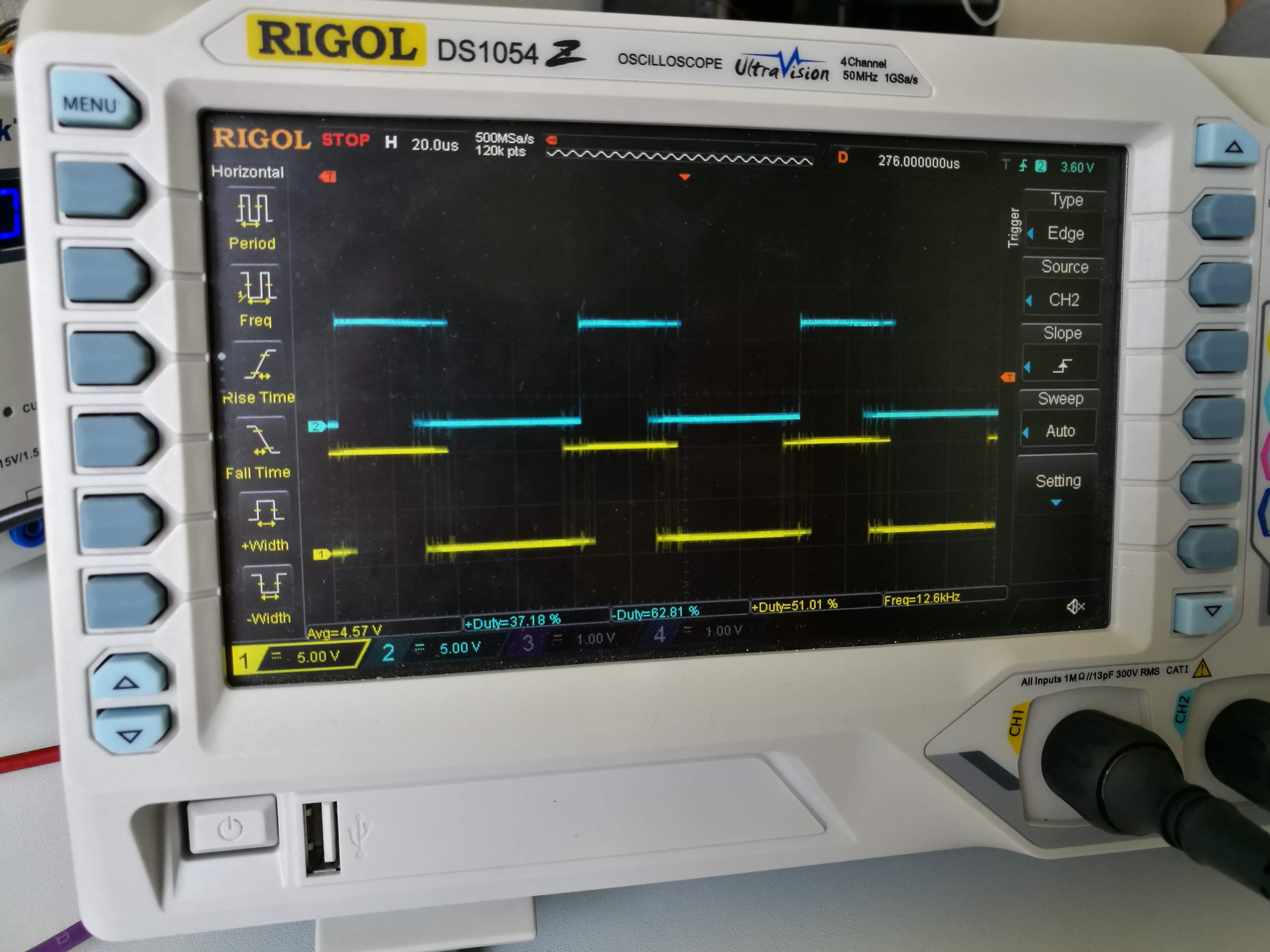

Did anyone else look at the commutation in an oscilloscope when using FOC? I see block waves but there should be sine waves :((
hi…
I’m a complete n00b on 'lectrical shit, but where did you plug your leads in, on the phase wires or the sensors…???
The phase wires!
Do you have images of that?
It may be the current that is sinusoidial and not the voltage.
The FETs are extremely inefficient in analog mode, they must be used digitally. The pulses are timed to approximate sine waves but I haven’t looked at it on an oscilloscope. I have looked at the PWM servo signals though
I put the probes to these things.
Ohh now when I “zoom out” I see sine waves so I guess it makes sense then!
Thanks!
Do you have an image from the oscilloscope to share with us? :grin:
Oh haha, will get one soon!

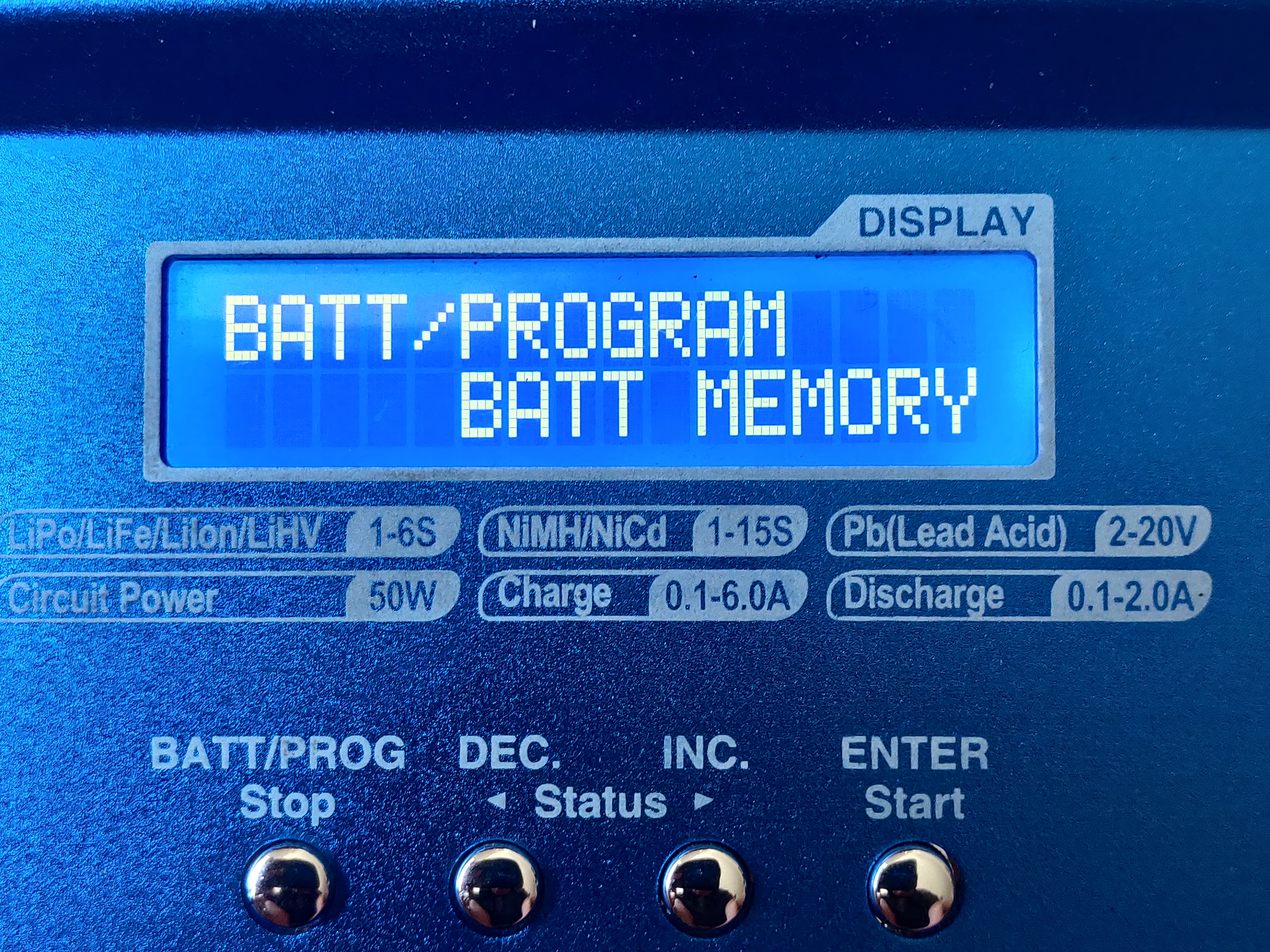

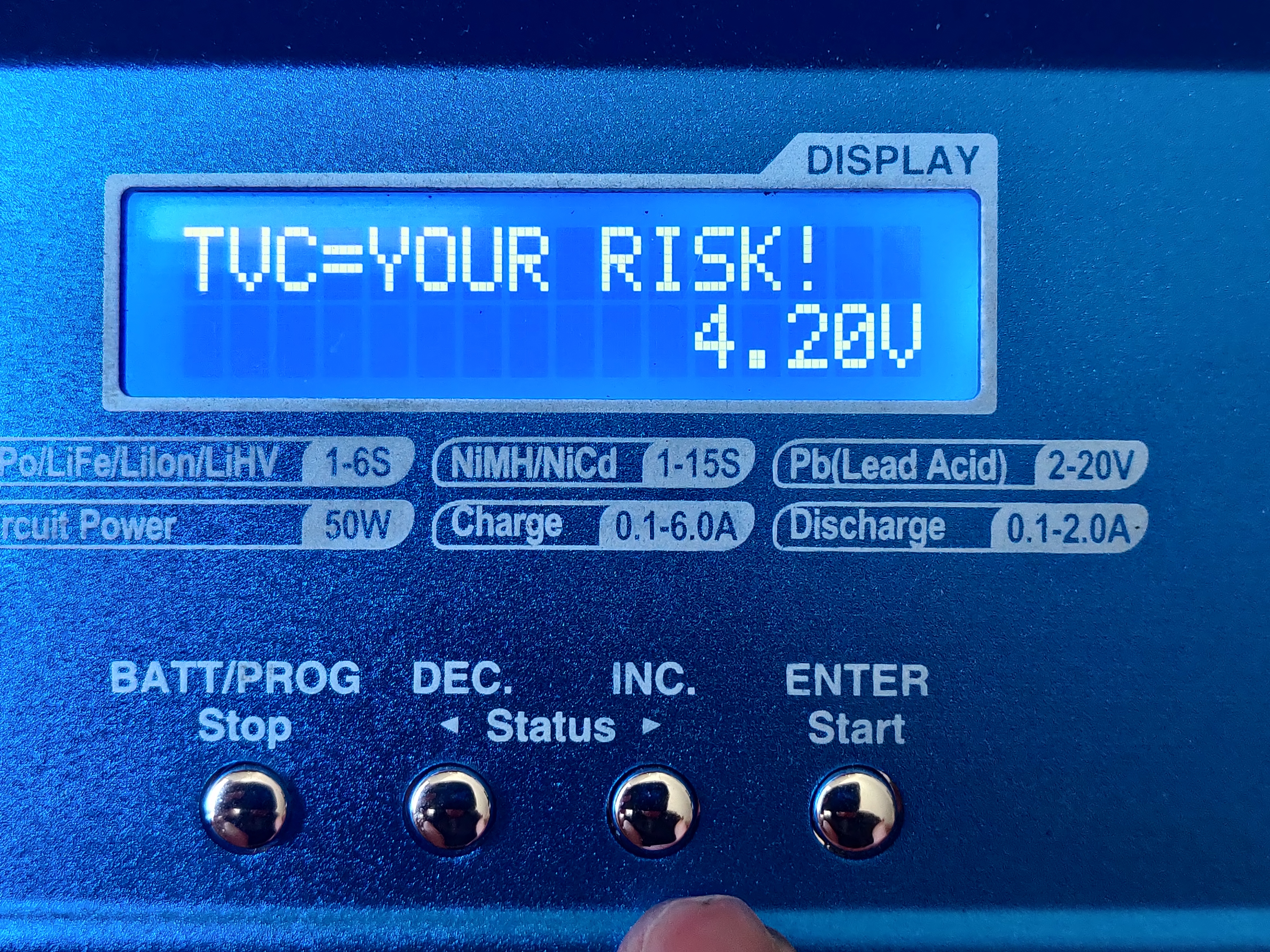

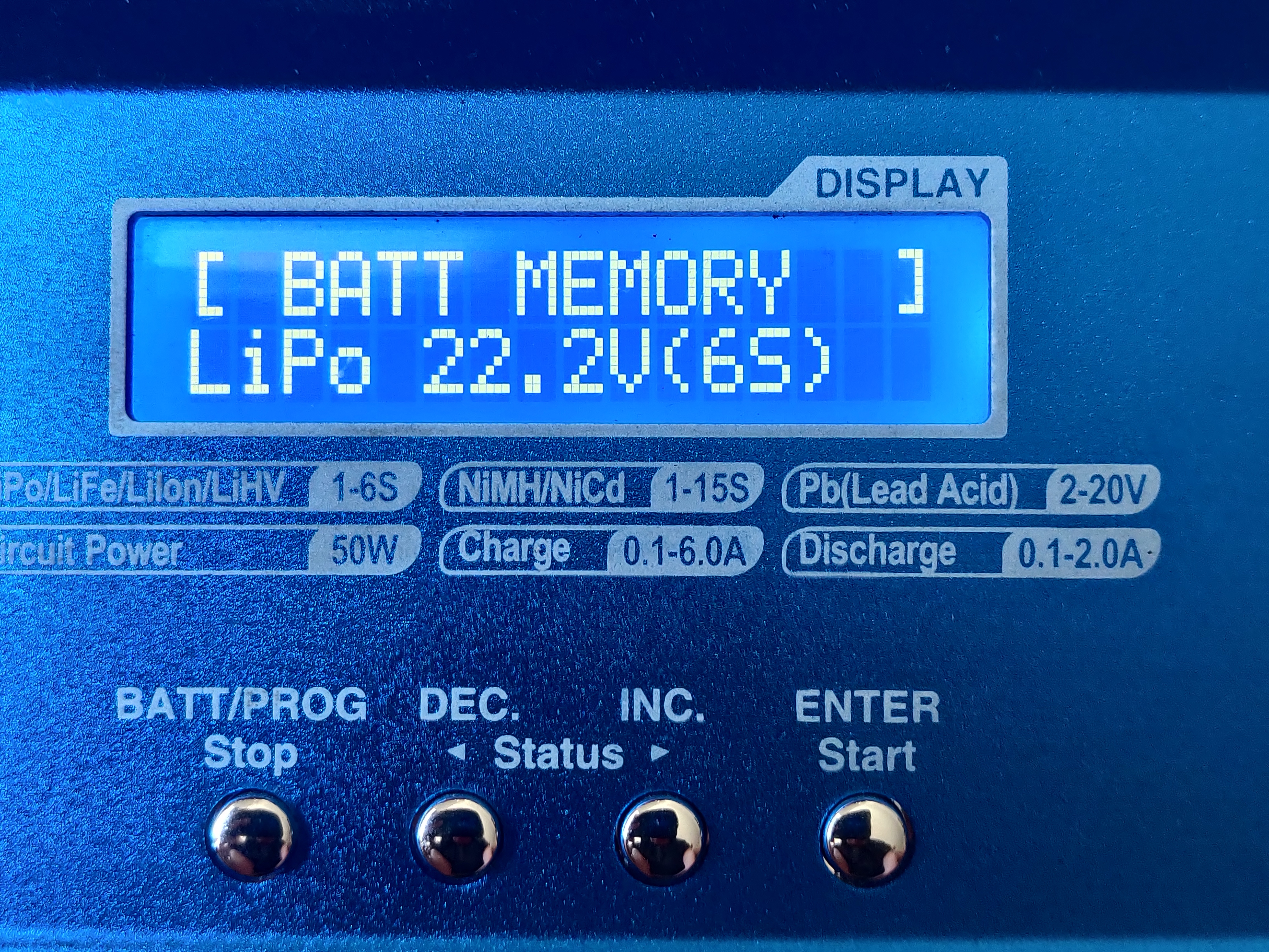

how do people preserve their lipo batteries by charging only to 4.15 instead of full? Do they modify the capacity cutoff on the balance charger? So instead of 10000mAh I’d tell it to stop at 9880mAh?
Most hobbychargers are able to be set to a certain end voltage.
If you don’t have a hobby charger, most regular chargers have potentiometers to dial in the max voltage
Ah well the iMax b6 twins is special then. No such settings, and I don’t remember seeing a potentiometer during disassembly. Could the mAh cutoff be tested safely?
the Imax b6 has a limiter, although the minimum is 4.18v
Go to Batt memory - confirm place 1 - choose battery type and enter - from there press left or right until you get to TVC - YOUR OWN RISK
thats where you set the max charge. One options before you can set the maximum discharge voltage
