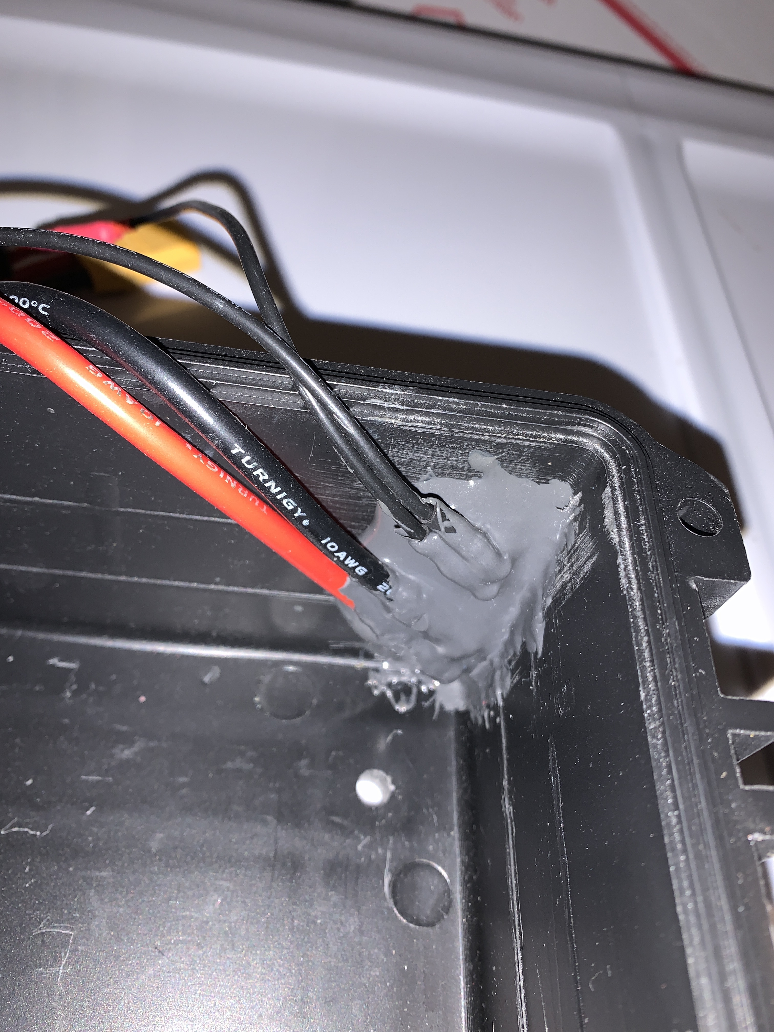

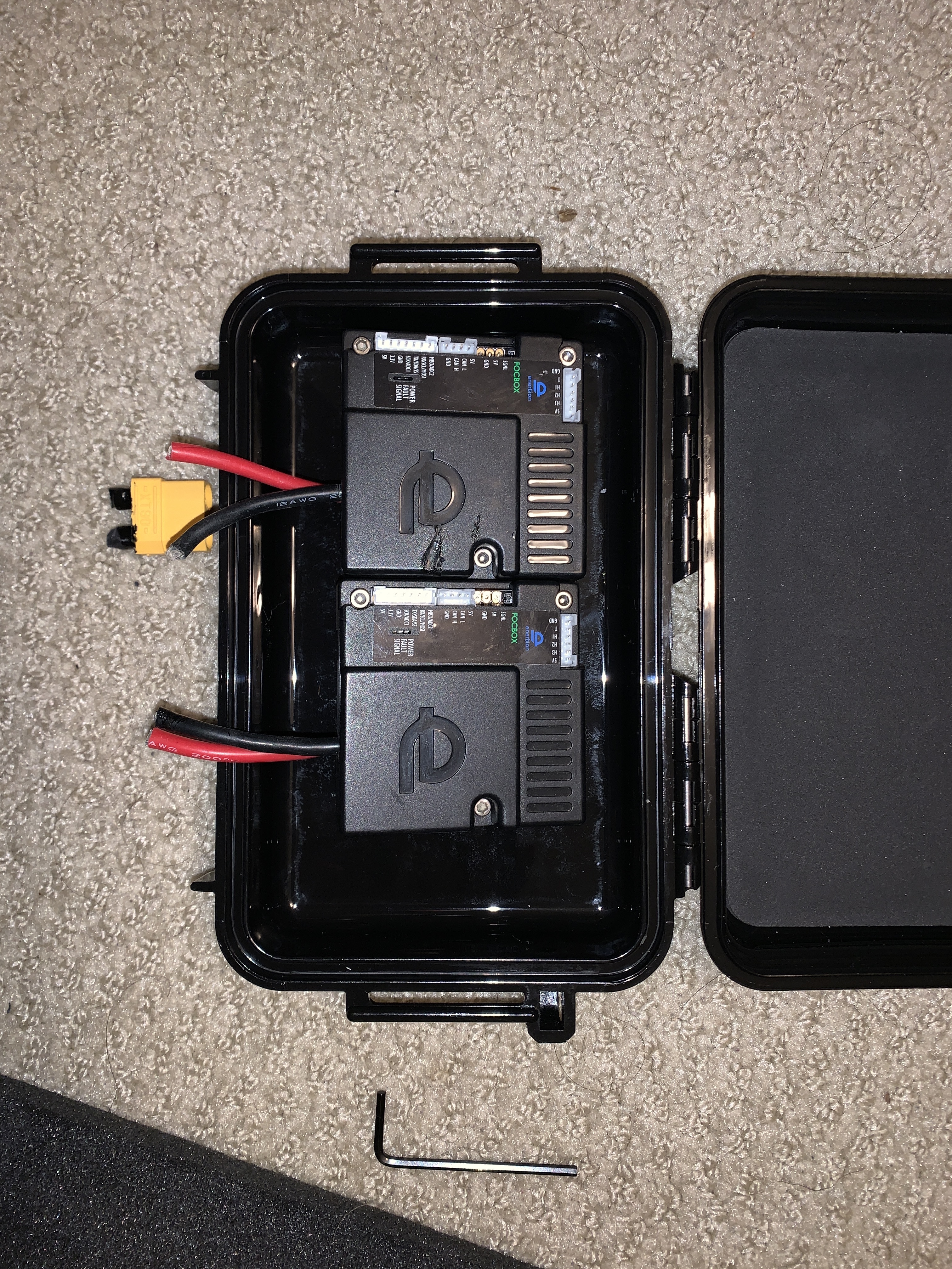

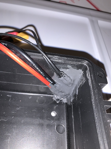

How should I do the power leads on this? For lack of option I am thinking I solder the leads of the FocBoxes end to end over a XT90 and have a T connection that gets JB Welded through a hole where the vent was, but that sounds awful
The guy who sold me these completely fucked up the wires on this so I desoldered the phase leads so I can reterminate in fresh 14 awg with an MR60 and removed the PWM leads because I’ll use UART and CAN anyway (they were all frayed and damaged)…but I can’t remove the power leads since they are covered in silicone and wedged between the capacitors so I had to cut the XT and bullets (god forbid he use the same connector) to get to clean wire
Ideally the input XT90 sits aligned with the loose one so that I can run the wires through the foot bindings but the middle works too
I would epoxy a male (with the two pins, not the two holes) XT60 into a hole in the side of the enclosure, and solder the ESC power leads to that.
One XT60 is enough? It’s a 12s7p 30Q, 6384s, and MTB chassis
What Brian said. And if you need more room for wire than the XT60/XT90 offers, I’d suggest maybe adding a small chunk of copper bus bar to the XT60/XT90, to give you enough room to solder all the wires to.
I’d say go with an XT90 for dual if you’re gonna be pulling more than say 50A for more than a quick sprint up a hill, but honestly it’s all up to your preference. I like big connectors if I have room.

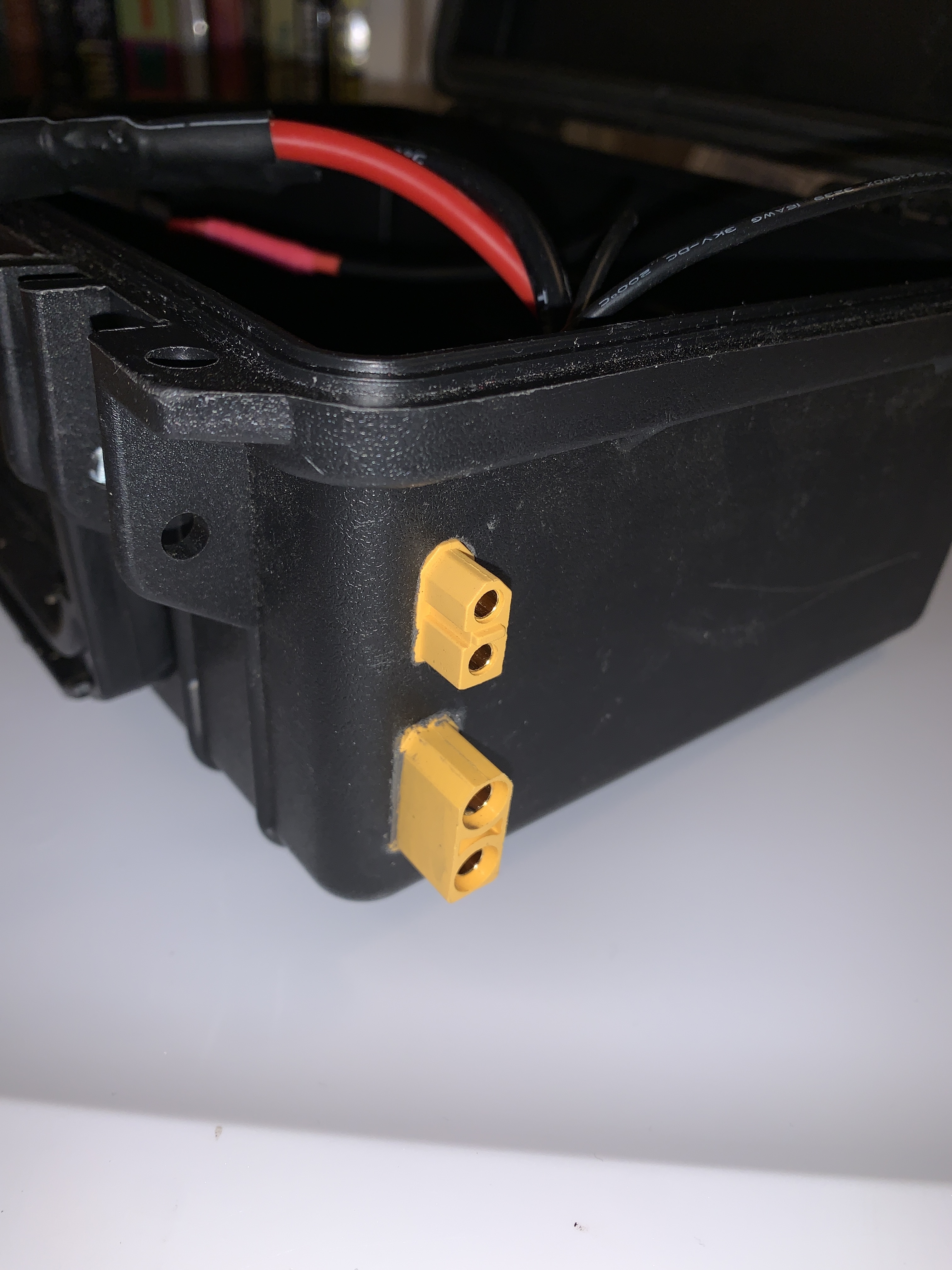

Like this job? (It’s the battery case)
Opposite connector though
