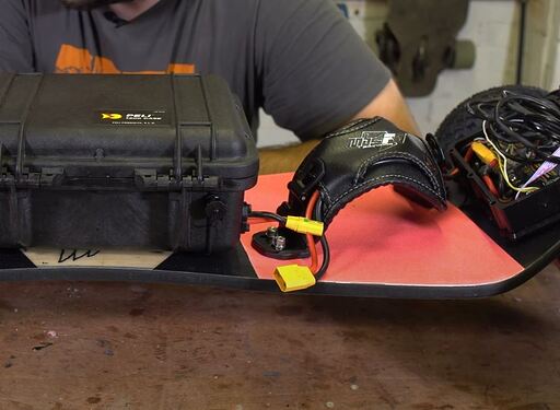

I found out that someone doesn’t use loopkeys. Just xt90s on the end of the battery as “switch”, is there reason why to do that instead of loopkeys?
vid:
That basically is a loopkey, just less refined.
so its equal safe as loopkey on positive wire?
a loopkey is just a fast way to physically disconnect the battery and esc, most people that uses under deck enclosure does not have wires running from battery to esc exposed, so a loopkey is made for that.
for mtb, most have top mount battery box and rear mount esc box, so there are wires running from middle to rear, and if u already have a connector there, then its already a loopkey in a sense
Yes, safety is equal. Function looks more difficult. Appearance, I’ll let you be the judge. Loopkey installations can appear anywhere from terrible to professional grade.

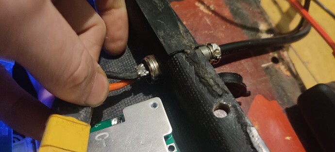

I’ve got no collar pieces or nuts for this.
How do I get charging plug to stick in place?
What goop will hold this socket steady?
Why are circles so… Circle?
Is that a GX16?
If it is, PM me your address I have washers and nuts and can put some in a stamped envelope
But either way, with or without a nut, I would also epoxy it from the inside only. But a nut is strongly preferred
It’s a gx16 yeah but the part coming through to the inside of the enclosure is slightly tapered, I have plastic cable housing for it but it wont catch the threads. I also have some 16mm button nuts that won’t catch the threading either
