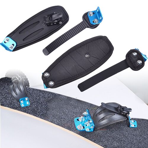

I just bought this as spending 140€ (between taxes and shipping) in mbs F5 (without heel straps lmao) seems excessive to me atm.
Has anyone tried them? Are they too bad? I can cancel the order if you guys think they aren’t worth it. I spent 25€.
