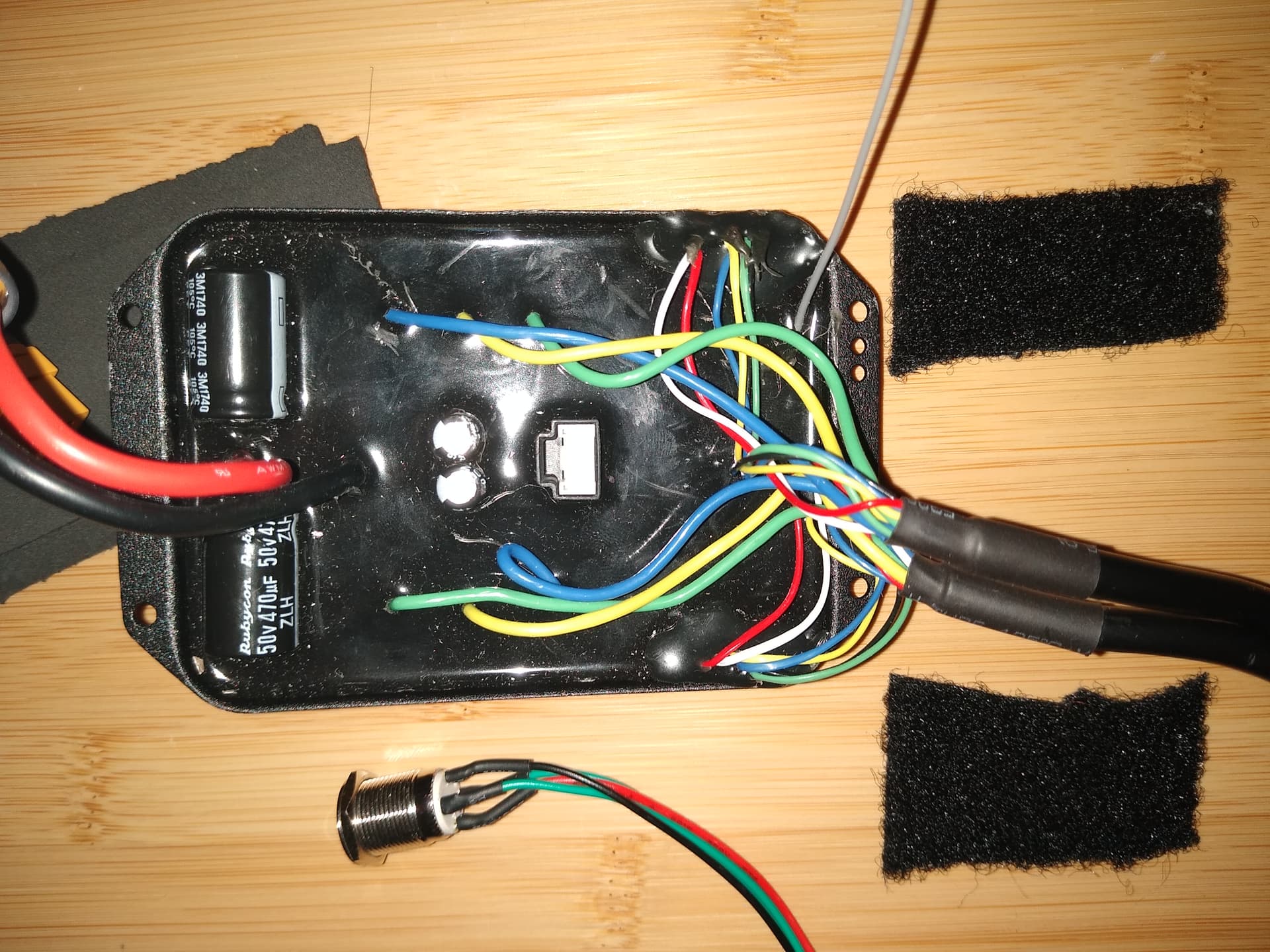

Anyone know how to turn on this random esc from the lot skyarts bought?
Tomorrow the motor connectors are coming off it so speak now.
The 4 pin power button it sort of came with, and a different one I had didn’t turn it on. The right most pin has 37v on it. My guess is it’s broken or the shit remote universal I bought is not compatible. It doesn’t exactly matter since I’ve got 5 single unused vescs at the moment, but I figured I’d try a shit esc to see what I’m missing.
Looks like a Hobbywing to me
Nice, if it works, but now I need a different remote. Maybe I’ll use it someday.
