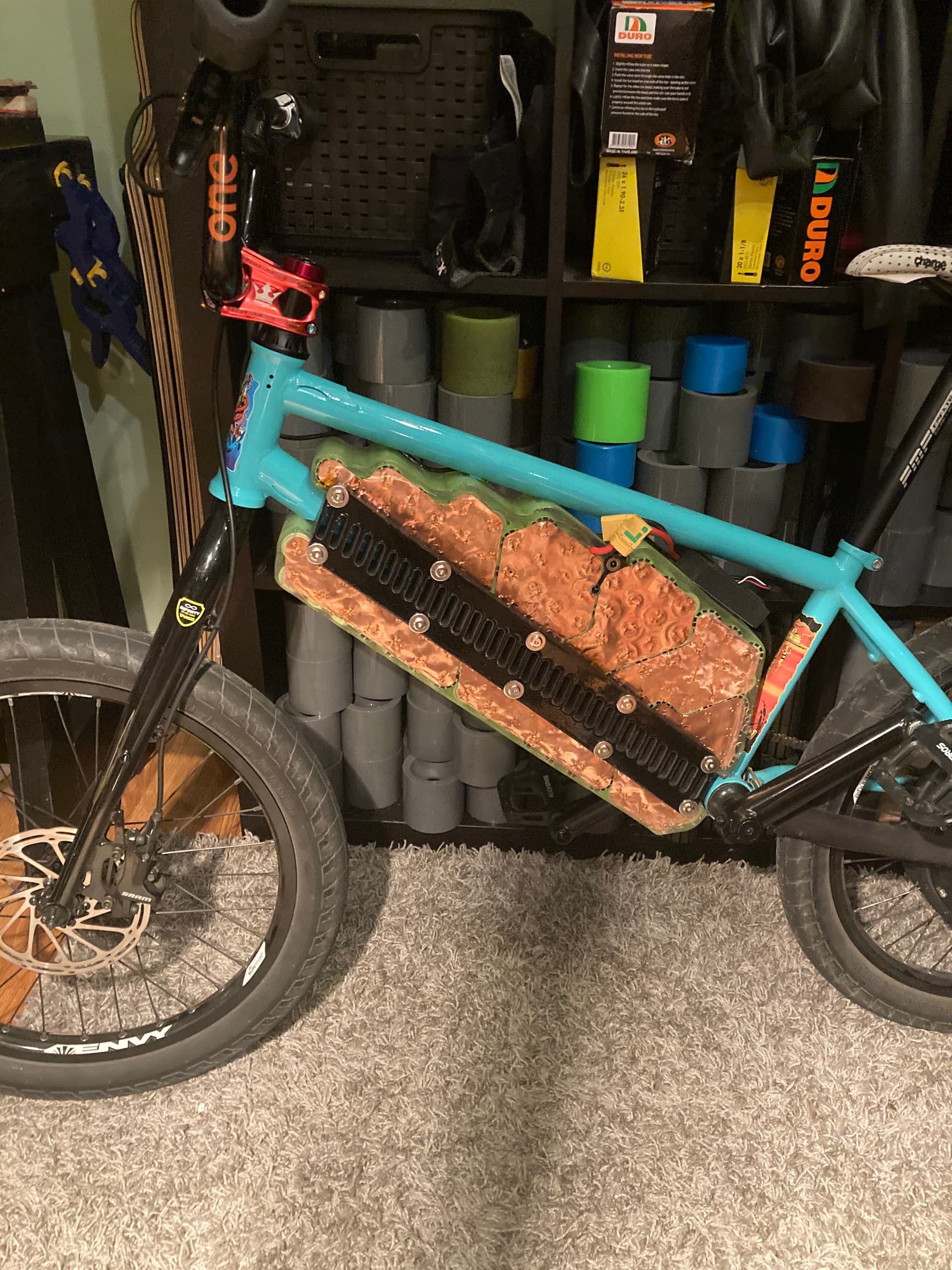

I’m still interested in balancing externally and the active balancers because I’m making another potted battery for this and another similar bike and sinking a bms in there seems a bad idea.
Have no plans for potting any more batteries after this and will use bms.
I would not pot an active balancer in there
Why not passive balancing boards?
Or just a BMS outside the potting?
I don’t want to sink anything else other than the cells again, except next time I’ll be sure to add the balancing wires instead of assuming I can drill through and balance afterwards :man_facepalming:
Then again with the cost of the active balancers being higher than a cheap bms I think I still likely won’t use the active balancers in the end

Are those actual charge voltages? They aren’t divisible by 3.65 or 4.2
I charge to 3.6. Maybe my math is wrong. 50.4…

I wouldn’t use more than 14S LiFePO4 on a VESC6. I don’t know what battery you’re referring to.
I’ll use the same a123s
Yes, but the amount of them you string in series is the important bit.

I read of people going up to like 60v while of course running regen on a board. I figured 56.6 seemed reasonable, although the very low kv maybe adds bigger voltage spikes?
I’m using emoji :smiley:
On what size of pack?
For what pack size?
Yes, but it’s the detail you’ve never mentioned.
I’d be building a battery to fit the same dimensions as my pic above. As it is there it’s 50.4v top charge I do. 14s with lifepo4 a123s
It’s 98 cells, 7 in parallel, at this point, but could reconfigure for the 54v
Yea sorry missed the series number. 14 or maybe move to 15 or even 16
So 50.4 or go to 54, or 57.6. I like 54.
But forget it and too complicated trying to rearrange the cells. 50.4 it stays.
