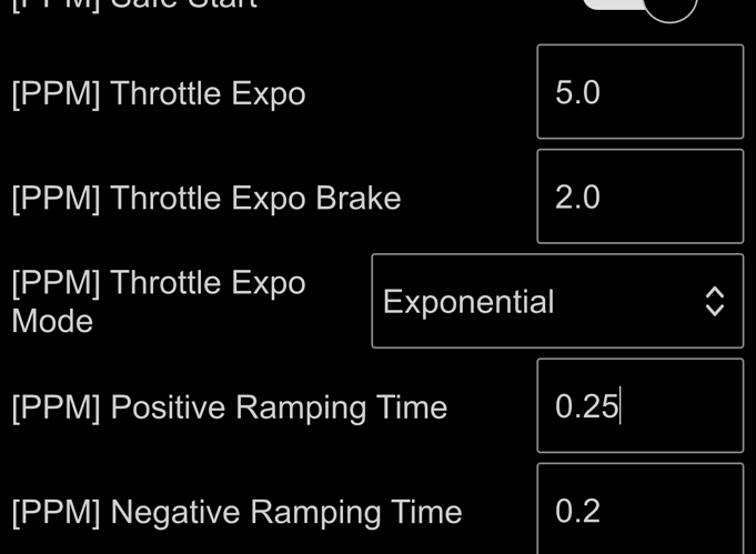

The only thing I need an actual wired connection for is tuning HFI.
Oh I know I’m interjecting
I just am happy that there’s a possibility of actually playing with throttle curve, using metr, without opening my board.

on metr you don’t get a fancy graph, but it lets you just directly input the values and type, makes for much easier on-the-fly tweaking.
poke around Expert mode it’s really good, in some ways better than VT
