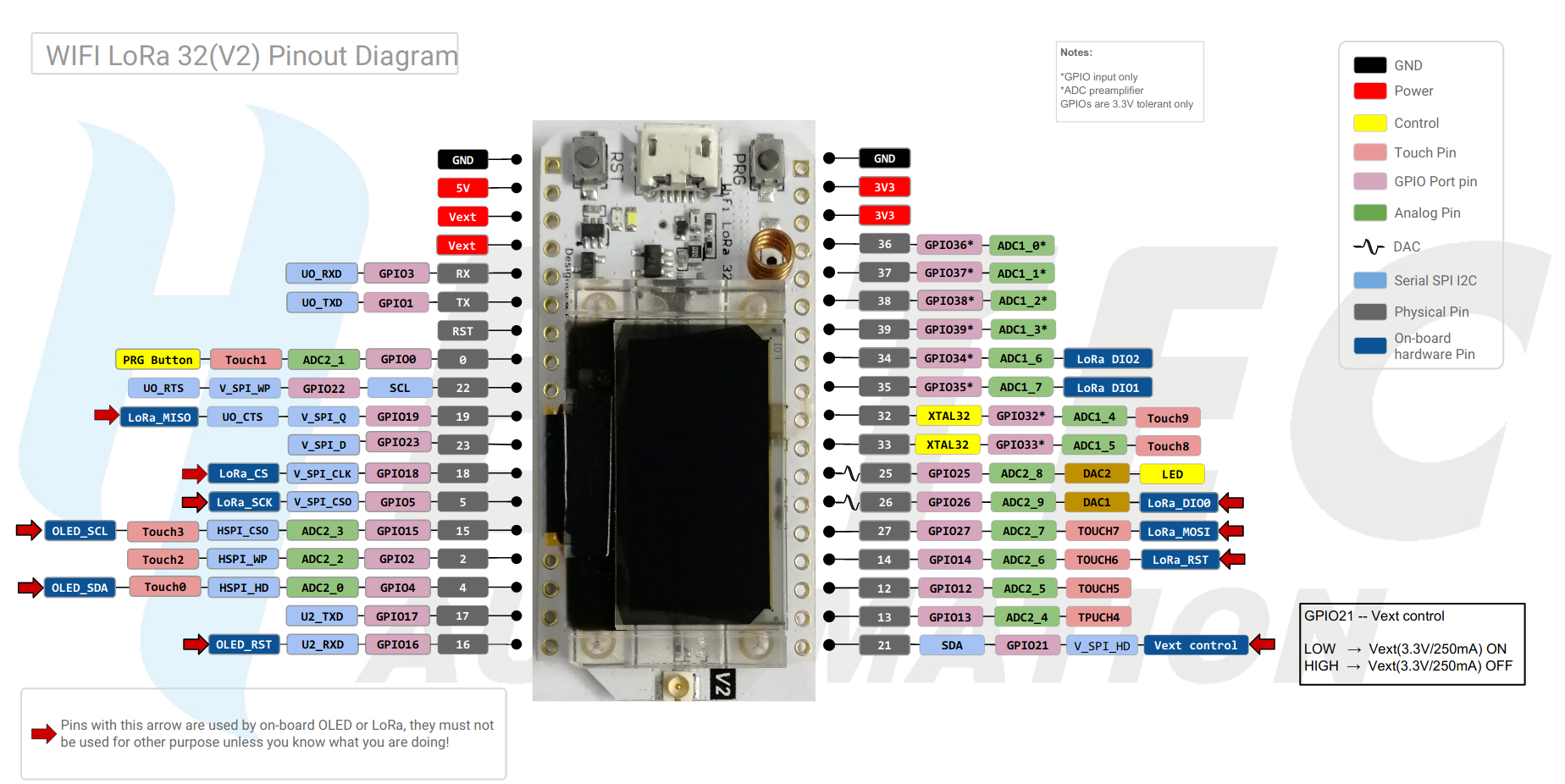

For people familiar with Arduino and maybe even Heltec Lora 32 V2, i cant use my external display somehow… It just stays black…
Heres my code:
https://pastebin.com/ZZiq70g2
Heres the pinout diagram…
I thought i need Pin 18 for SCLK and Pin 23 for MOSI for hardware SPI, the rest should be pickable how one wants.
